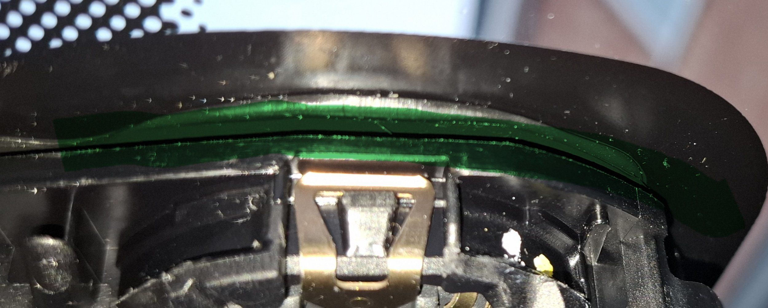

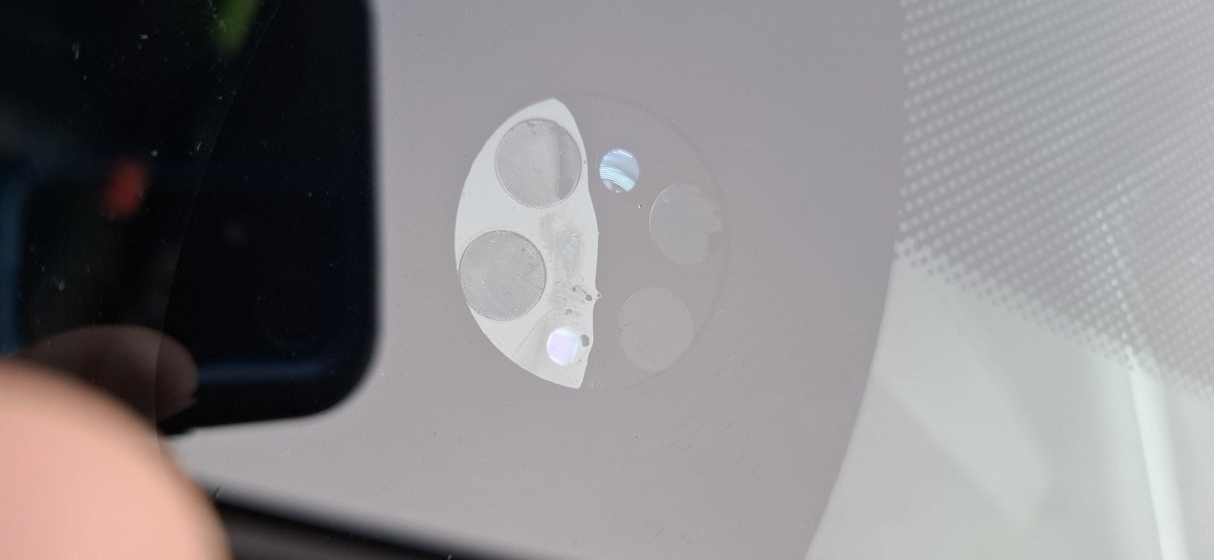

Ok soo further to me asking about rain sensor..... I've pulled the rear view mirror apart and had a look at gel pad that interfaces between the sensor and and glass and one side of the pad is coming off the right hand side has come unstuck so as far as I can work out as the car is going down the road and is bumping up and down the the whole mirror and sensor is moving just slightly enough to make the sensor think it's raining when it's not.
See photos attached
I've highlighted the side where the pad is loose and you can see feom the out side that one side of the pad is light where is coming off and the other side is dark where its still stuck down.
