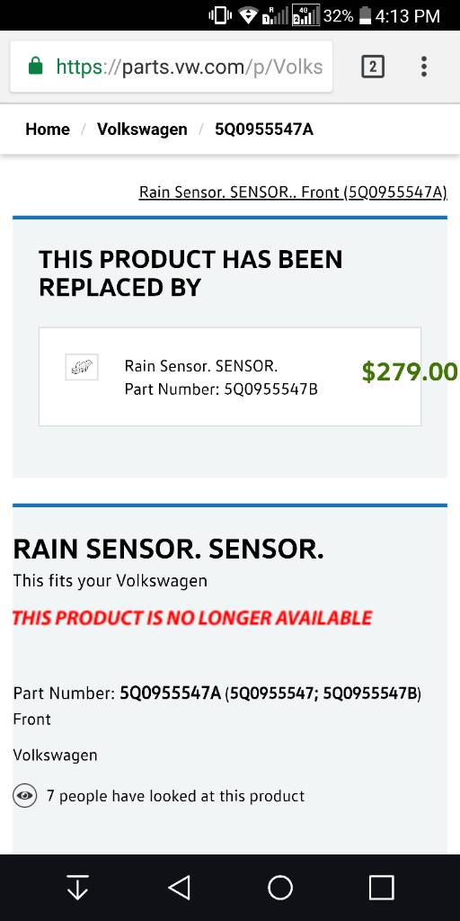

The part numbers I've used are as follows:
Rain/Light Sensor: 5Q0955547A
Link: https://www.ebay.co.uk/itm/VW-Golf-Passat-Polo-Tiguan-Touran-Sharan-Seat-Leon-Skoda-Regensensor-5Q0955547A/112949661345?ssPageName=STRK:MEBIDX:IT&_trksid=p2057872.m2749.l2649
Auto Light Switch (found a genuine SEAT one on ebay Germany): 5G0941431AF
https://www.ebay.co.uk/itm/Seat-Leon-5F-Lichtschalter-Automatisch-Chrom-5G0941431AF-Neuwertig/222910296838?ssPageName=STRK:MEBIDX:IT&_trksid=p2057872.m2749.l2649.

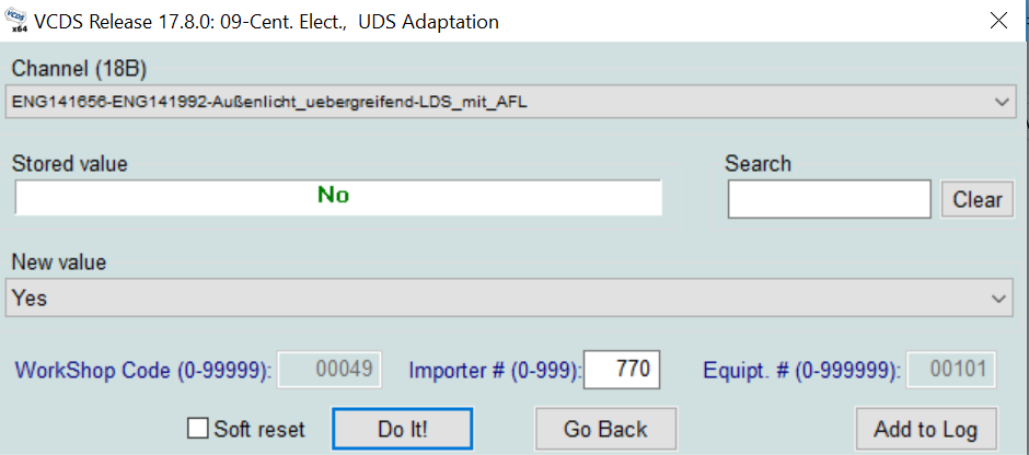

step 1 : activate automatic light switch.
Central Electronics > 10. Security , enter code 31347, Do it!
Go to Adaptation menu now, and from the dropdown select:
ENG141656-ENG141992-Außenlicht_uebergreifend-LDS_mit_AFL, set it to Yes.

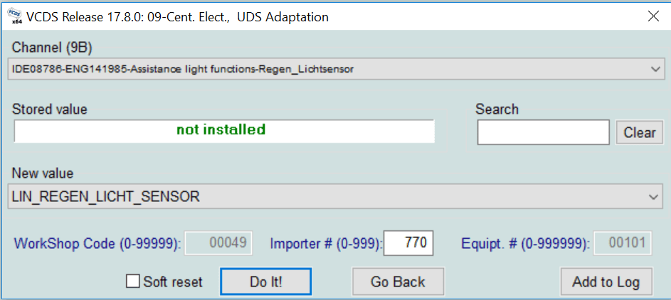

Step 2: Set the Rain-light sensor installed option so that system detects the light sensor
IDE8786-ENG141985-Assistance light functions-Regen_lichtsensor: LIN_REGEN_LICHT_SENSOR
After doing this step, the rain/light sensor will be visible in the Central electronics > coding dropdown.

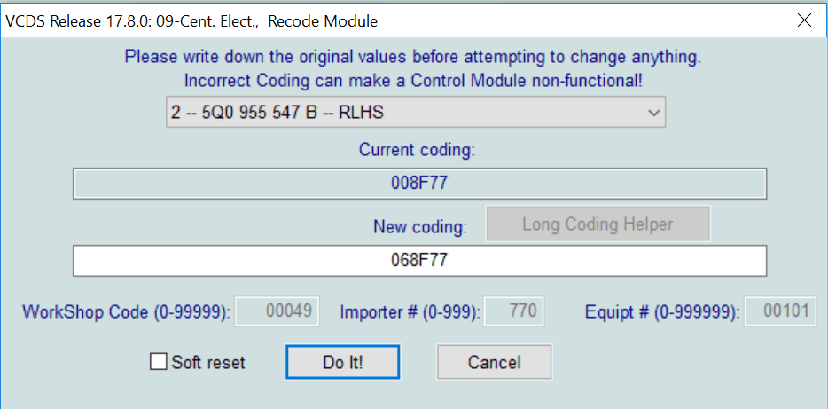

Step 3: Code the Sensor and enable automatic light, rain light etc..
Go to Central Electronics > Coding..
Select the RLHS from dropdown, and click on long coding helper.
You should see the option to enable automatic headlights, automatic light in rain.. do as you require and the automatic lights should be working.. I used 06558D
Now you can also enable Coming Home / Leaving home functions.. The steps are already mentioned in this thread.. so I guess no need to repeat that. its the same.

If the auto wiper and lights are working, it confirms that the sensor is installed correctly. I also struggled with this and after a lot of tweaking around, I found that after doing this step:
the sensor appeared in the central electronics.
I have screenshots of each step I performed on my other computer, will post shortly. I also have screenshots for coming and leaving home. I remember, coming home was straightforward, however leaving home needed some trickery.

No, sorry my MY18 leon without convenience pack has the sensor 81A907658, but the MY17 leon with the convenience pack has the sensor 5Q0955547B.
This is interesting as others on this thread suggested that 5Q0955547A was required.
5Q0955547B is the replacement of 5Q0955547A. They are the same.
