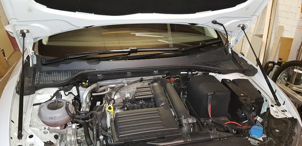

Made a nice job there!
Can't help noticing that your struts are the other way up to the Russin kit, I'm sure i was told once that the body should be up with the shaft below so it lubricates it.
Also not that it should matter the fixing on your brackets is on the inside not the outside.

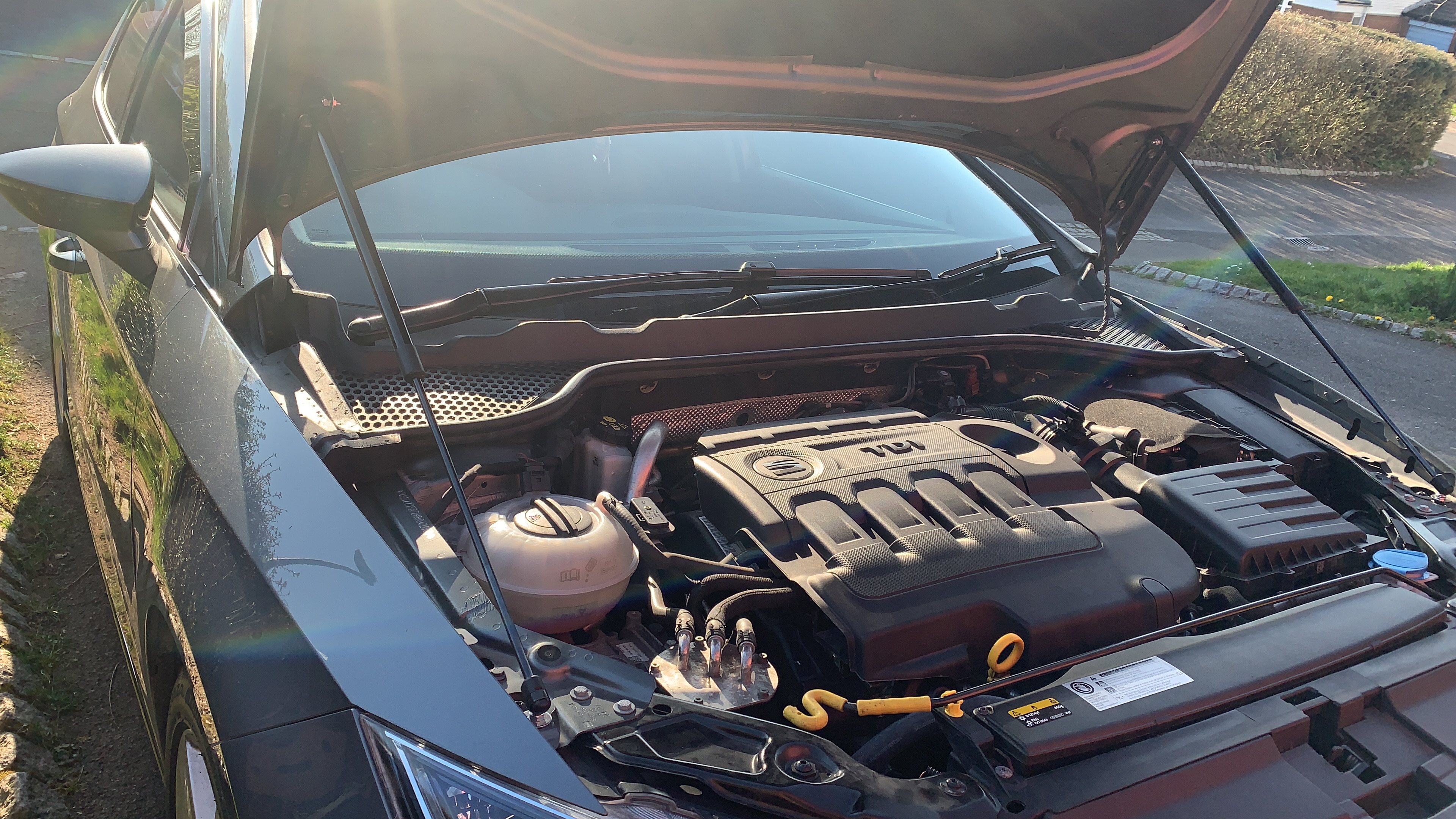

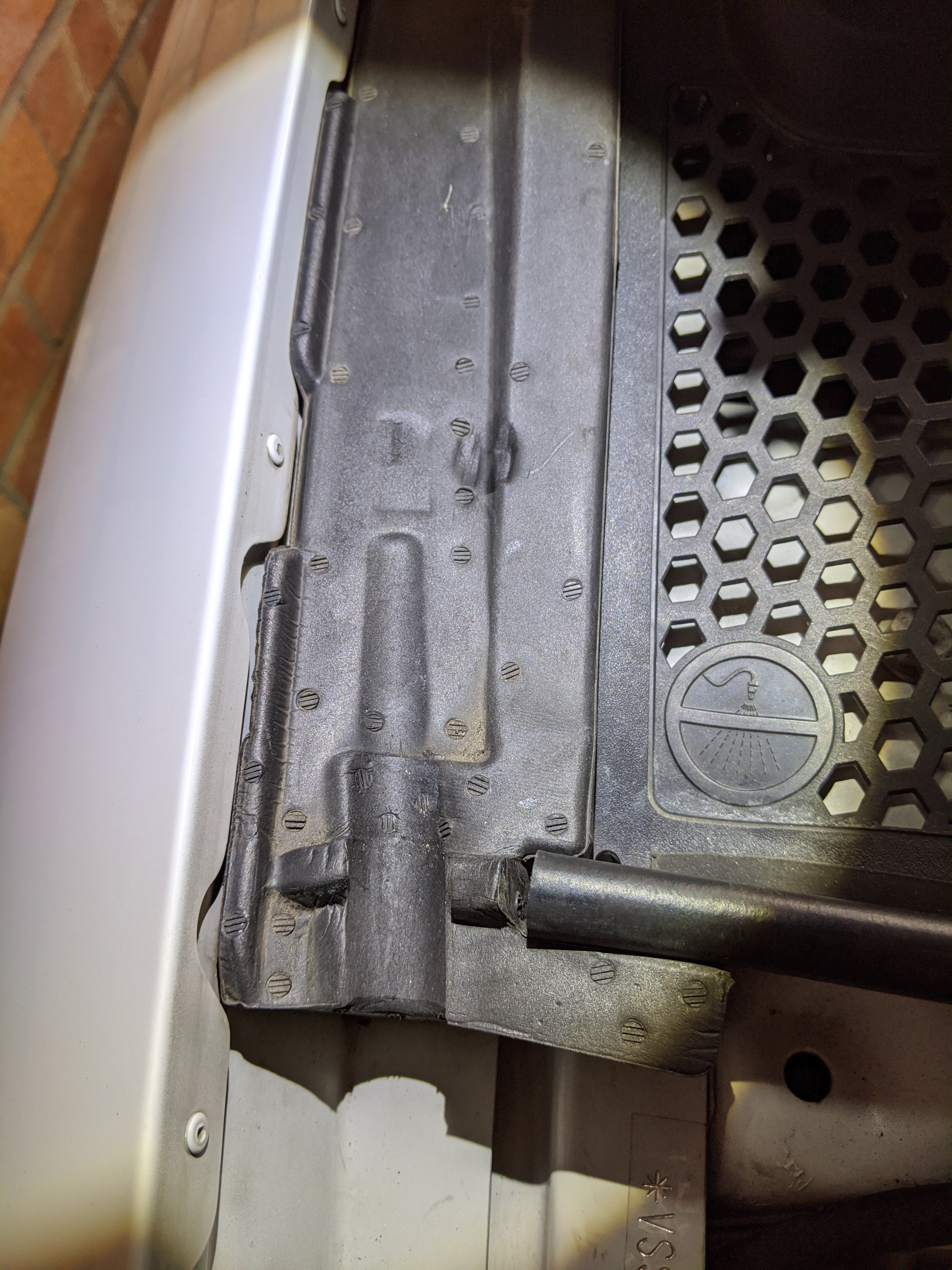

I fitted the Russin kit over a year ago now and trimmed the part of the foam nearer the front of the car and the strut has moulded this quite nicely now.
But I have issues, more one side than the other with the brackets twisiting. It looks like the strut body higher up and the bracket push in to the foam and the pressure turns the bracket, no matter how tight i do the bonnet nuts up... and i mean tight!
You can see the imprint in my photos...

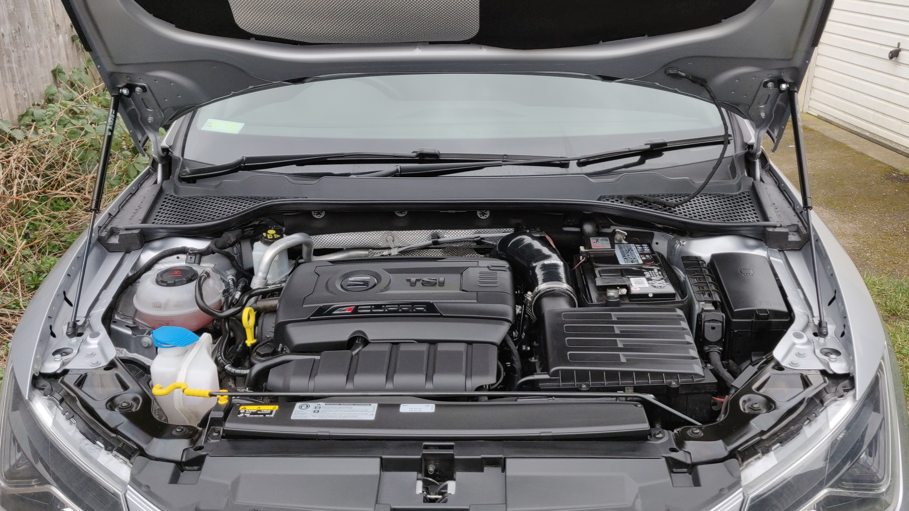

A simple mod which I always enjoy when I (infrequently) open the bonnet! I cut the foam, to easy not to do.

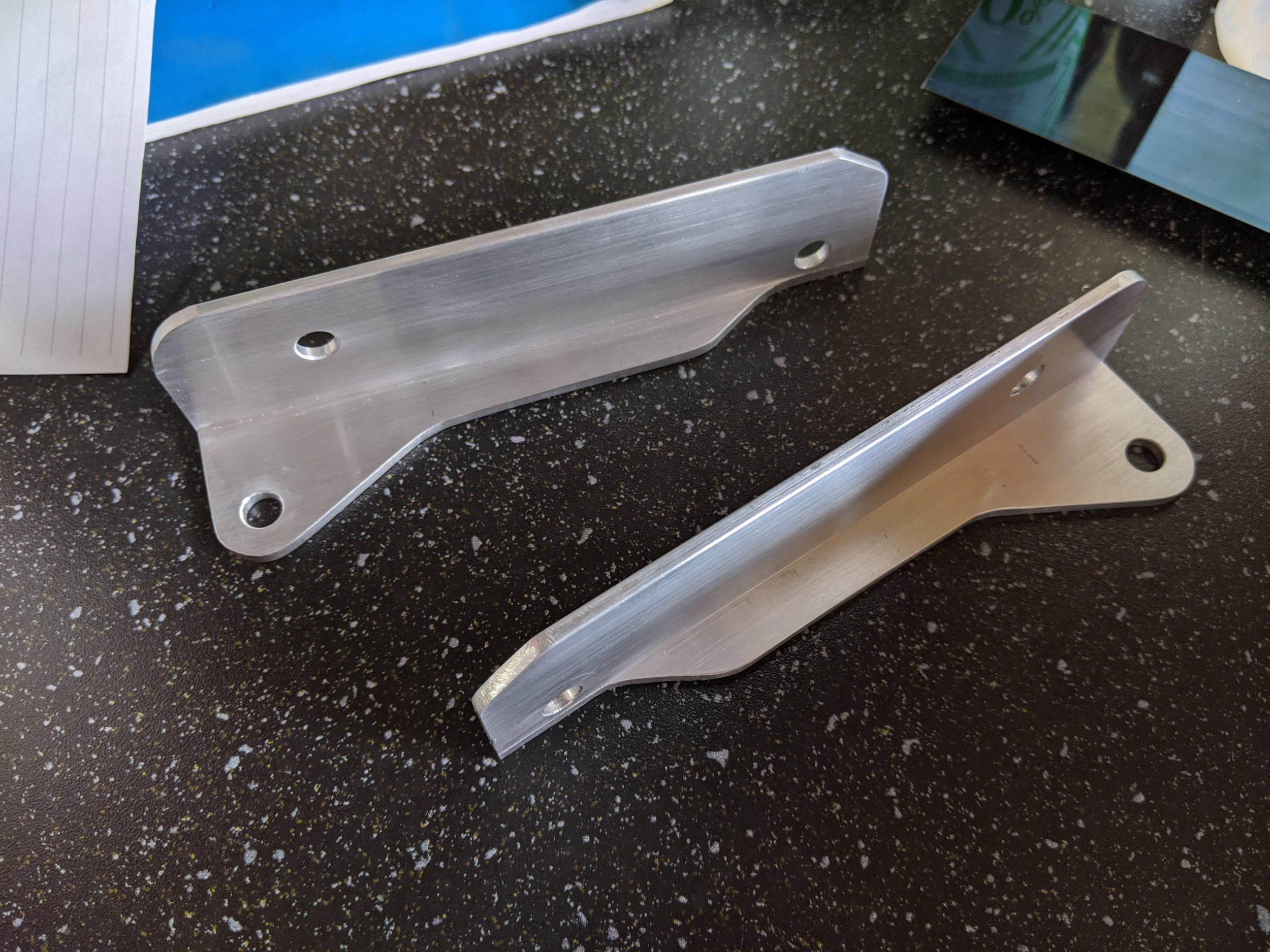

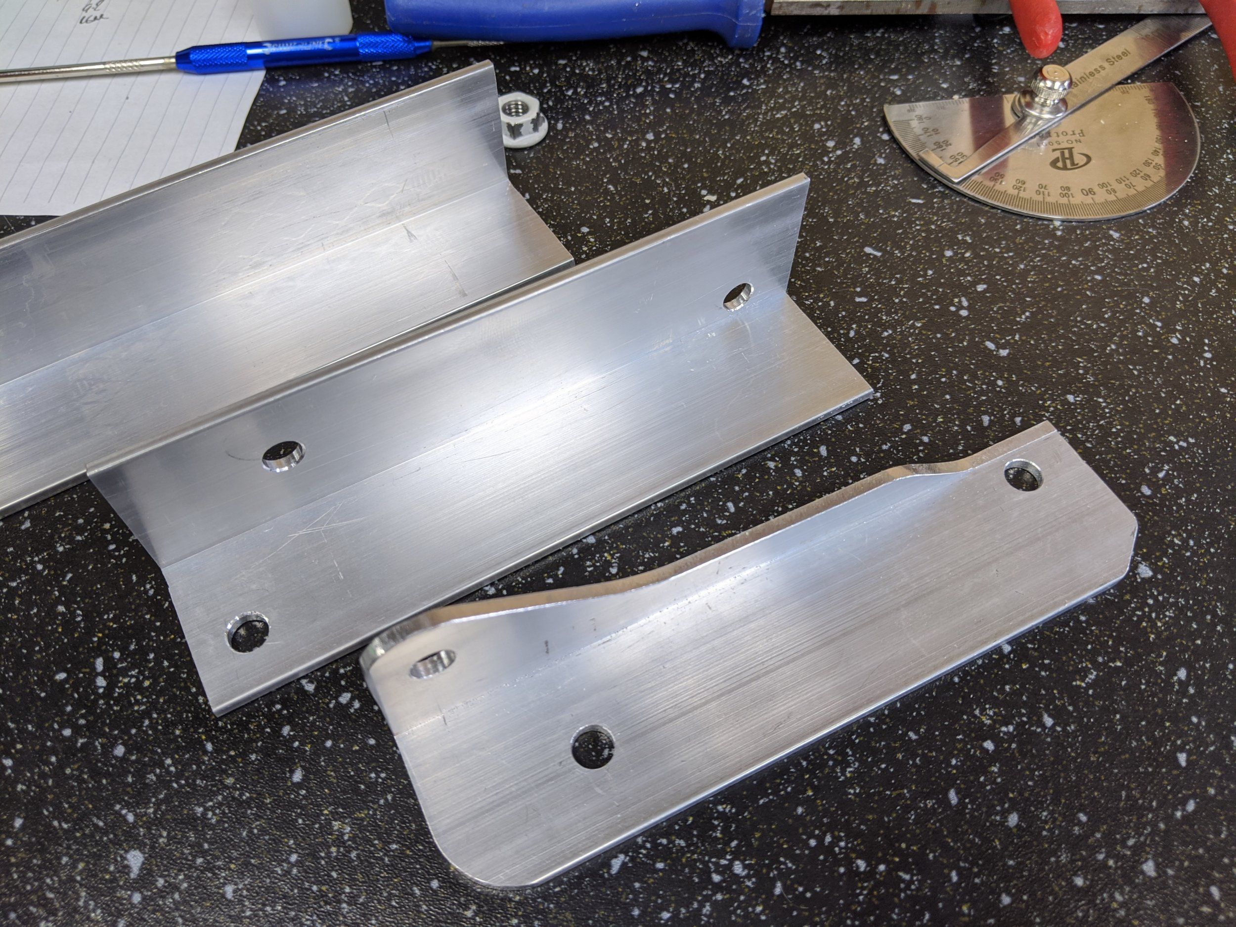

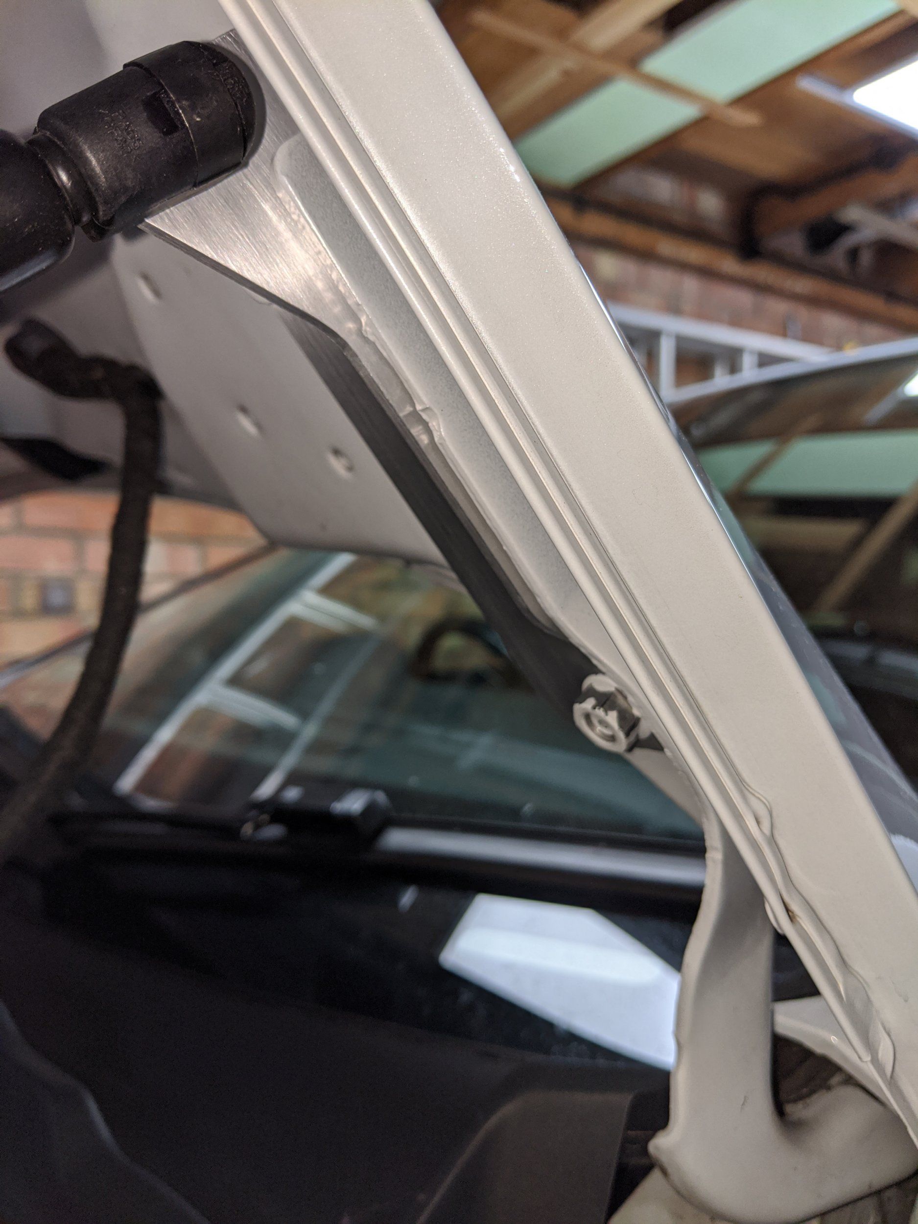

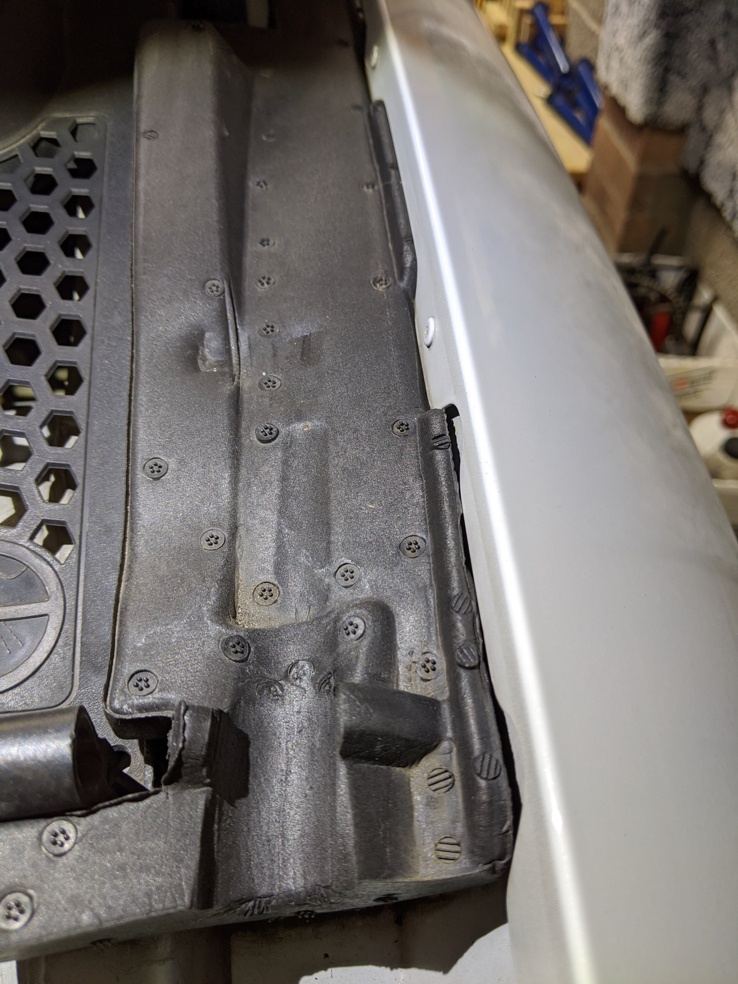

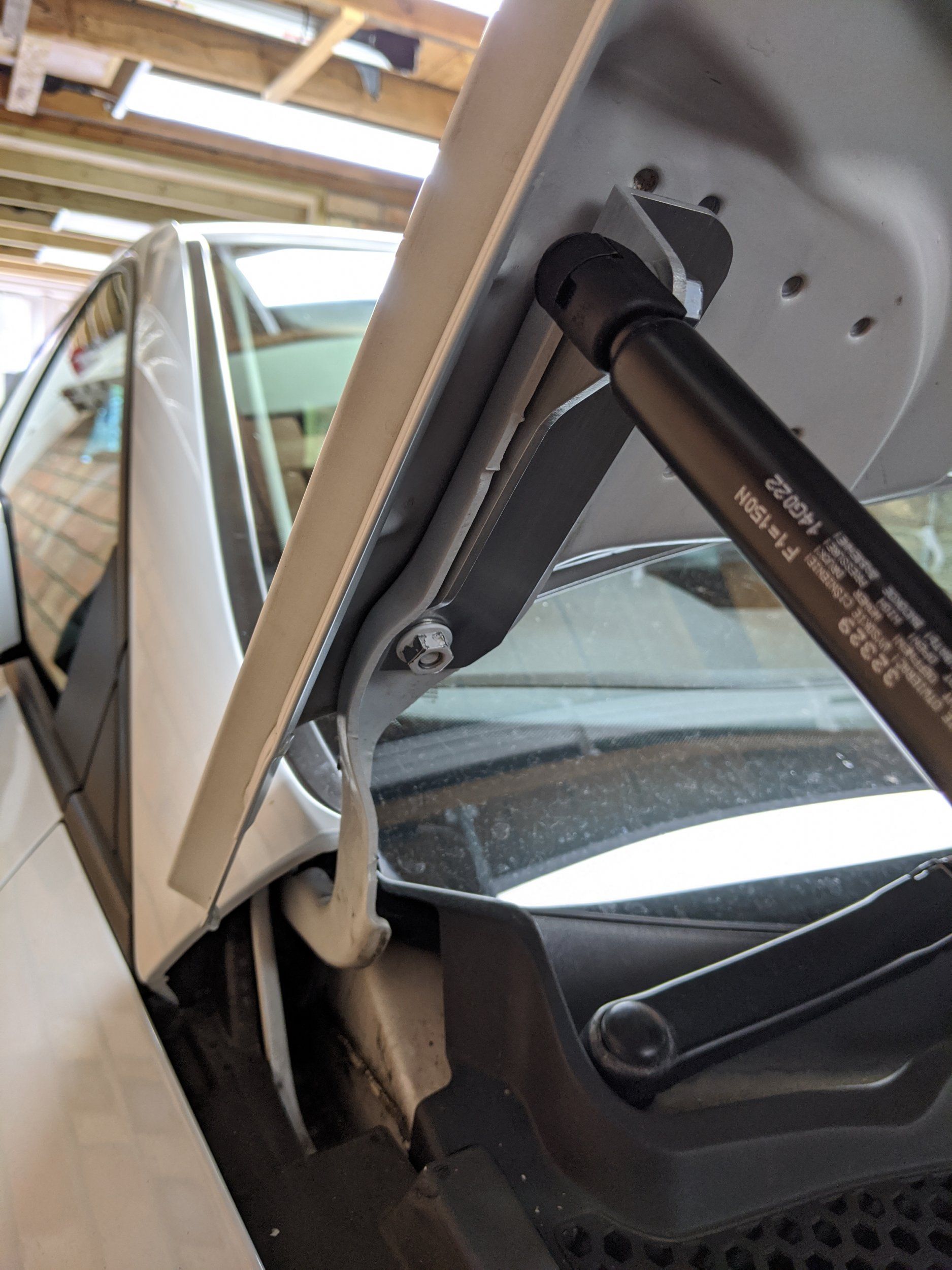

Update on mine. Got so fed up with the brackets in the Russian kit twisting, even when using double sided tape in addition....
So I got myself some aluminium angle, made some holes, hacksaw and file....these will not move. Took me back to my apprentice days.
Here is some close pictures so you can see clearly...
It's nice when you have tools and place to work :)
Mine have no problems, couple of years since installed. Maybe it depends on how much one drives/opens the bonnet.
