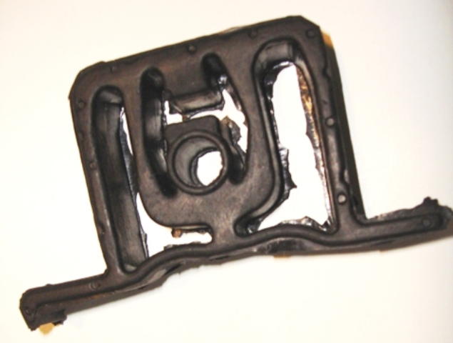

The exhaust hangers are quite specialist in all honesty. You'll need 1 universal powerflex one, where the exhaust bends up over the rear beam.
The centre section mount/hangers are built into the bracket, (2 of the item shown below)
and the one furthest back (under the back bumper) is like a V-shape, where it has 2 mounting points on the chassis, coming down to one mounting point for the exhaust hanger.
rear one:

just added pics dude, you'll see what I mean.
Yeah you can change the middle ones, they're bolted into the bracket, but i dunno if you'll find anything other than OE spec ones.
The one you will easily be able to swap is the one where it goes over the rear beam. You'll notice it's a pretty standard shaped one
