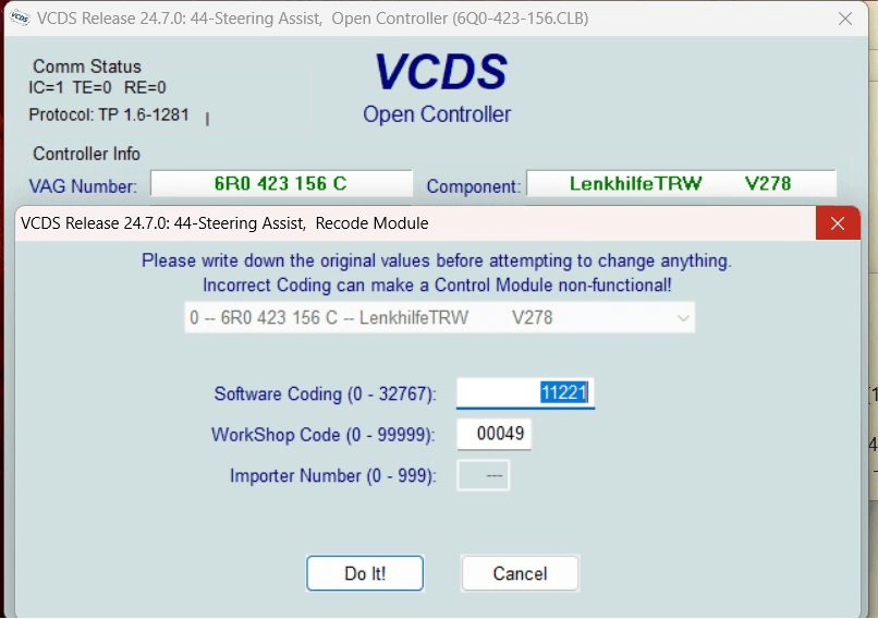

We have not coded the new pump, but google suggests that the PAS should still work but a light remain on the dash?
