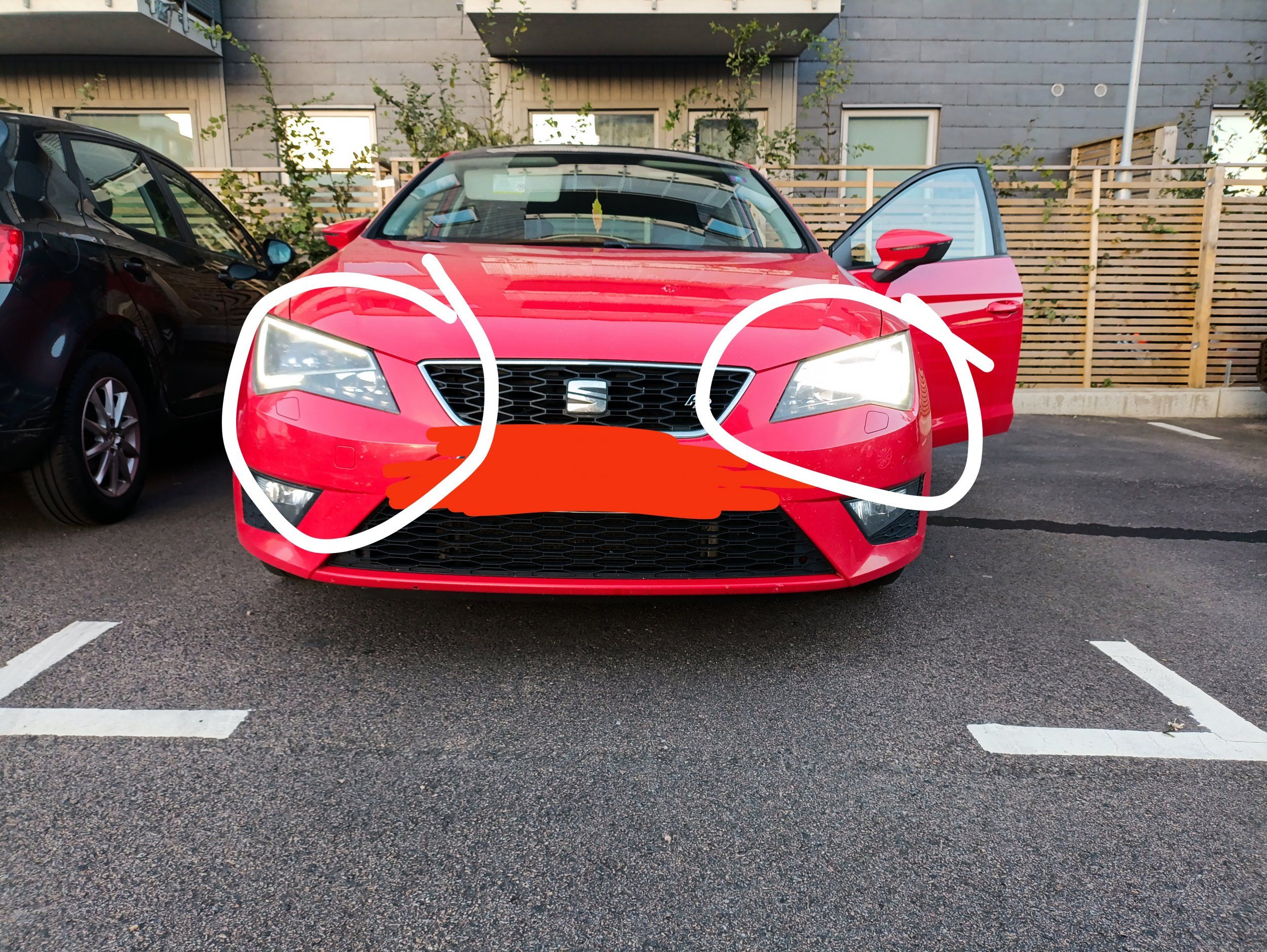

Hi guys,
Please can anyone help me with this one ... What should i do to do it right like the left side .... I dont want it with headlights on ... Can anyone help me please guys...
I would really appreciate some help...

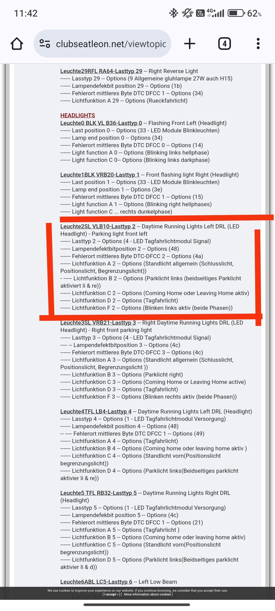

I dont know if it' this one I have to change ... Because it only appear when I turn off the auto lights and then when I turn the light to parking lights that's when the headlight turn on on the drivers side ...
tracktoy
Jun 11, 2023
576
394
OK They all match up to my settings but there are other settings in Leuchte2SL VLB10 can you share all the settings and can you also share the settings for the headlight that comes on (is it the dipped beam or full beam) as you may have made a change there.

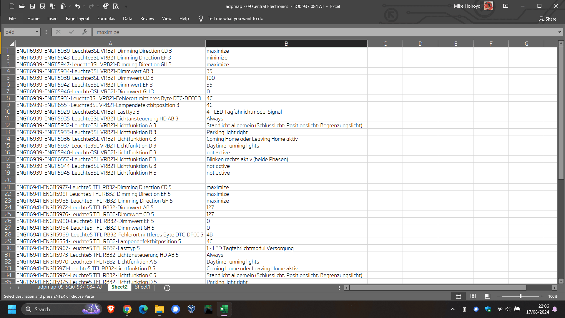

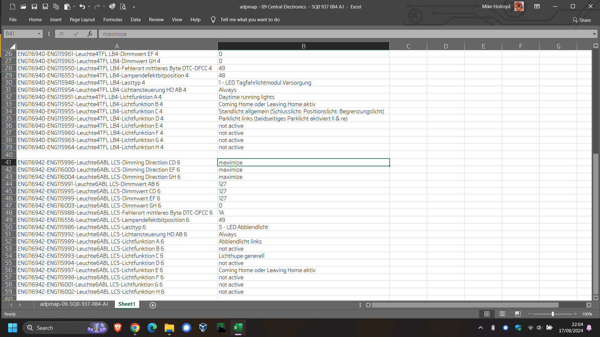

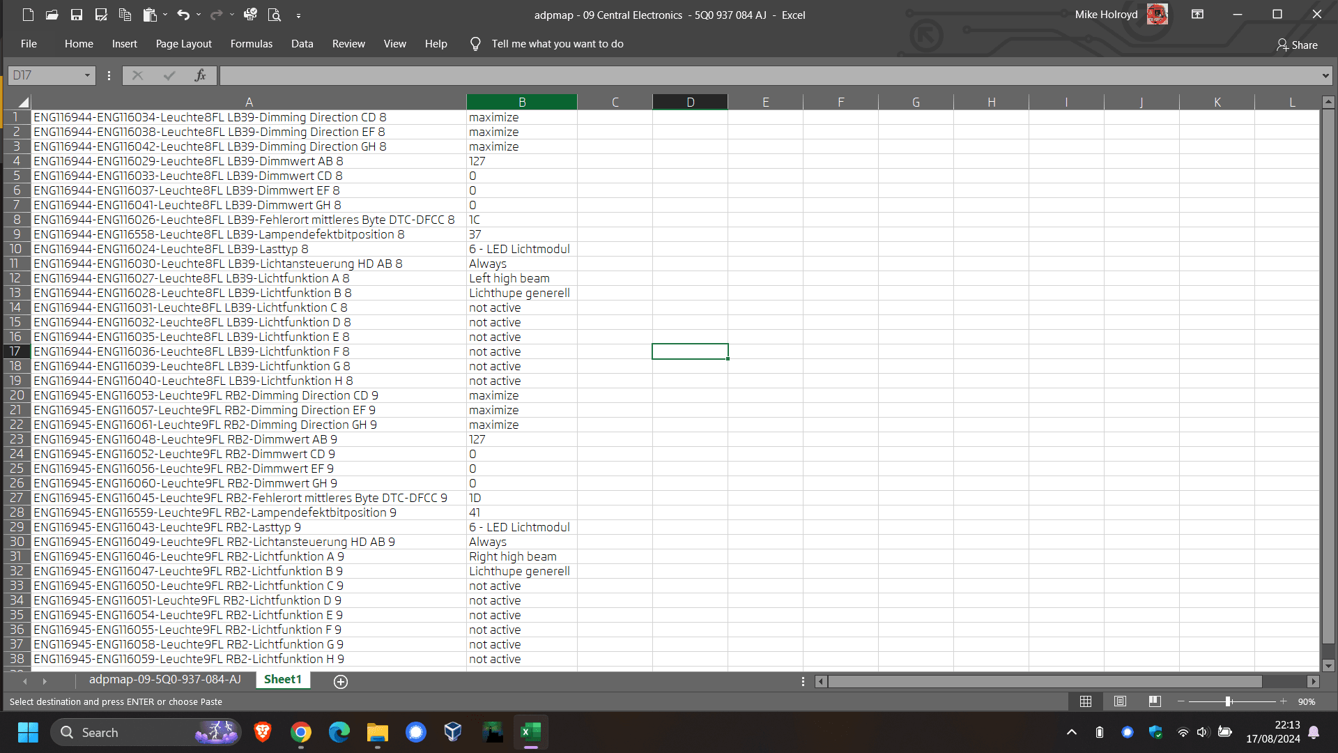

LeylandVCDS
Apr 20, 2015
390
229
Leyland, Lancashire
Here is an relevant adaptation map of the 09 control unit for a Leon with factory LED headlights and DRLs. Compare the values of the lighting to yours, and change accordingly. This adaptation map is factory accurate so if you match these values you should get things as they should be again
Leuchte 2 and 4 are the left DRL channels
Leuchte 6 is the left dipped headlight
Leuchte 8 is the left main beam headlight
Leuchte 3 and 5 are the right DRL channels
Leuchte 7 is the right dipped beam headlight
Leuchte 9 is the right main beam headlight
