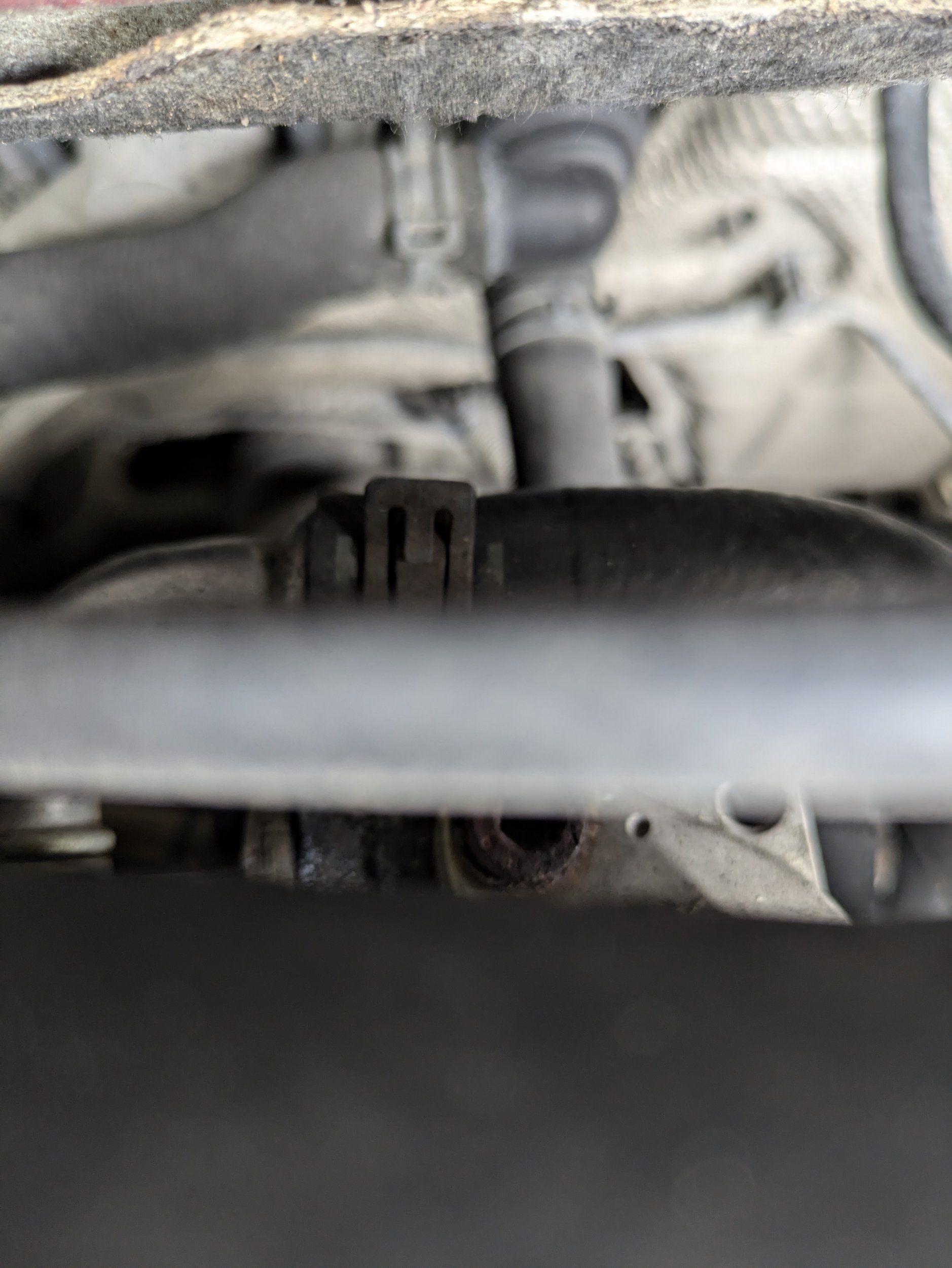

My Leon 1.9 (built July 2009) has started overheating. Also losing coolant. But I can't for the life of me see where it's going. No water inside. No sign of leaks around the water pump or radiator.
I know overheating has been covered numerous times.

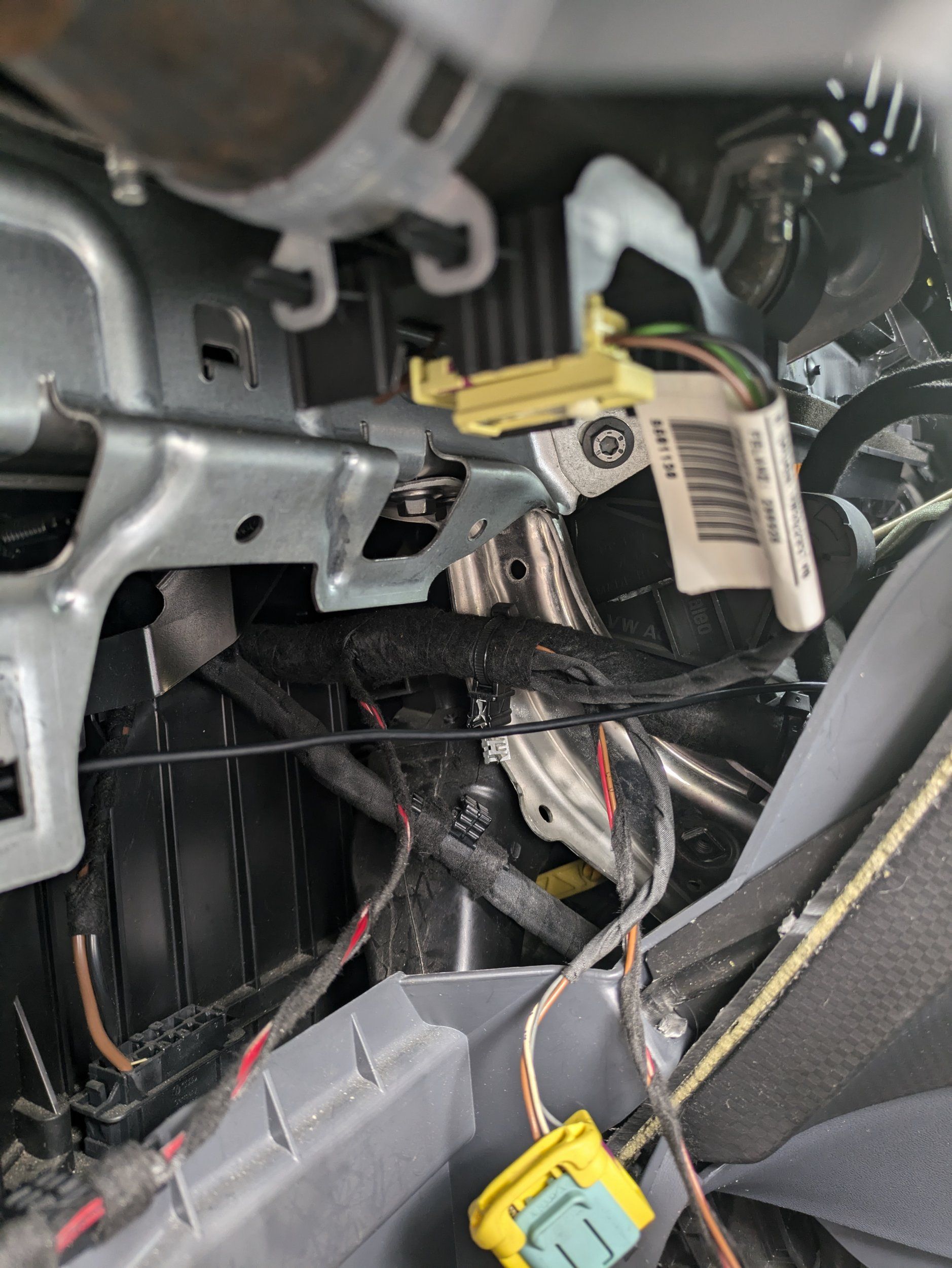

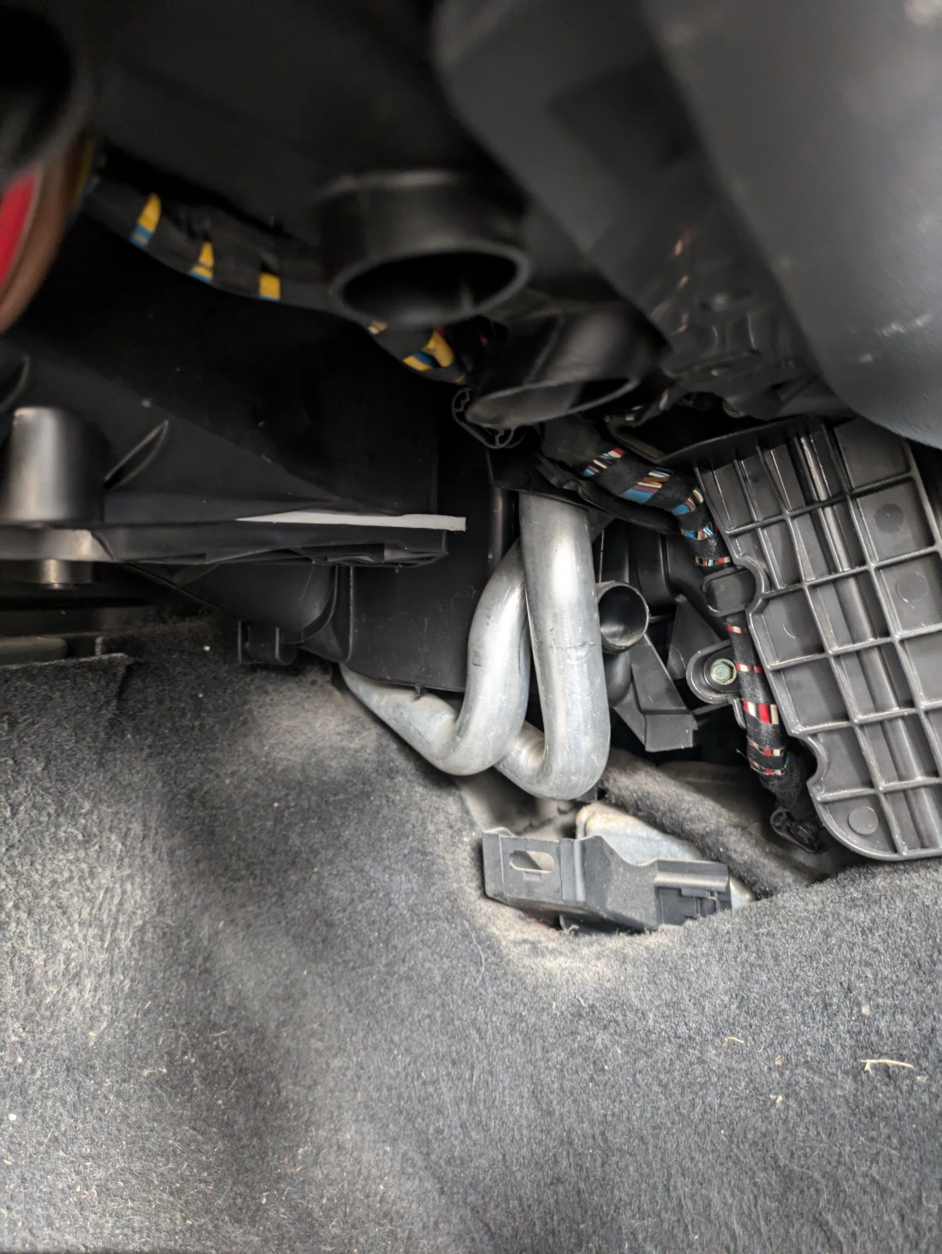

But no matter how I phrase my searches. All videos showing how to flush heater matrix in situ . Or removing the matrix by removing the glovebox look different to mine.
In the engine bay there is a large breather pipe which goes from the bottom of the engine through the MAF sensor (bottom of photo). It won't budge enough to allow me to reach the inlet and outlet pipes.
As for going through the glovebox. Access is just about impossible in comparison to any video I have watched. If it makes any difference, mine is the BXE engine.
