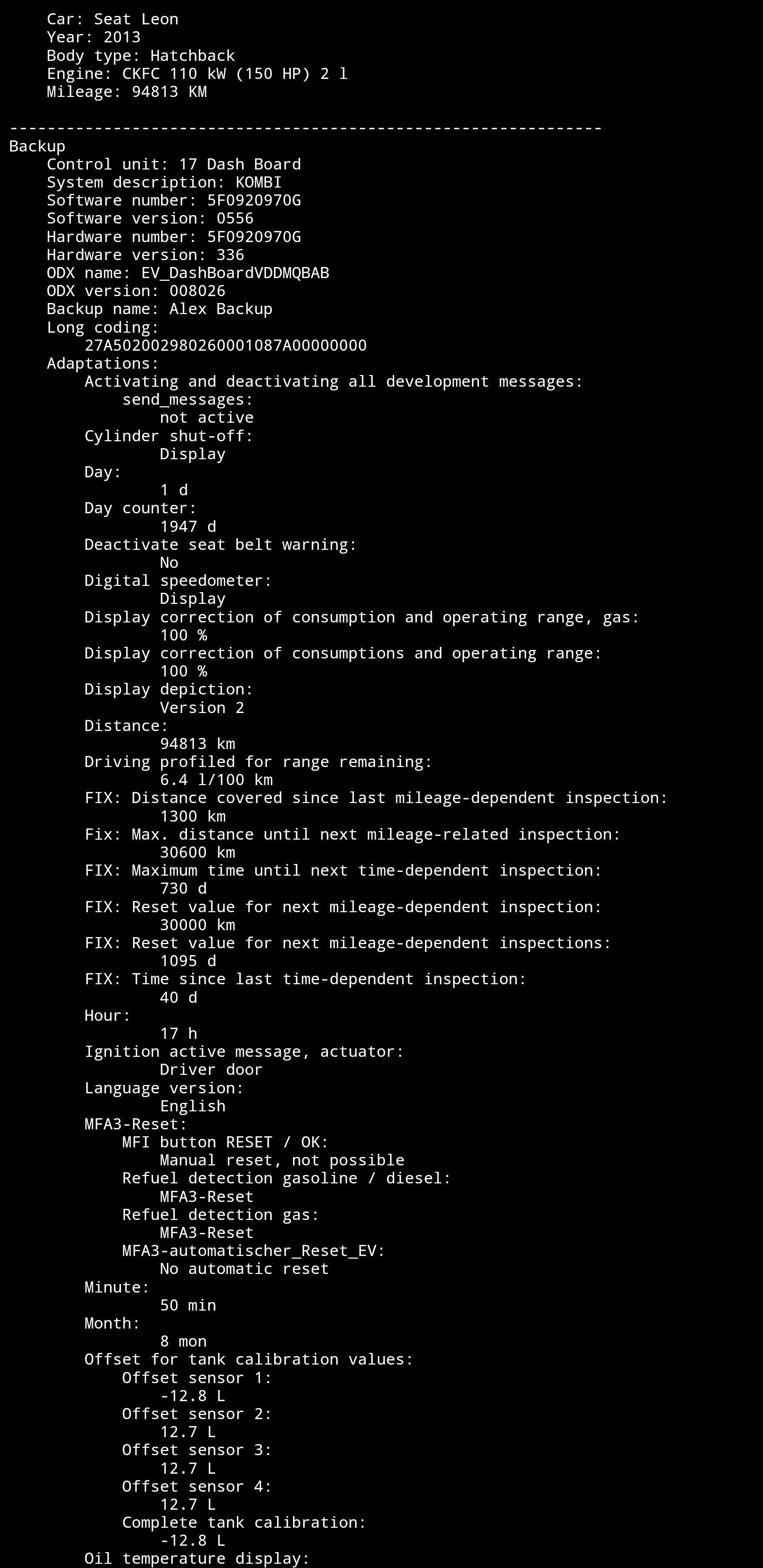

Works on my 2014 car but I have had a couple guys with 2013 cars where the normal pre facelift coding does not work, if you are feeling generous can you put up a copy of your Control Unit 17 and I will do a compare to mine to see if there is anything obviously different.

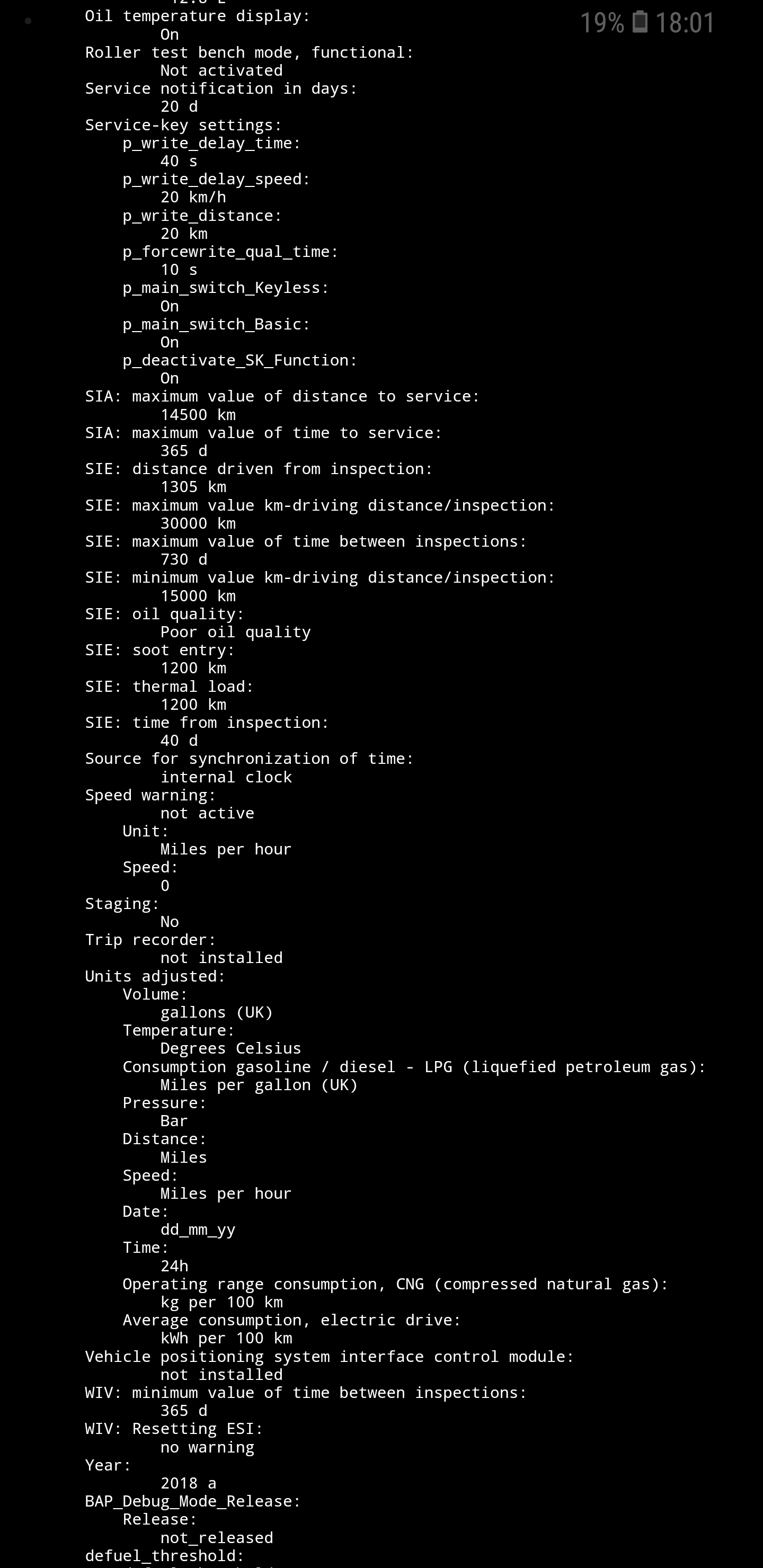

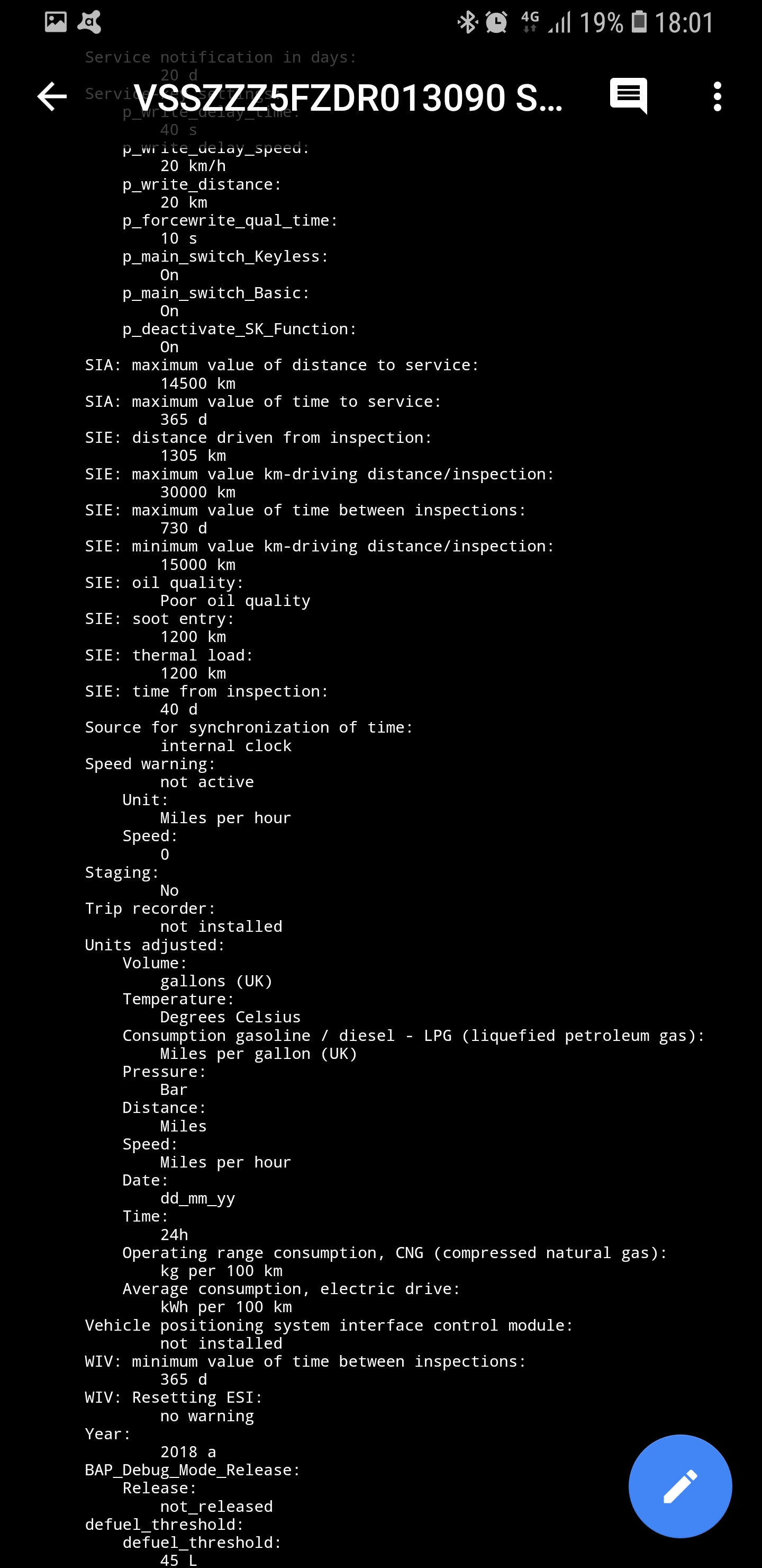

apr95 I will have a look at your posting this week and see if anything obvious. my initial thoughts are that your Firmware version does not support the background so even though you have correctly set it there is nothing for it to show.
That's the diagnosis that I've come to as it's the 2018 a build.
Many thanks for your help
