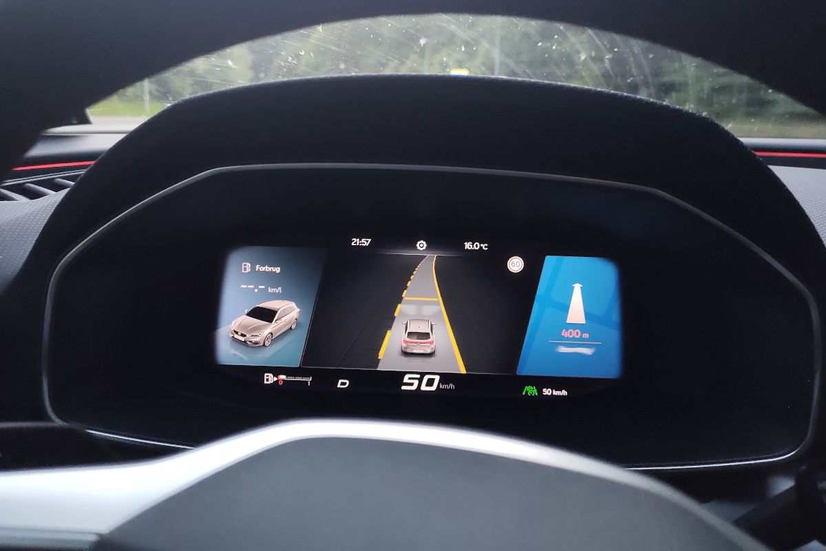

Hey again , a friend came to enable the cupra dash for his new Leon so I wanted to update that this is indeed a bonnet up mod.Well done.
View button on the car ?. Also was that a bonnet up mod. I think they all are with SFD now.
For the cupra dash you dont need to go into long coding just adaptations and select them allHi Everyone,

Cupra Display:
Module 17 (Dashboard) -> Long Coding -> View Activation -> Set All 16 Views to active -> Write To Car

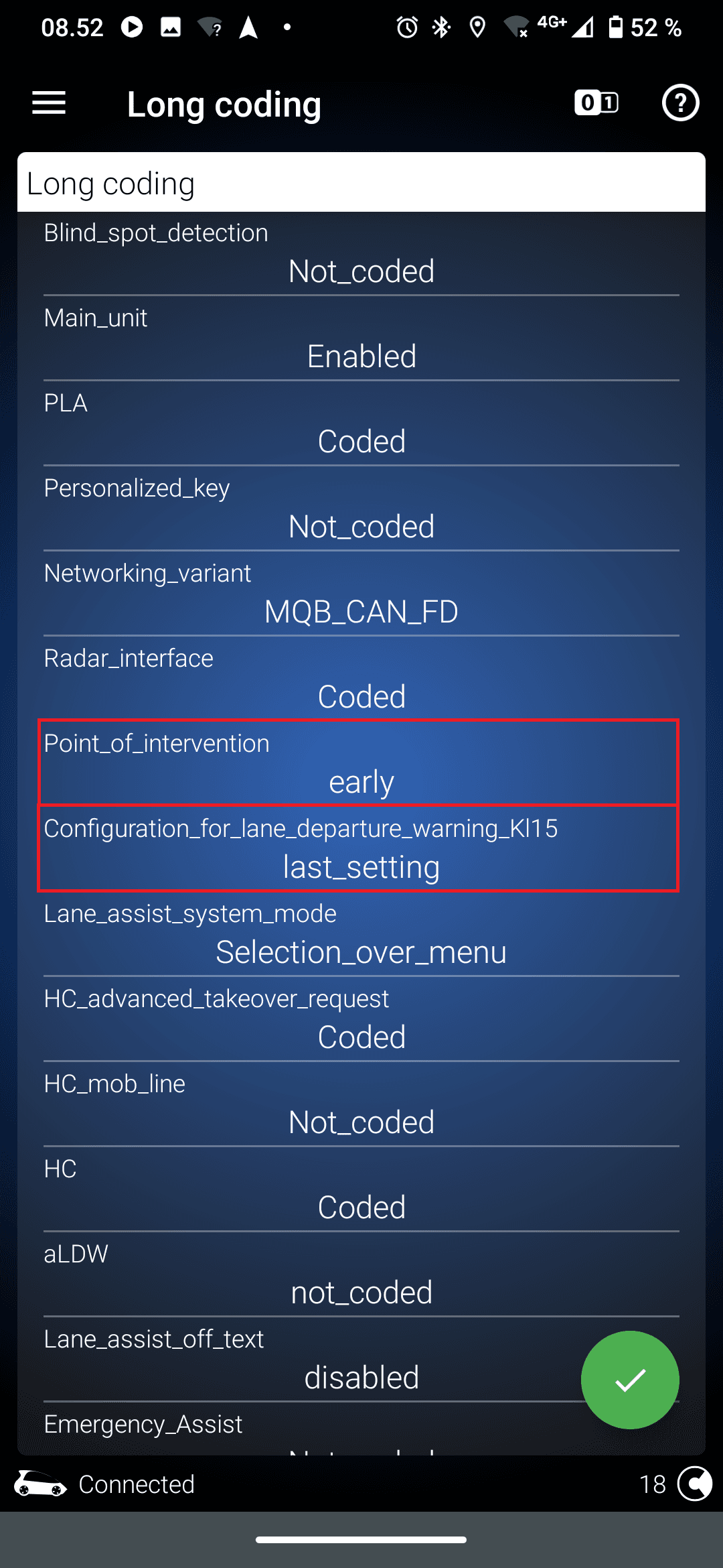

Lane Assist Point Of Intervention:
Module A5 (Driver Assistance) -> Long Coding -> Point Of Intervention -> Set To Early -> Write To Car
Lane Assist Warnings:
Module A5 (Driver Assistance) -> Long Coding -> Lane Assist Off Text -> Set To Disabled -> Write To Car
Lane Assist Settings:
Module A5 (Driver Assistance) -> Long Coding -> Configuration For Lane Departure Warning K15 -> Set To Last Setting -> Write To Car

Hi,So I finally made it , I was Long pressing the view button not the ok button dah
I feel stupid

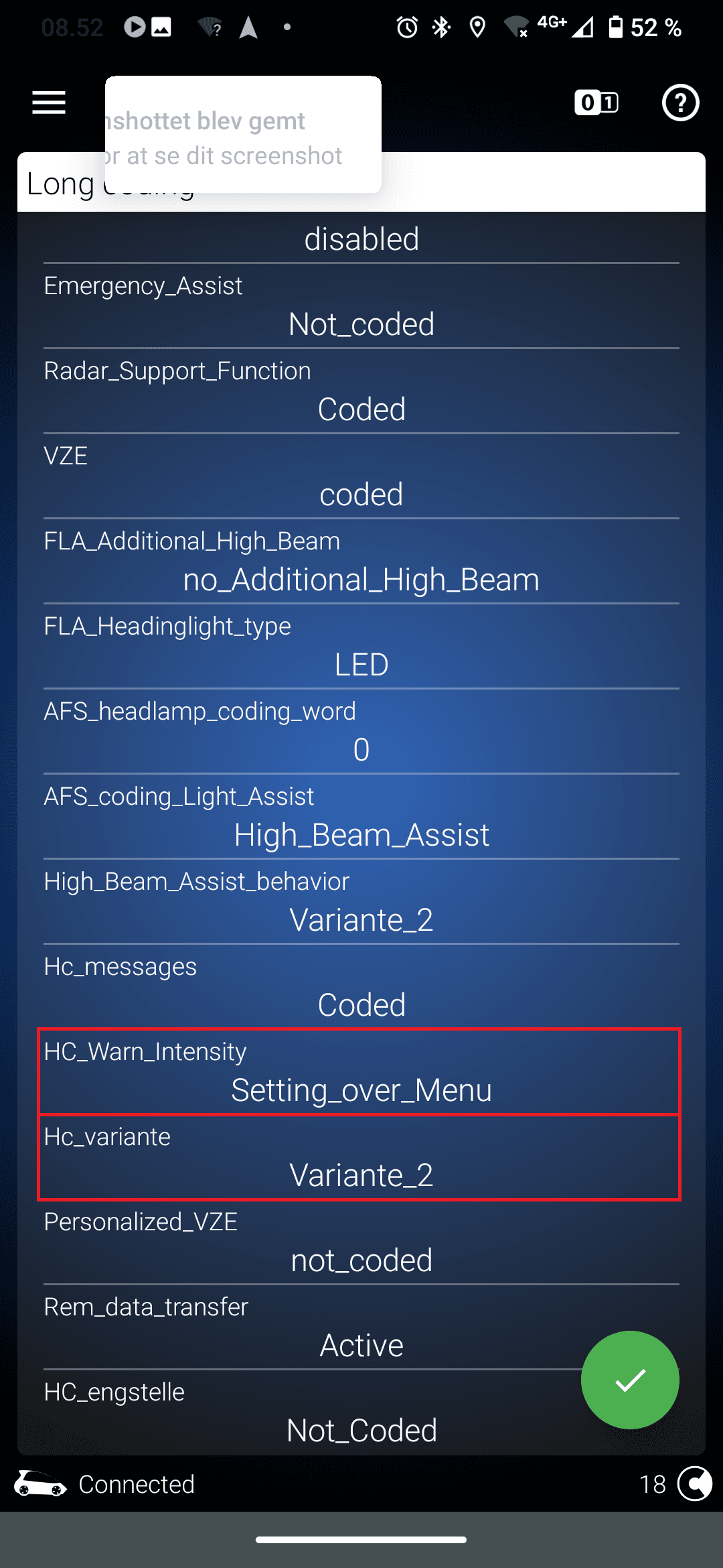

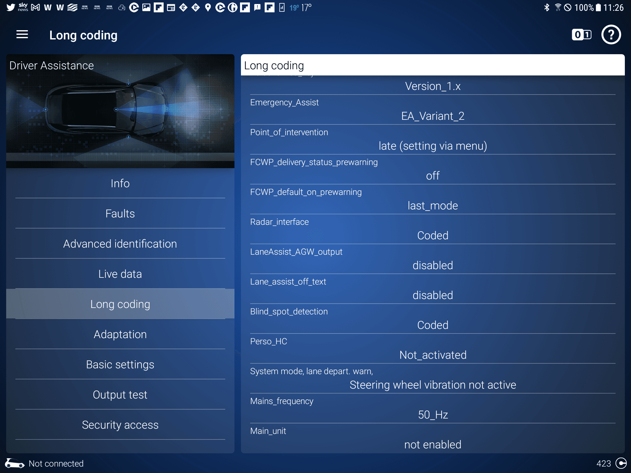

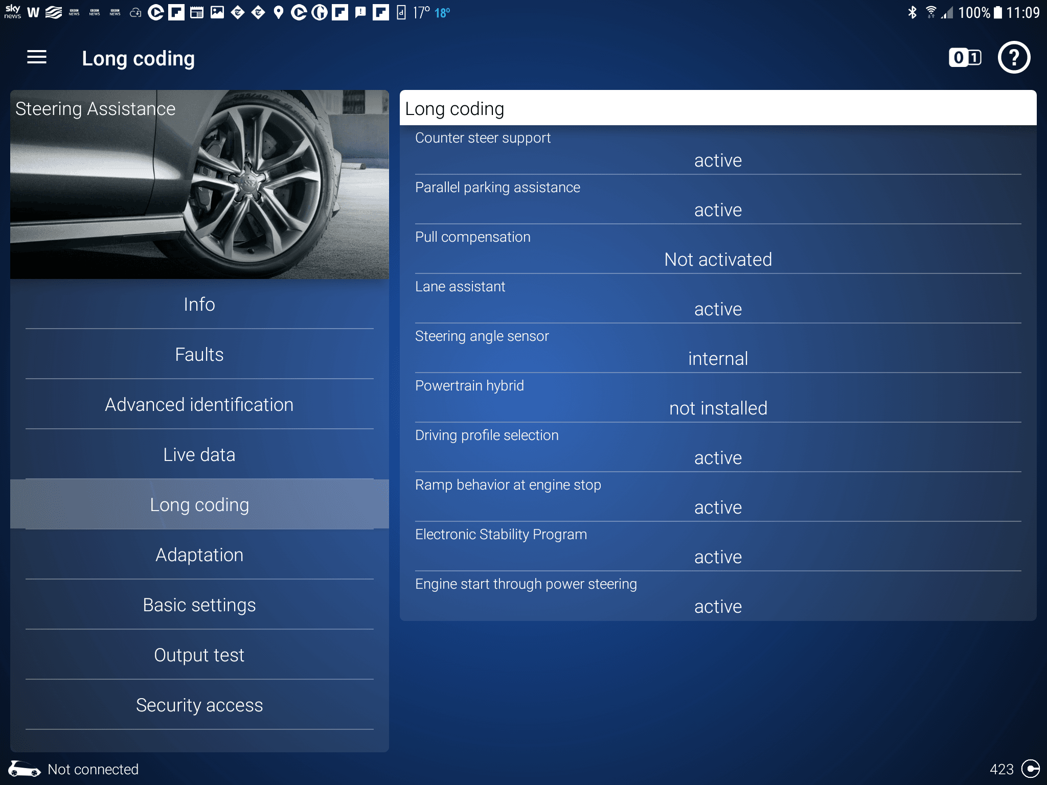

It's possible to turn off the persistence side of lane assist with the Obdeleven Pro on the 2020s. I said that early up... it's the "Perso_HC" parameter. Confirmed by someone with a Leon 4... I didn't imagine that, why Tommy is doing other things with lane assist since the A5 module is not locked downI am new to OBDEleven and am about to purchase. The thing that makes it essential is the cursed Lane Assist on my March 2021 Leon - I think it is actively dangerous and I really need to get this to default to OFF at engine restart. Is this still possible please?
The other thing I am interested in is Drive Profile. The brochure page I relied on at purchase, showed that this was standard on the Xcellence trim and I liked that as I had had it on previous cars. (This was a brochure error for which Seat has compensated me financially). Does anyone know if it's possible to enable this? (Seat Leon Mk4 1.5TSi 150 Xcellence Estate)
SEAT Drive Profile:
/ Four different modes (Normal-Sport-Eco-Individual)
/ Steering response
/ Throttle response
/ Gear shifts mode (only DSG models)

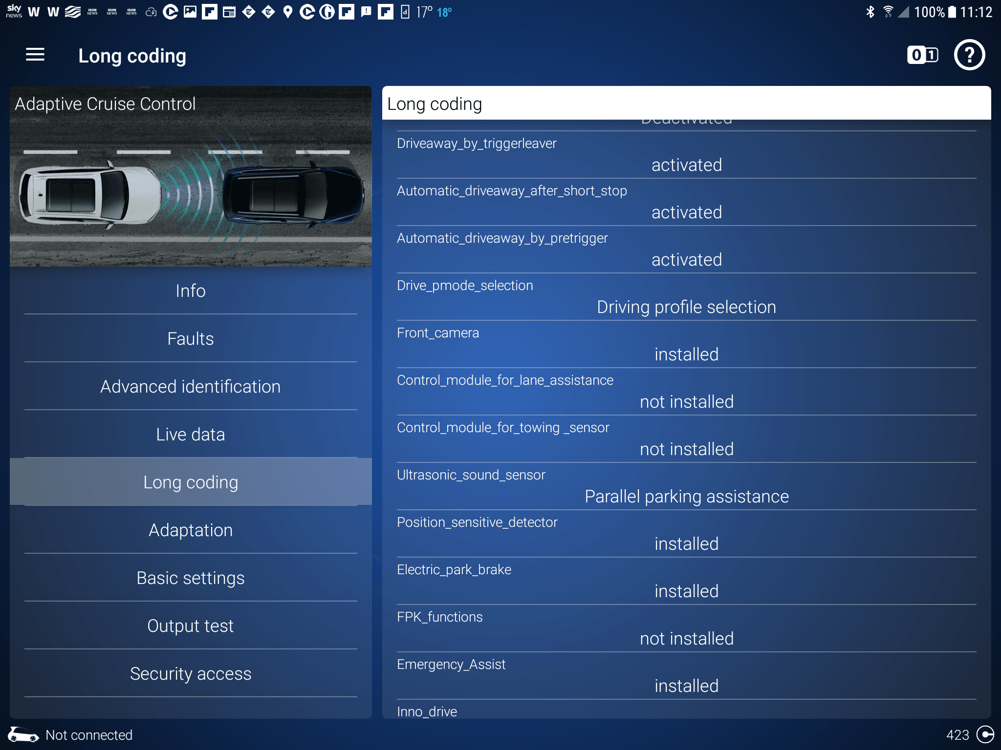

I'm sure it wouldn't have changed too much but you need to go across a range of control units I reckon you will hit locked down units if you haven't got... without looking at the spec expected they all have lane assistDoes anyone know if traffic jam assist still requires flashing of the camera parameters, like it does on the older models? Seems like this is the feature that makes lane assist available below 40 mph.

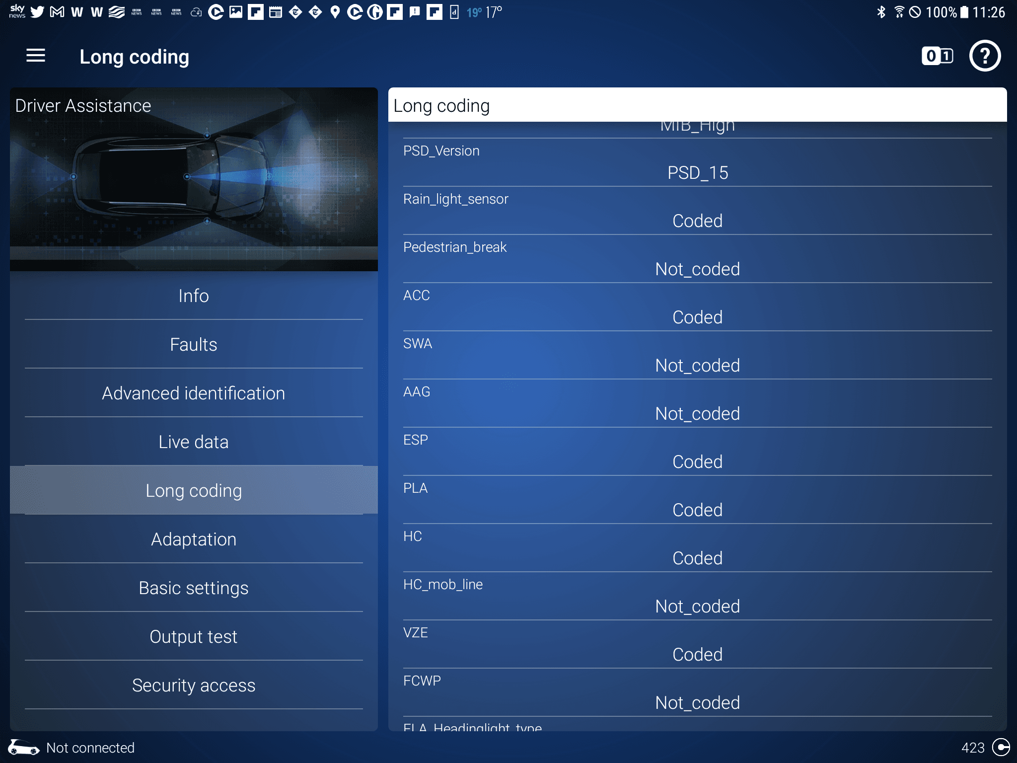

Changing rear-view mirror buying one with one more connector can I connect it activating blind spot detection through OBD?Has anyone managed to turn on anything like blind spot detection , adaptive cruise control, traffic sign recognition or high beam assistant?
I'm pretty sure that the rear-view mirror (and wing mirrors for that matter) has nothing to do with blind spot detection in the new Leon, you need the wrap-around ambient light and rear parking sensors. The wrap around lights cannot be retrofitted, so if you don't have those, I think you are out of luck.Changing rear-view mirror buying one with one more connector can I connect it activating blind spot detection through OBD?
Well the rear radar as well rather than ultrasound.I'm pretty sure that the rear-view mirror (and wing mirrors for that matter) has nothing to do with blind spot detection in the new Leon, you need the wrap-around ambient light and rear parking sensors. The wrap around lights cannot be retrofitted, so if you don't have those, I think you are out of luck.
