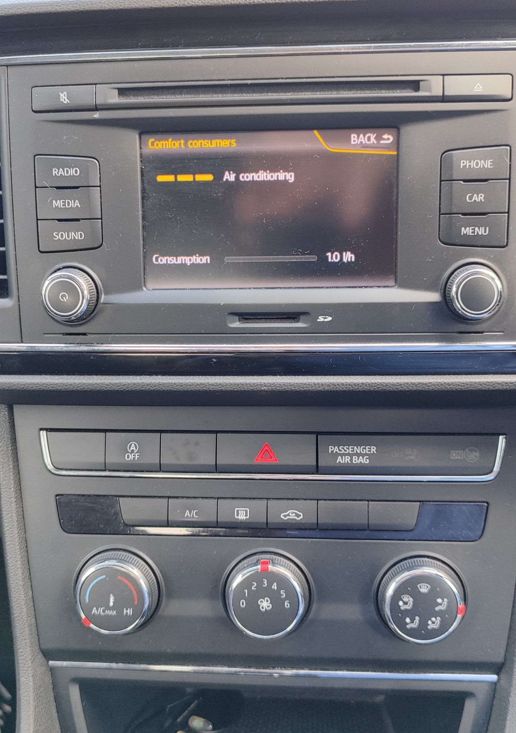

Hi all,
I have a 2016 SEAT Leon with the same issue. What I'm trying to determine is whether it's expected or actually an issue, before I take it to a dealer.
This is a particular problem now because of the weather, with it being -2 to -4 a lot of the time, and also humid, the inside windows are always coated in condensation and/or ice.
I switch the engine on and have the heaters on full and heat turned to max blowing on the windscreen, but it does nothing. I can leave it for 10 minutes and it'll be no different - the air coming out is ice cold. I actually need to drive the car and get up to 40mph for 10-15 minutes before it's capable of blowing hot air out the vents.
It seems weird to me because my previous (older crappier) car was able to produce heat from the air vents quickly, in fact it was the main way to defrost the car in the morning. Whereas I have to drive this car wearing a thick coat and gloves and poor visibility, because I cannot get it to warm up on the driveway, the only way for it to produce warm air is to drive it for 10-15 mins.
I do notice that there is a dial under the throttle display which I think is the oil temperature, which is on one bar until I have been driving for about 15 minutes, and then it goes to the halfway point which is where it should be, and the car is only capable of blowing warm air after that. Is that normal?

With any car built over the past 20 years, I'd never plan or expect it to generate enough heat warming it up on the driveway - which in itself is a very antisocial thing to do.
If you are finding a lot of condensation building up in your car overnight, then find out why it is doing that.
For instance, EA211 family of petrol engines only seem to produce as much waste heat as a TDI engine.
I tend to garage our cars, and I only switch the "heating" on for short bursts to keep the windscreen clear, until the engine is up to normal working temperature as stripping waste heat out of a cold engine will slow down it keeping up to normal operating temperatures - as indicated by the coolant temperature. If your own car does not have an engine coolant gauge, then shame on SEAT for that.
Edit:- @Debaser, which engine is in your Leon?

Hi all,
Which engine?
My Leon TDI 184 blows warm air out the vents within a 1 - 2 miles.
I also have an electric heater but this only kicks in when cold out and certain criteria are met - like when you are driving/ not sat idling, but to be honest it gets warm so quick I don't think the electric auxiliary heater kicks in much.
The TDI has a micro heating circuit to enable quick heat up of cabin air and EGR valve.
Should be able to blow hot air once the engine is warm. Sounds like either your coolant system isn't getting hot and/or your heater matrix is blocked.
Do you get hot air out the passenger vents - vs warm/cool driver vents?
