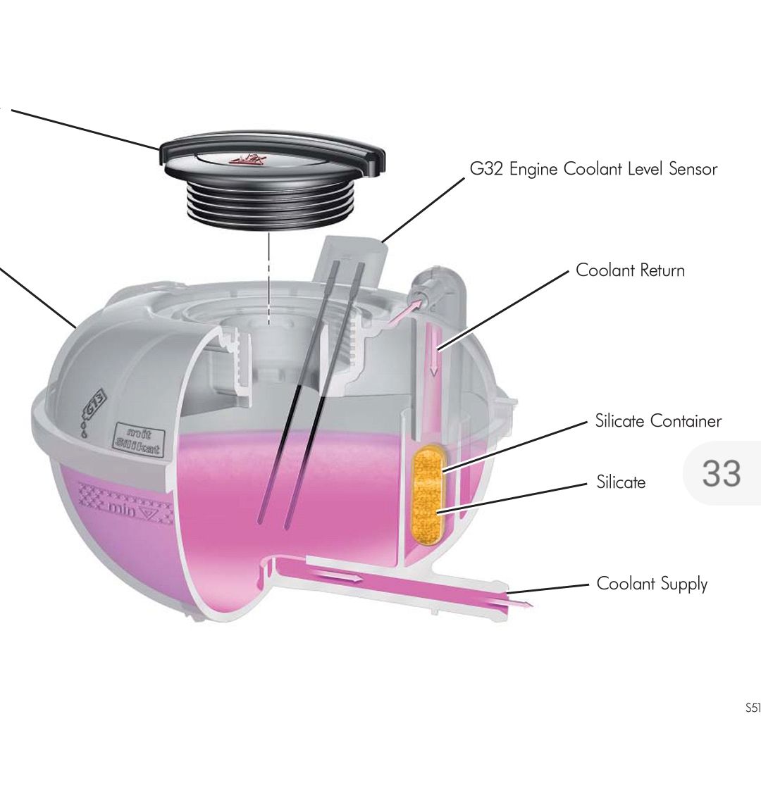

Why not just pull out the bag?
Depending on which bottle was fitted at the factory - you can't access the silica bag/capsule

Not ALL tanks have this 'tea bag'!
By all means - if you look through the filler neck and see a 'tea bag' you can carefully remove it and change your coolant to G12evo - but my tank, like the image above has a self contained silica bag - which is not accessible - you'd have to cut the tank open to get to it - so in this case you'd need a new tank without 'mit silicate'
I'm not convinced these type of tanks can leak the silicate - as it is contained in its own chamber - but new tanks aren't expensive so might be prudent to change when you change/flush your coolant.
