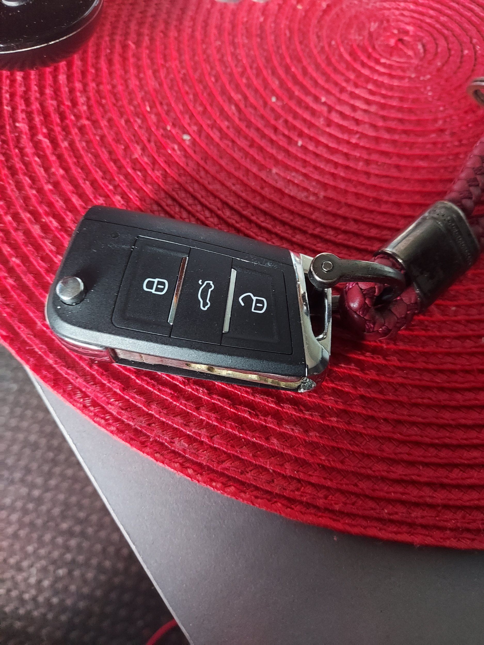

Yeah I'd say it is, I had my main key done with a 3 button as I wanted to use the boot button as well, plus I wanted a more modern key, my car is a 2004 leon.

It had to be programmed in bud, which he did 40 min job with new key etc.
dam it lol, can get a key made up local but not sure if he can do the boot button and I've not got that software as well, wont mind the press and hold to shut windows as well, worth an ask though
