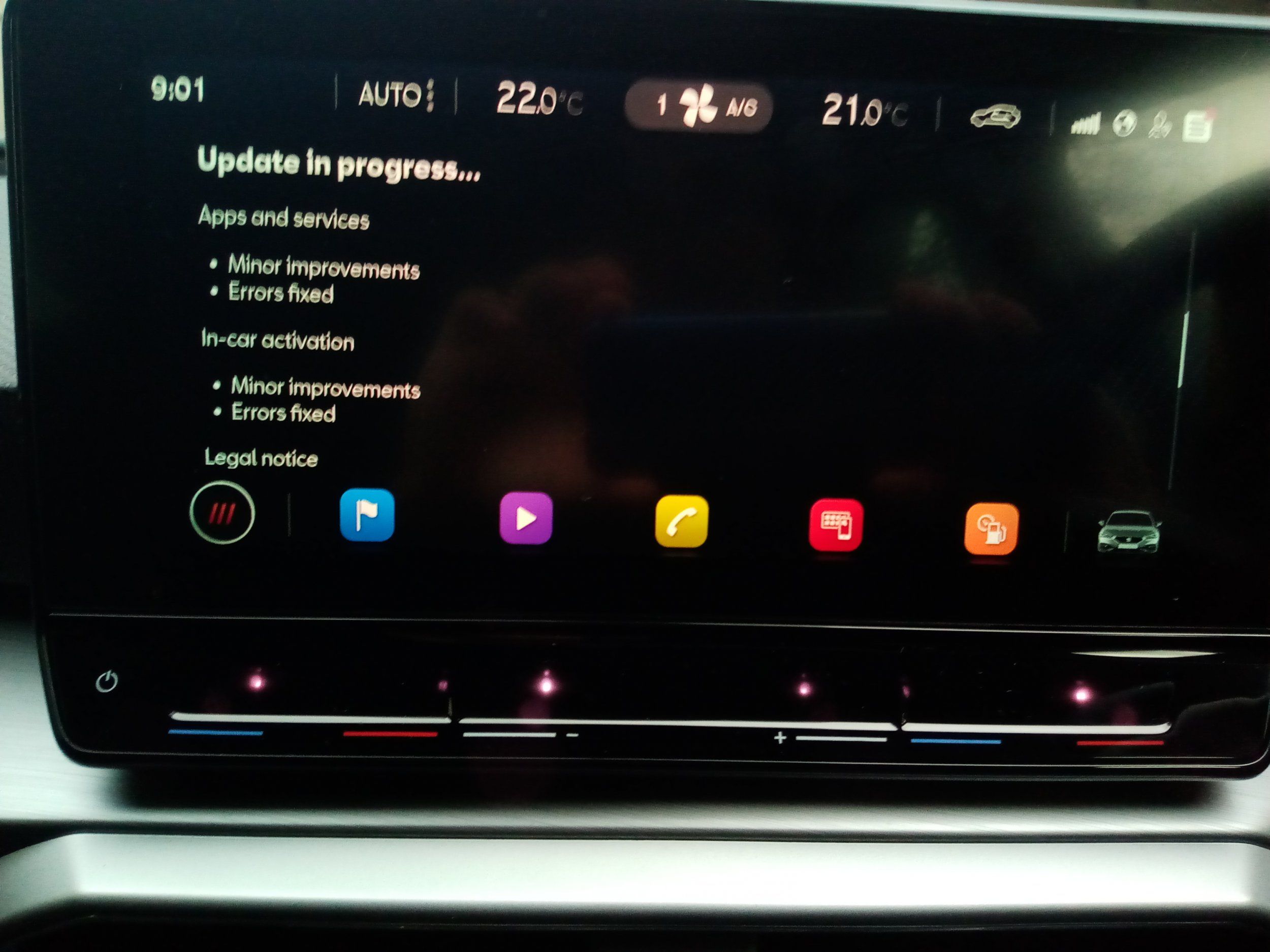

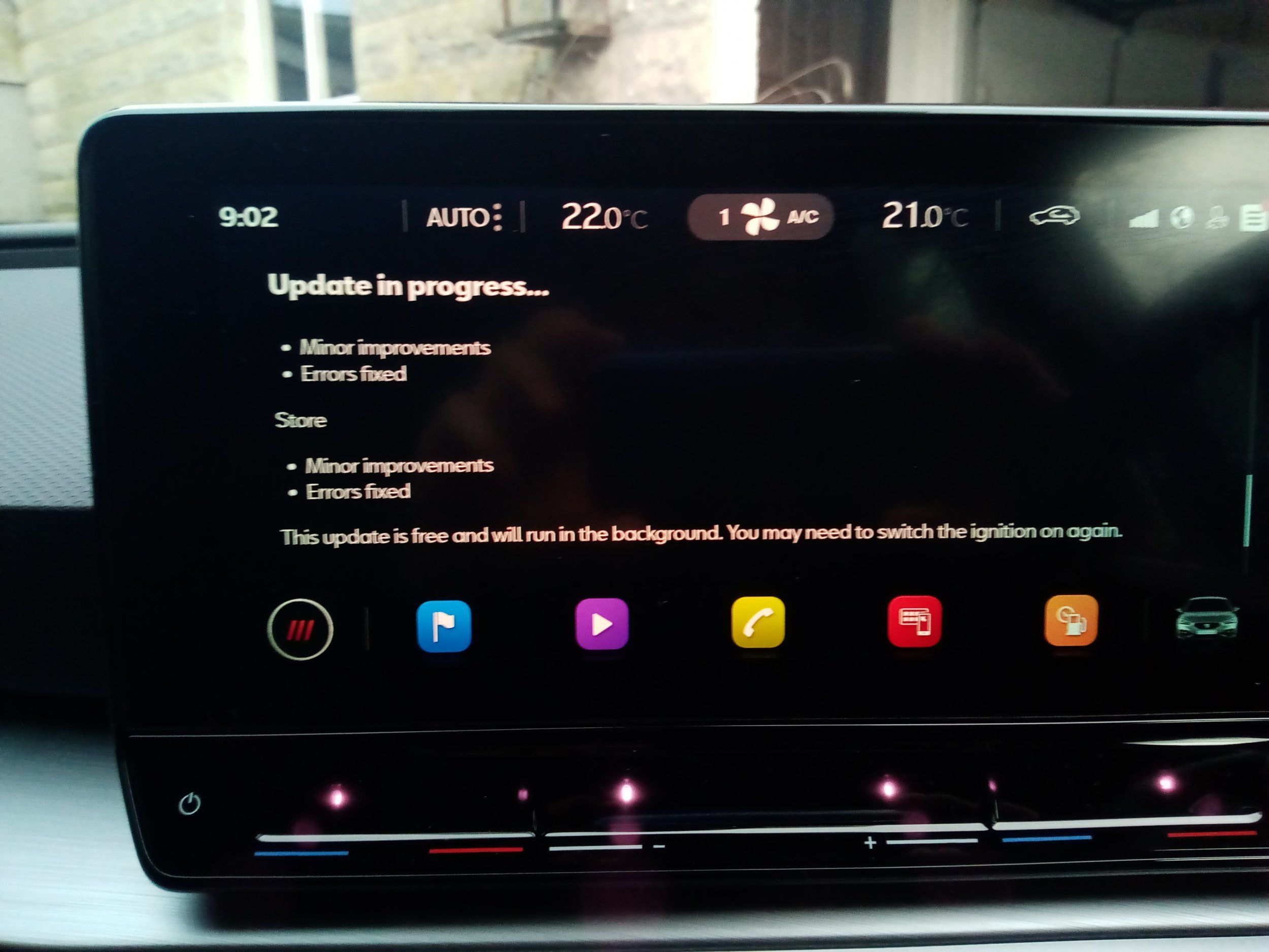

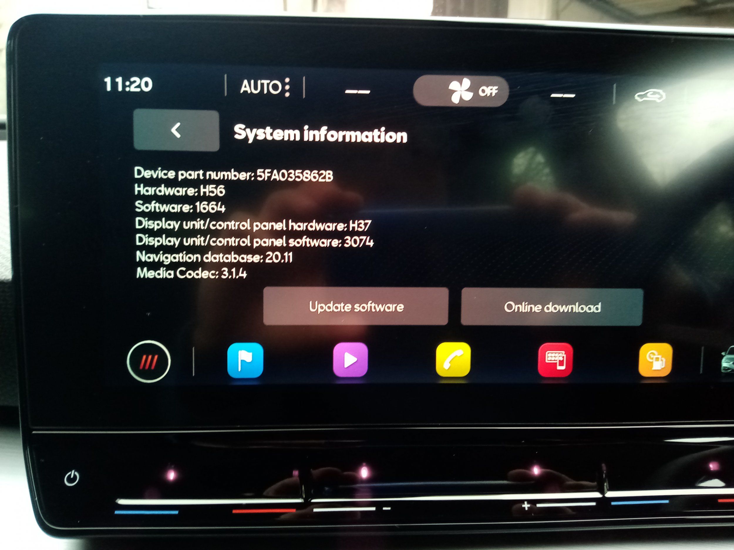

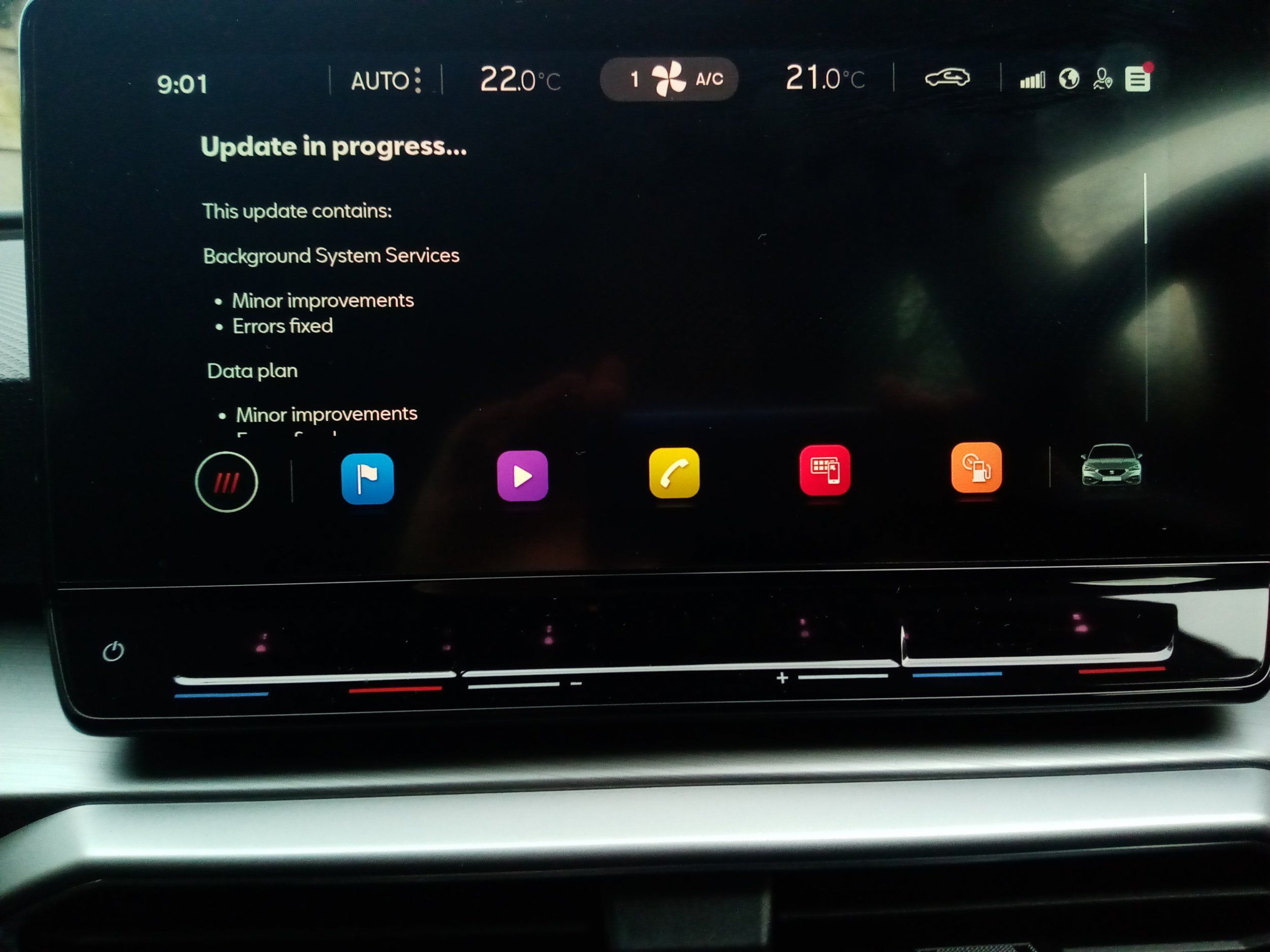

My update took around 30 minutes. Here is the updated software details and the updated services.

Strange, my software seems to be newer than yours, mine say Software: 1790, it's the version it shows both before and after update. But I just found an email to the company who support the system (Connected Cars) in Denmark, and the responded almost instantly and sent a reset to my car, and I have just made a short trip in the car, and then it got activated, so all is good now. :)
