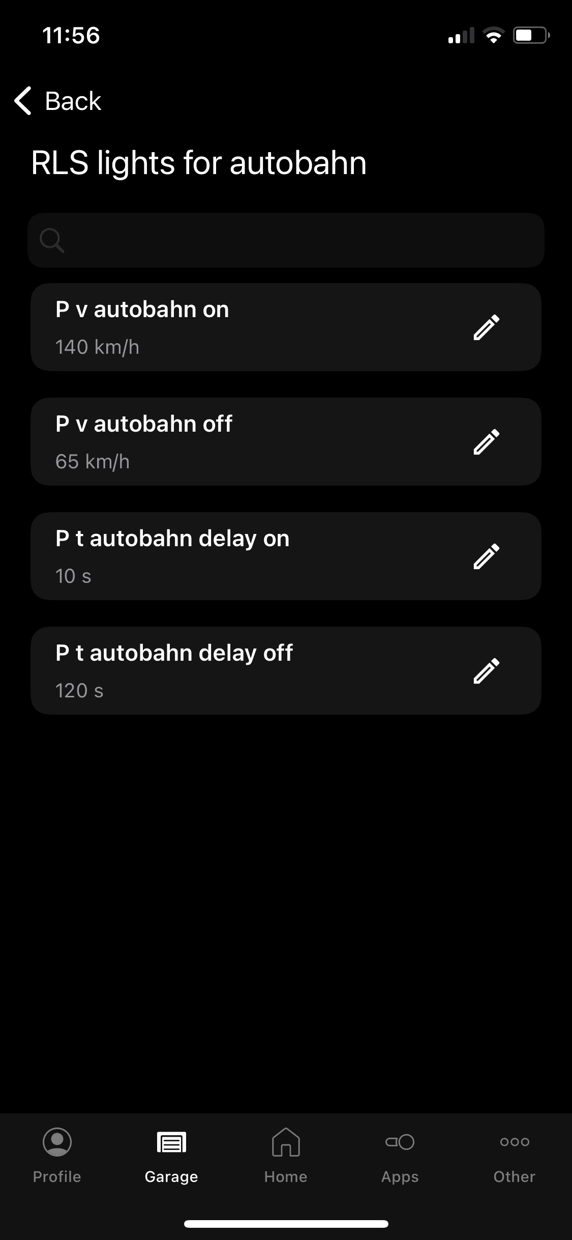

Massive thread revival here.
Im looking at changing this setting on my 2019 R ST
I find the headlights not great on fast roads, motorway etc etc and I never see the lights raising even though I’ve ticked motorway lights in the settings.
The only setting I can find in the Control Unit 09 that might relate to this is
“RLS Lights for AutoBahn”
Is this the setting to adjust ?
Also the speeds are 140kph on, 65kph off
And 10secs delay on and 120secs off.
Doesn’t seem like the same settings everyone else on this thread is talking about ????
On the Mk5 Golf the lights used to come on at c.90 mph (140 kph) with auto lights (based in Germany at the time, so definitely worked).
I believe that this is the setting where your dipped beam and rear lights will be illuminated when in auto light mode, regardless of how dark it is outside.
Reactions: Slickric21
Slickric21
Feb 23, 2019
554
253
Norfolk
Ahh very interesting thank you for this.
Sounds about right
I was wondering/hoping it was the setting where your lights raise 5% when on the motorway as per the first few posts in this thread.
Id like to be able to lower the speed at which they raise…. I’ve never actually seen them do it on my car and the handbook states 110kph, but they don’t.

I’ve manually raised the drivers side with the adjuster screw and it’s improved things considerably, but I’d love to get the “motorway” light feature fine tuned or even working.
The handbook states 110kph they raise 5% but I can’t see evidence of this.
I can’t find any setting in any Control module in OBD11 relating to it, other than the Autobahn light setting in the post a few above.
But that seems to be something different entirely.
Slickric21
Feb 23, 2019
554
253
Norfolk
It’s strange however that there is mention in a lot of places from Seat - online,
Car handbook about 110kph raising of the headlights.
Mine definitely don’t raise at 110kph, I can see about 5meters of the road ahead, no more 😂.
The reference I found in Contol module 9,
RLS for Autobahn clearly shows 140kph.
But why would it be called RLS (rain/light sensor) in reference to control the headlight raising ?
Surely all that implies is it is in fact an on/off feature of the headlights at 140kph.
Im not sure how I can test this… drive at 86mph during the day somehow try and tell if the headlights come on 🤷🏻‍♂️
black_sheep
Mar 10, 2013
1,251
587
One way to check if the system is working (headlights, plus the front and rear levelling sensors) is on start up at night whilst facing a wall or garage door - the light beams will move across the full range as part of the built in test. Mine definitely work as intended at UK motorway speeds. I live quite close to a motorway/national speed limit road, and see the beams lower when I arrive home, but it is not noticeable when they are activated.
In response the the RLS comment, this is because the function only operates when the light switch for RLS is in the 'Auto' mode, the same as High Beam Assist.
And for all of those commenting about how poor the LED lights are, do some back to back driving with halogen non-projector lights.
Reactions: Tell
Slickric21
Feb 23, 2019
554
253
Norfolk
Good info thank you.
Mine go through the self levelling test on startup no issues there.
The issue is my lights never seem to raise in the motorway.
As stated, I’ve just raised the drivers side beam manually with the adjuster screw and it’s better, I can see about 10 meters now not 5 on an unlit road.
Do you @black_sheep have OBD11 by any chance ?
Can you check in Control module 9>Adaptations>
And see if you have the same settings as me posted above 🤞🏻🤞🏻🤞🏻
