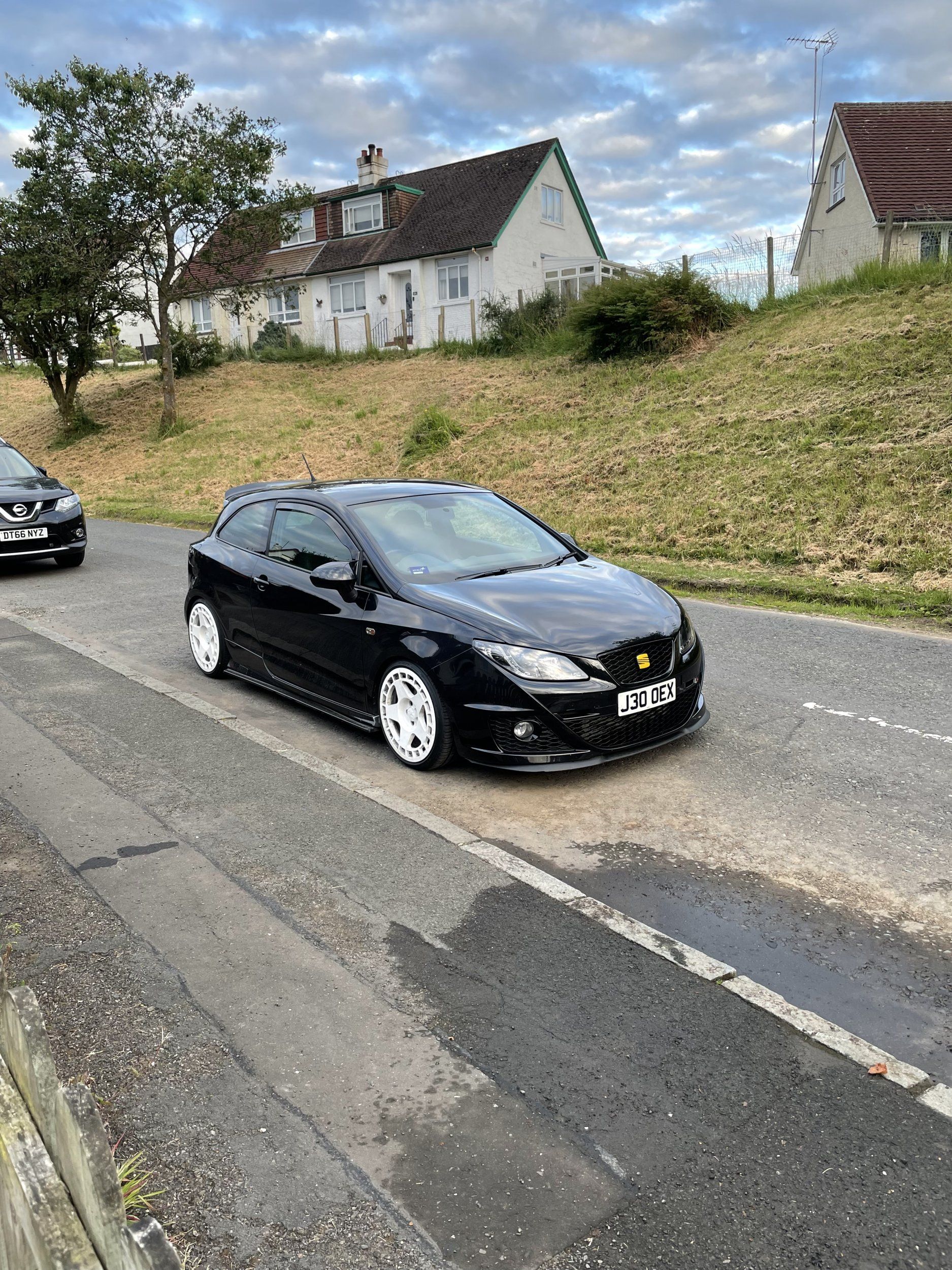

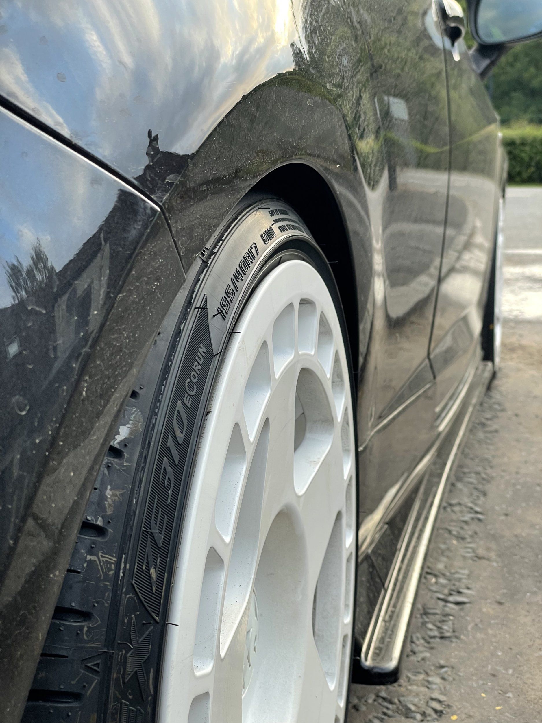

New wheels on, OZ’s off. The OZ’s are in dire need of a good refurb. Really happy with how the new Fifteen52’s turned out on the car, think the white actually suits it quite well!

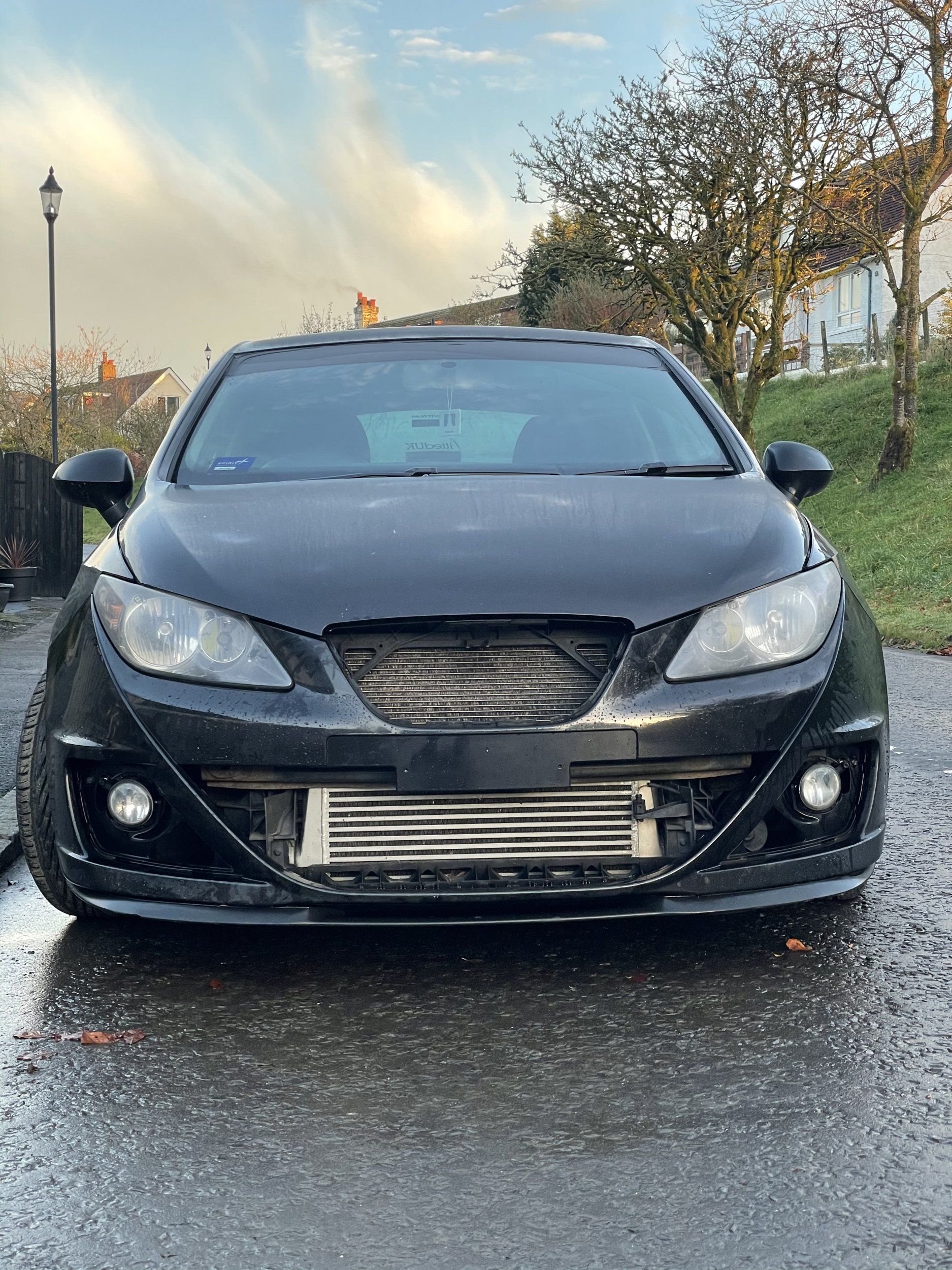

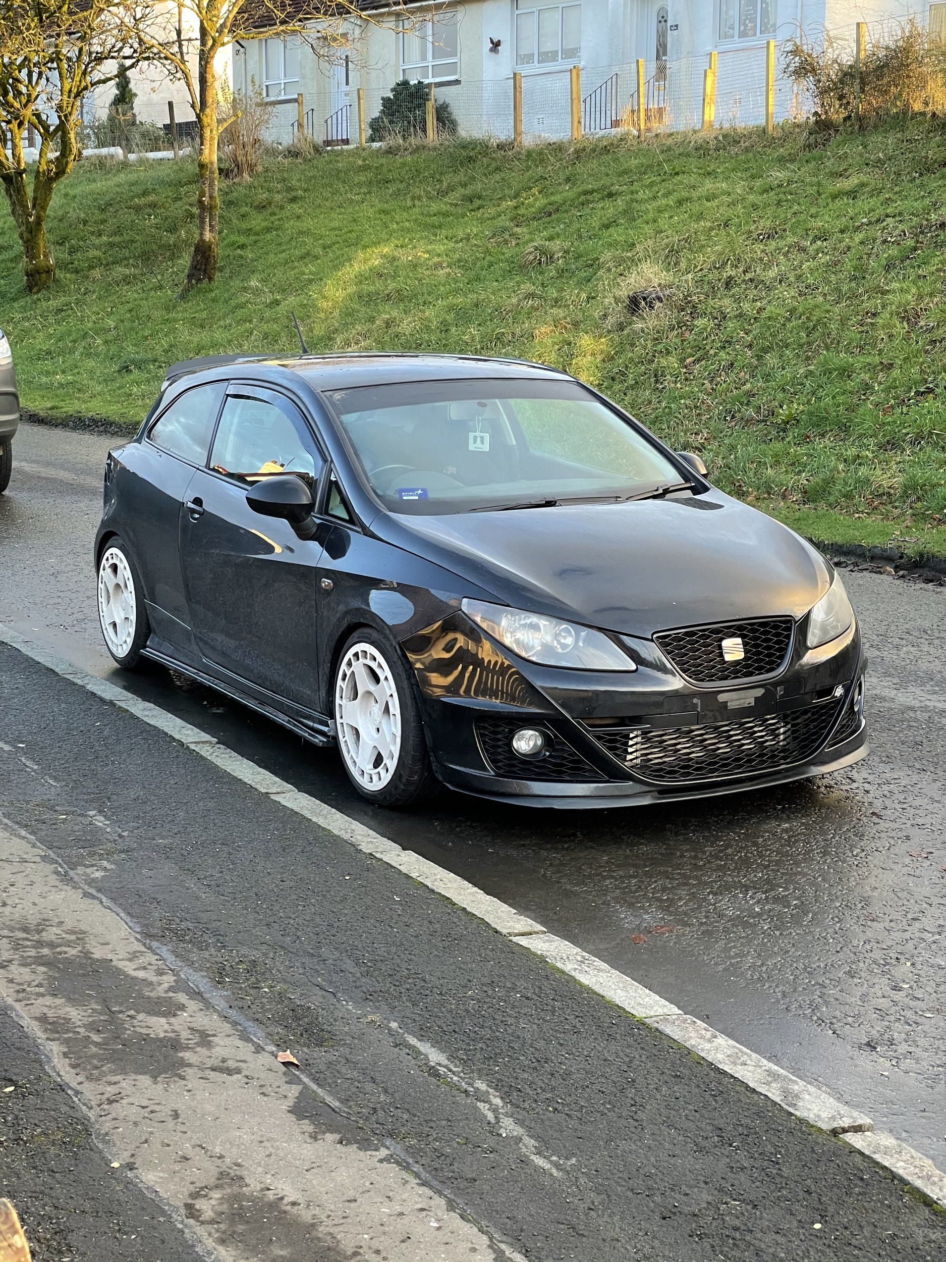

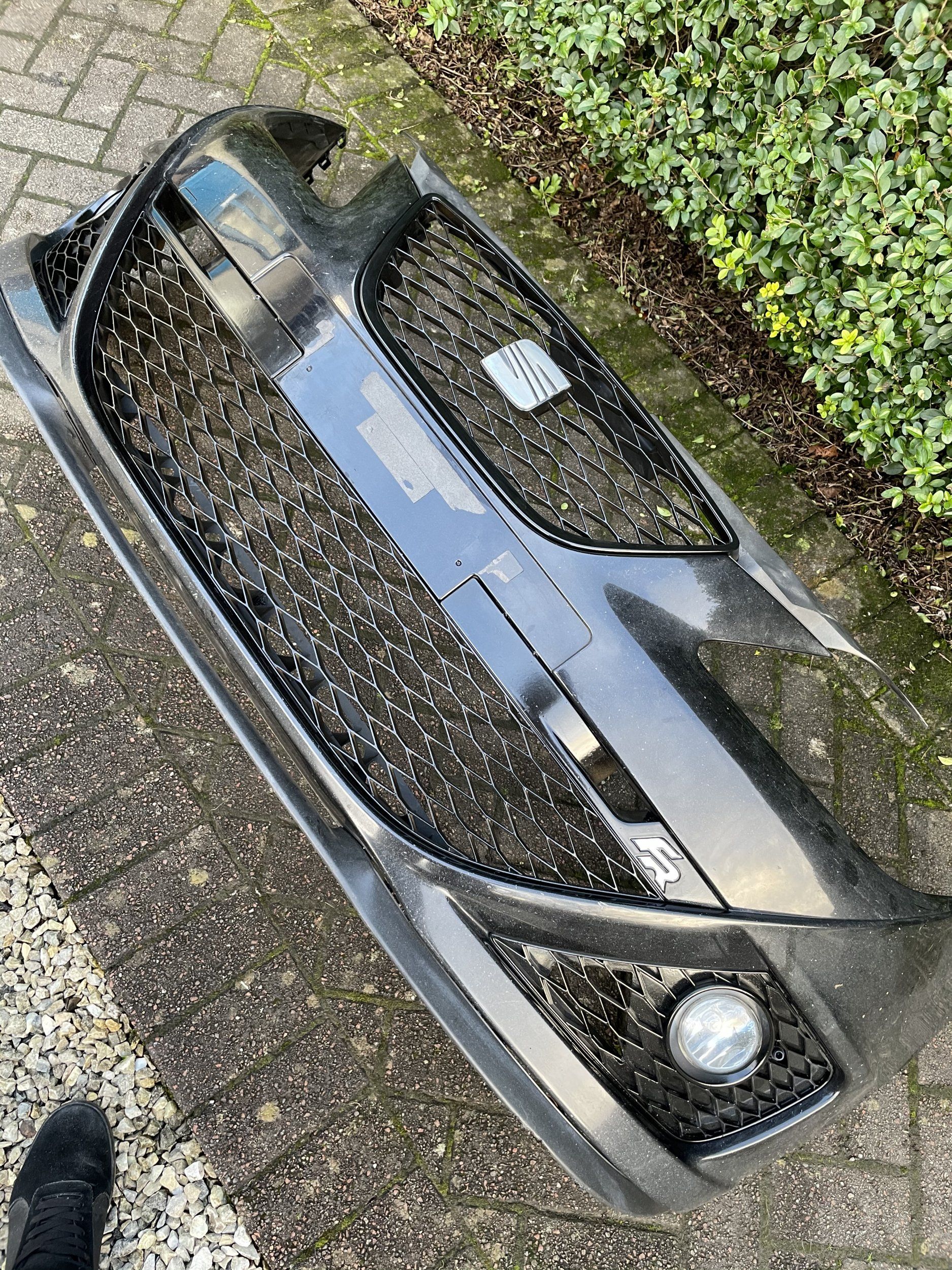

Stripped off all the front grills as I decided it was time to get them painted
Been commuting like this for the last 2 weeks while they were away haha. Now returned and spent the afternoon of light and dry weather building the bumper back up. Quite a pain in the arse to get the lower one out and even worse putting it back in. Managed after a bit of time struggling.
Needs a good wash and a couple of ends tidied up but looks much better.

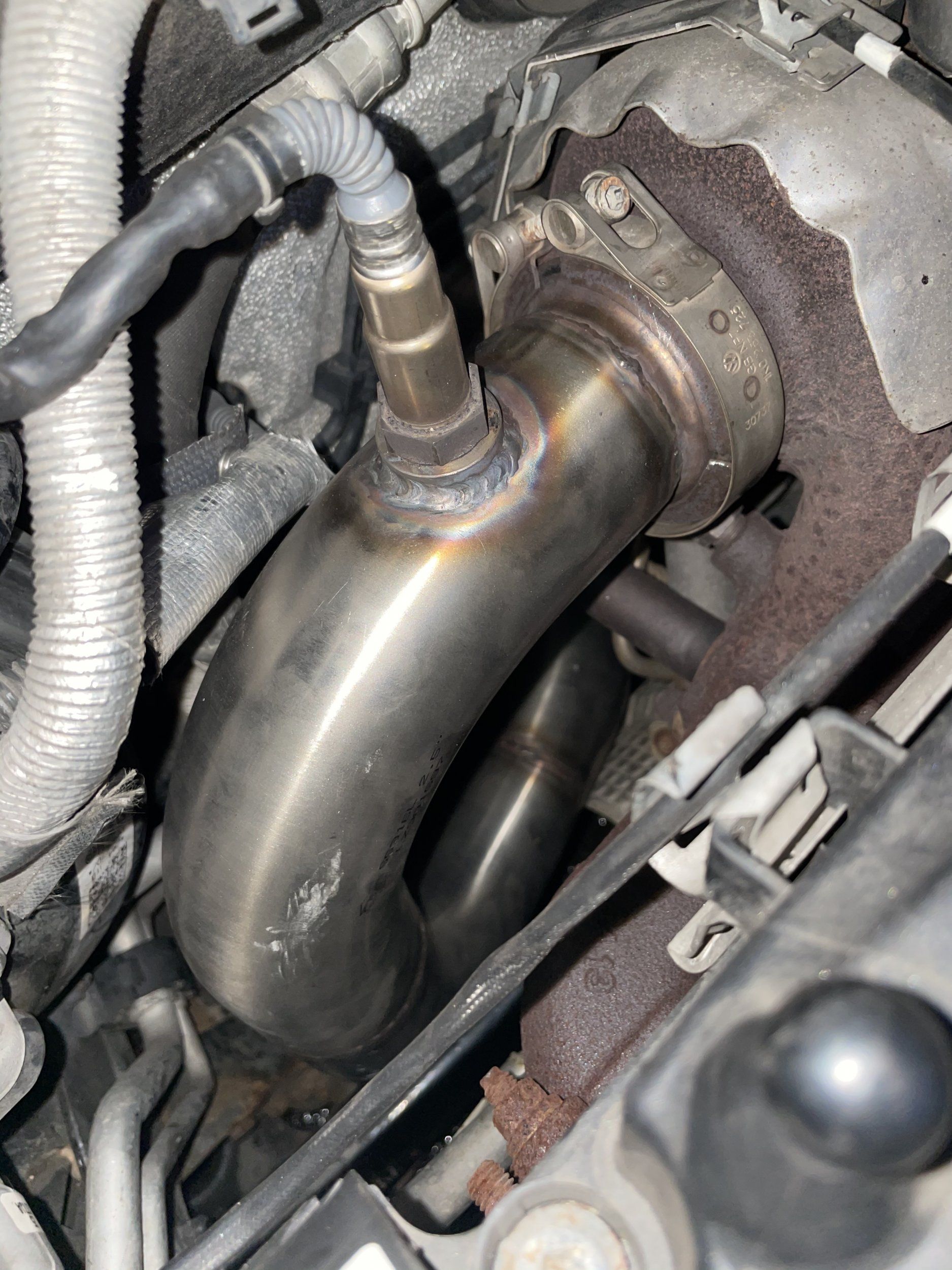

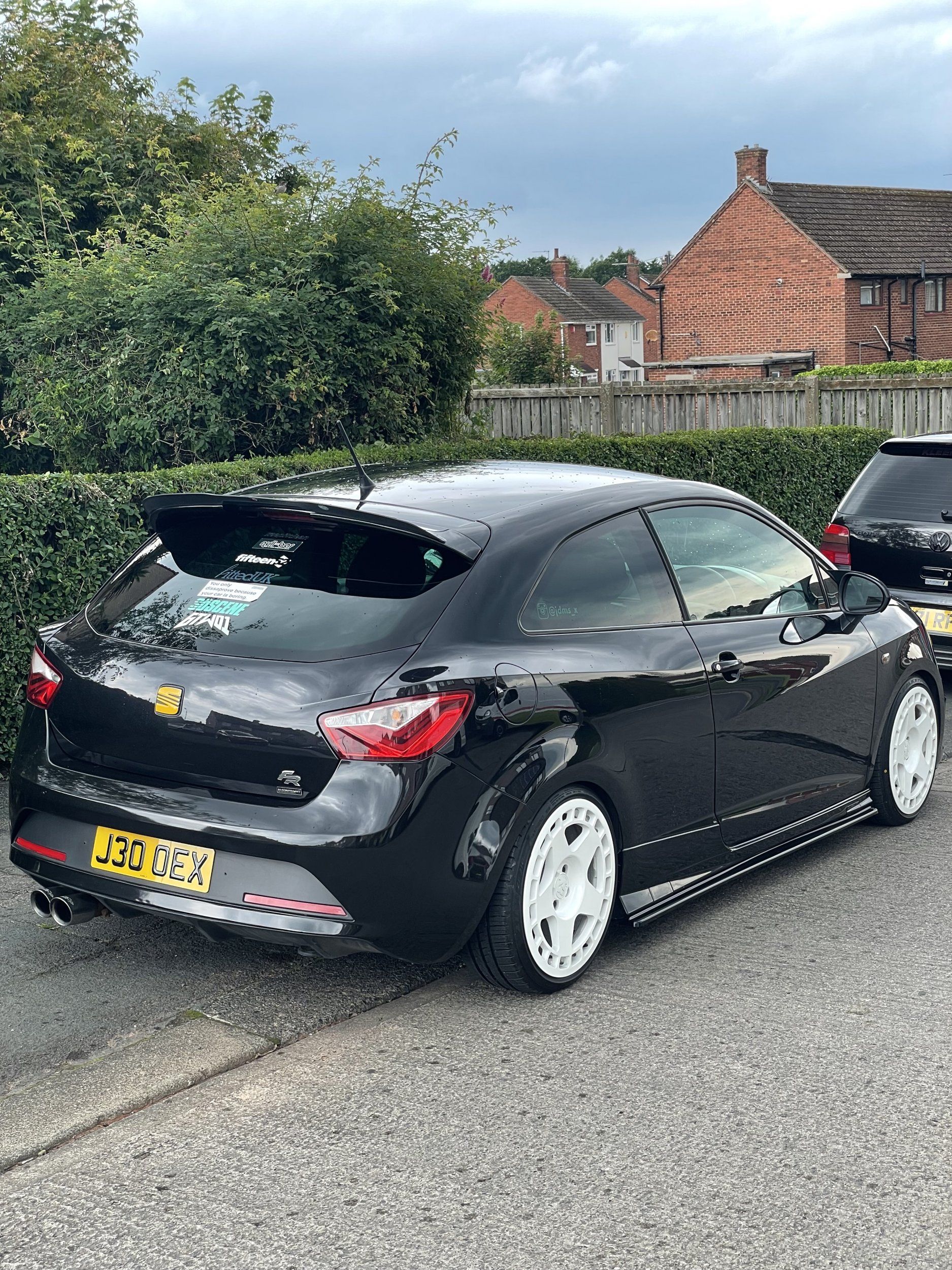

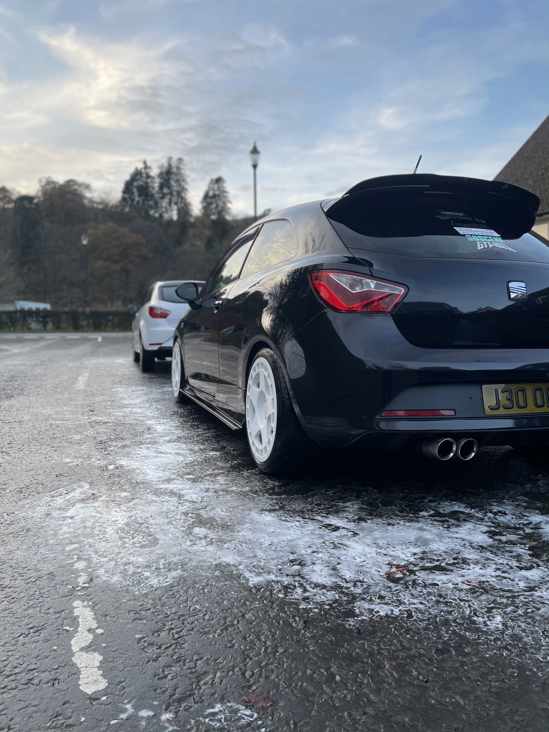

Also finally got the downpipe made up for this! Now running a full 2.5” straight pipe system.
I wanted to give my personal review of each of the different exhaust stages I’ve went through and how they’ve changed the performance of the vehicle...
*All stages were during when the car was remapped*
Stock exhaust w/ dpf and cat: Not much to write in this section, fairly average
Stock exhaust, DPF + EGR deleted, cat still present: Apart from getting rid of the annoying regens, and issues that the dpf and egr give, torque was felt to be improved in the lower rev range, noticeable straight away when first pulling out of a junction. The car seemed much happier and not held back as much.
2.5” Cat-back, DPF Delete, Cat present, Stock Downpipe:
Made a difference through the whole rev range, less throttle was needed to achieve the same speeds. So on my normal drive home where I know the road and speeds needed to drive comfortably, where I’d usually travel at 40mph, I automatically ended up driving the same parts at 50mph with no difference to driving style. Noise was good, slight owl noise during gear changes like the old pd engines do, quiet on idle, throaty on boost.
Full 2.5” system, No Cat, No DPF:
So I only have minimal experience so far (45mins worth actually) but I’ll add to it in a few weeks. First thing I instantly noticed was the jet turbine whistle coming from it as soon as I started it up. On boost it rips very loud, almost sounds like it’s rattling like most straight piped diesels do. I also felt that the car didn’t bog as much during the 1st > 2nd shift change. Unfortunately it sounds like the owl noise has disappeared due to the new dp which is up to personal preference if that’s a good thing or not haha. Happy overall with it, I’ll keep tabs on fuel economy and other subtle things I pick up on.

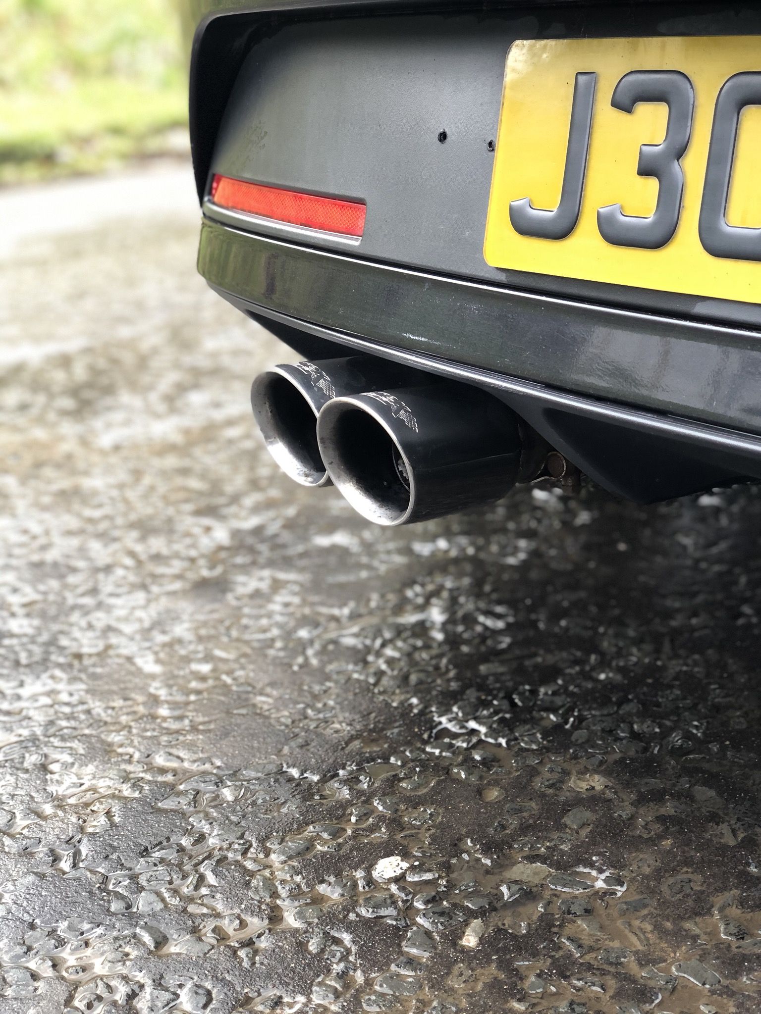

(Photos for rear view of exhaust)

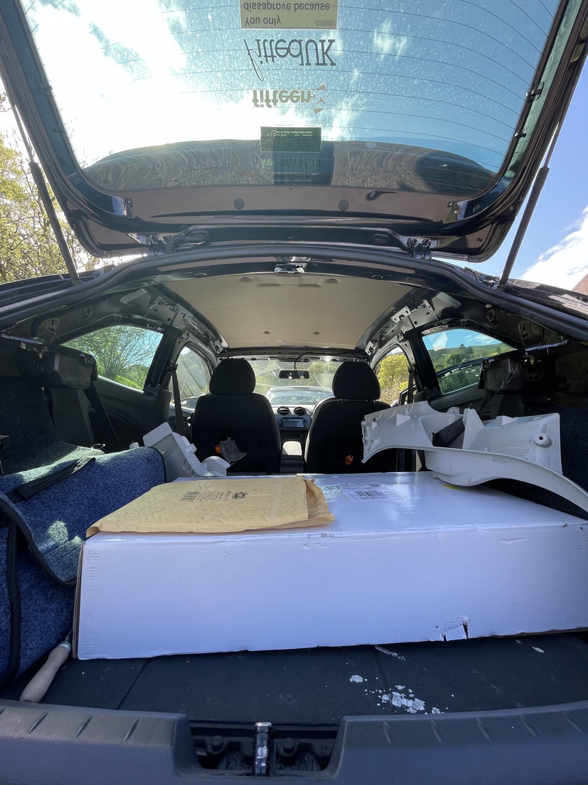

Finally got a hold of a black cupra headliner and all pillar trims. Tackled this a few weeks ago, not a hard job at all, ibiza interior is particularly easy to take apart. So glad the cream has gone!

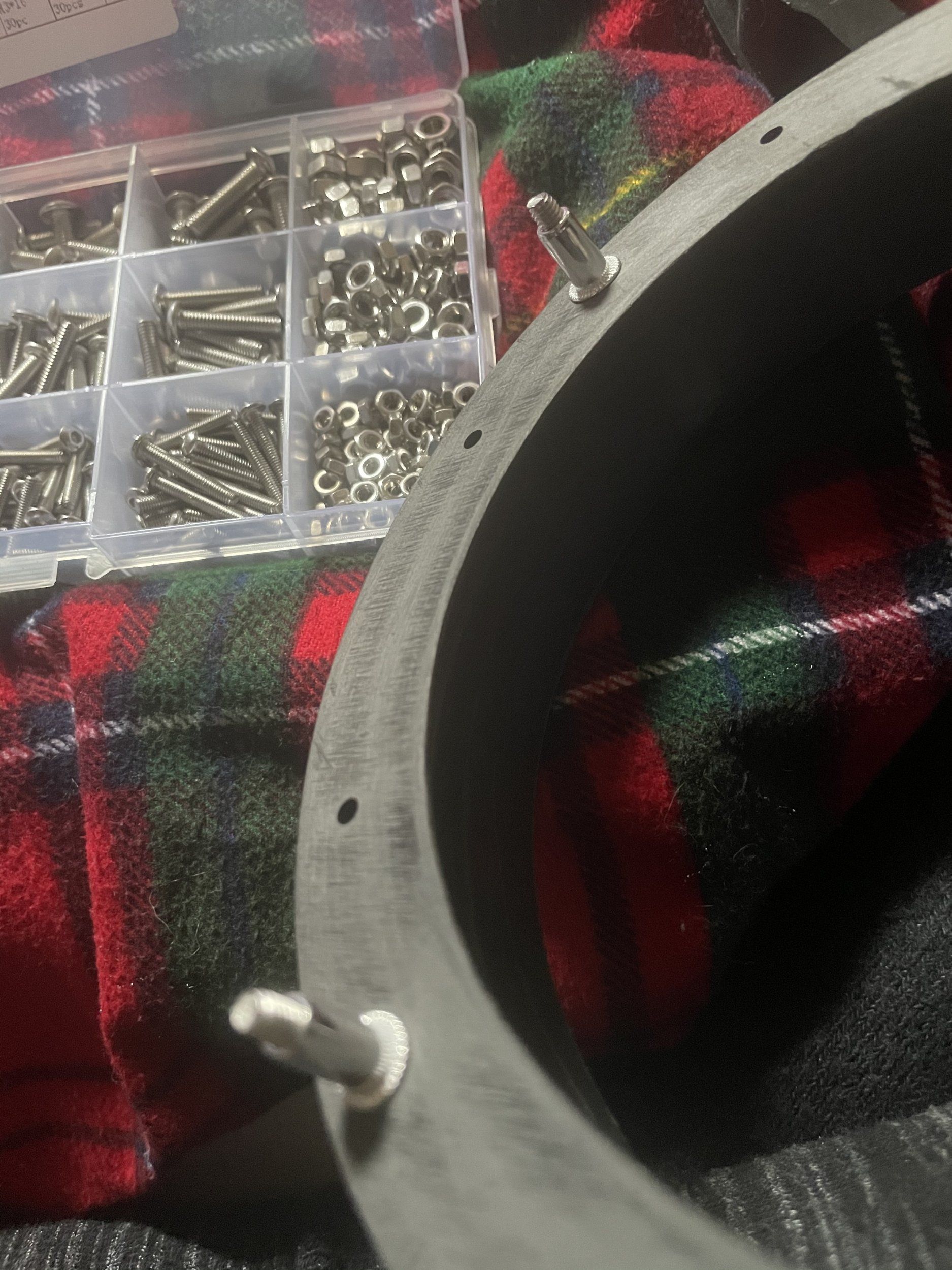

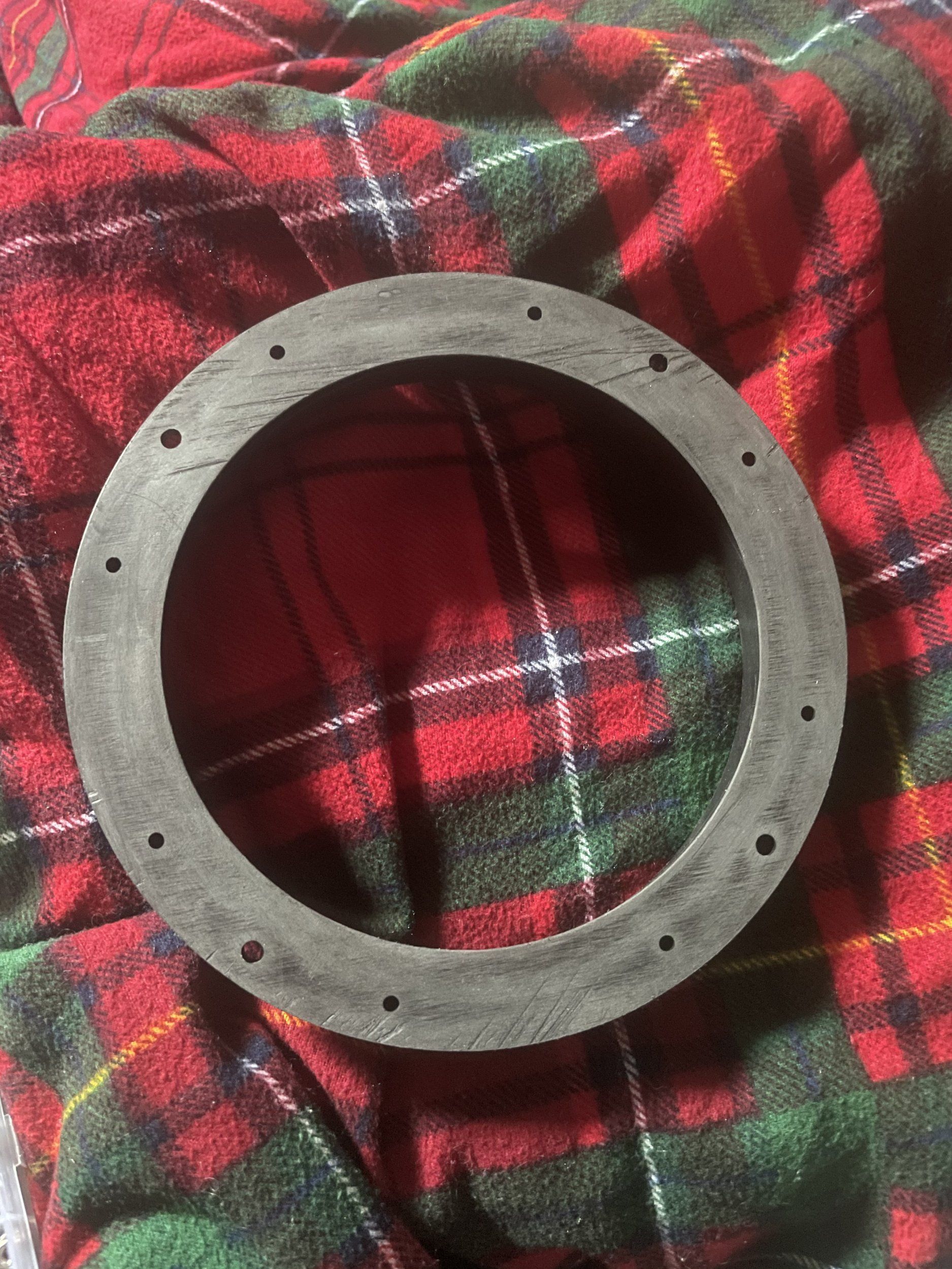

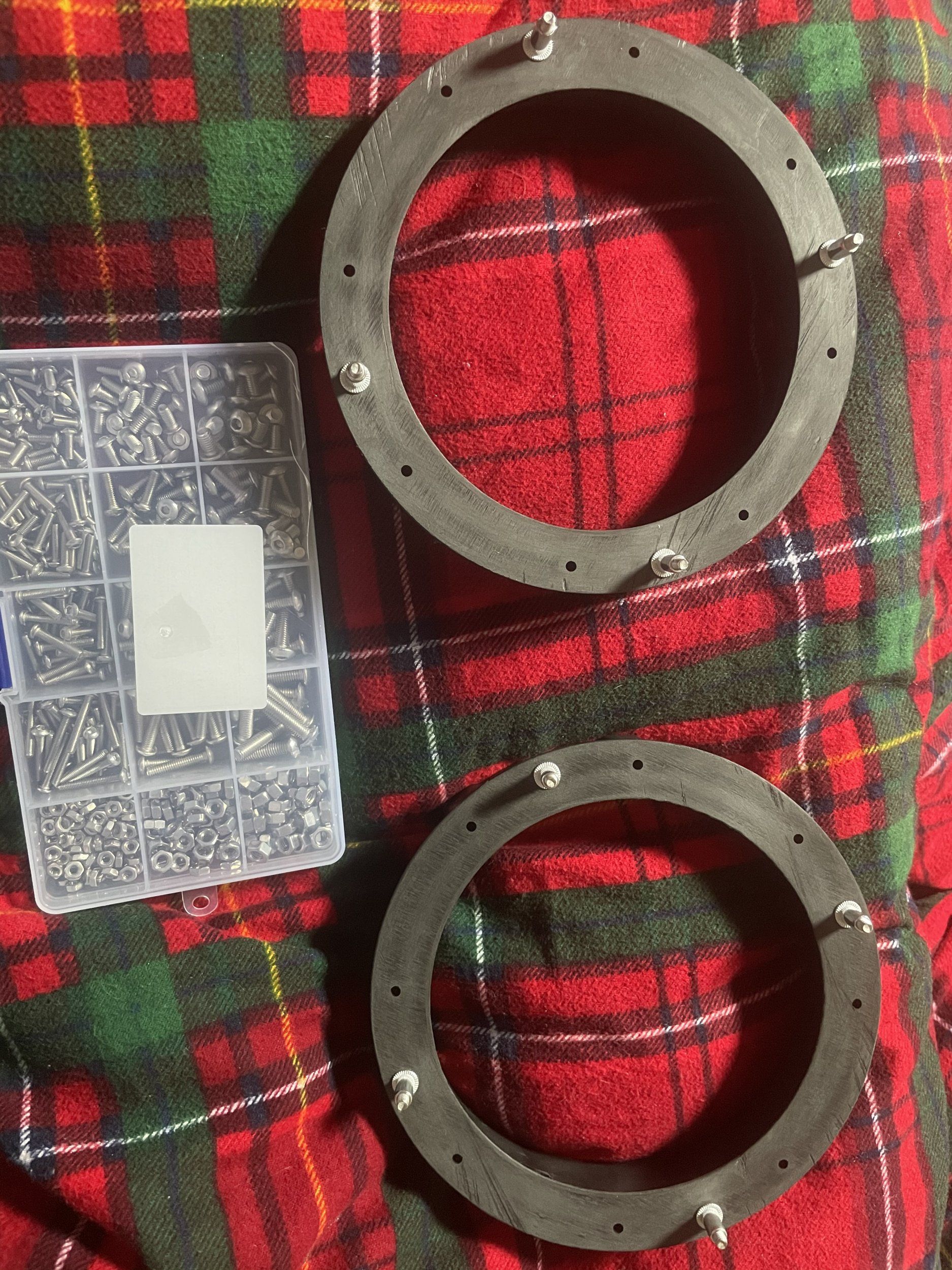

While pulling apart the interior, I remembered both rear speakers had died some time ago, and never got round to changing them. The rear panel covering them is easily accessible so ordered a few things and surprise, the speaker adapters don’t fit, so back to modifying them and trying to go a neater install then the front ones I done some time ago.

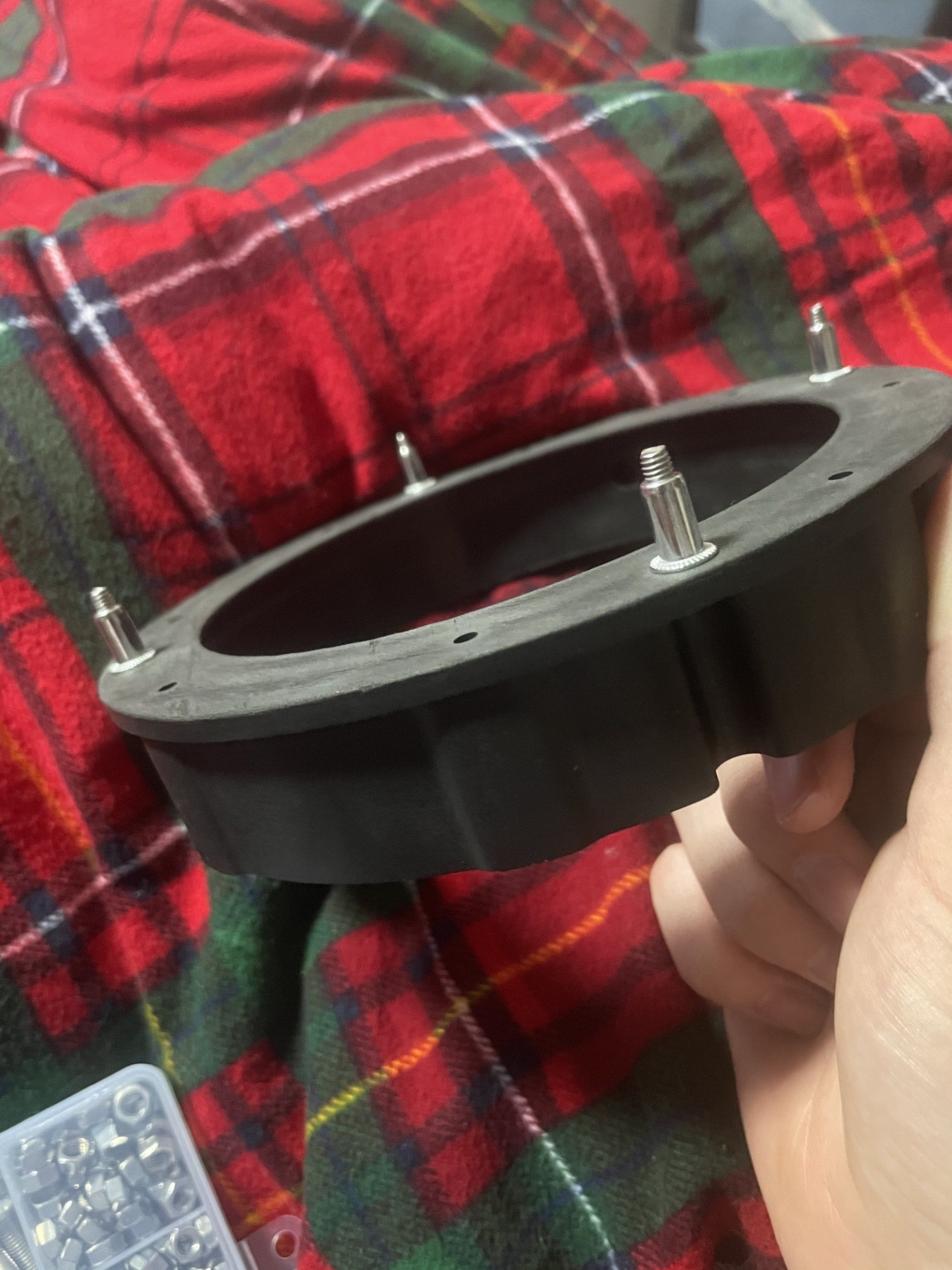

Edge of the adapter had to be cut off as it wouldn’t fit flush inside the car. Few rough marks but tried to file and sand the worst of them out. At the end of the day, this surface will never be visible.
Box of fasteners I had lying about has came in very handy. I bought a rivnut kit so I can do a tidy install, and the fastener kit just happened to have perfect bolts to fit through the adapter and also secure the speaker to the adapter. So began mocking everything together.
Next is to install into the car, drill bit acquired to open out the oem speaker rivet holes so we can get down to squeezing the rivnuts in position. Will update later this week with more on this.

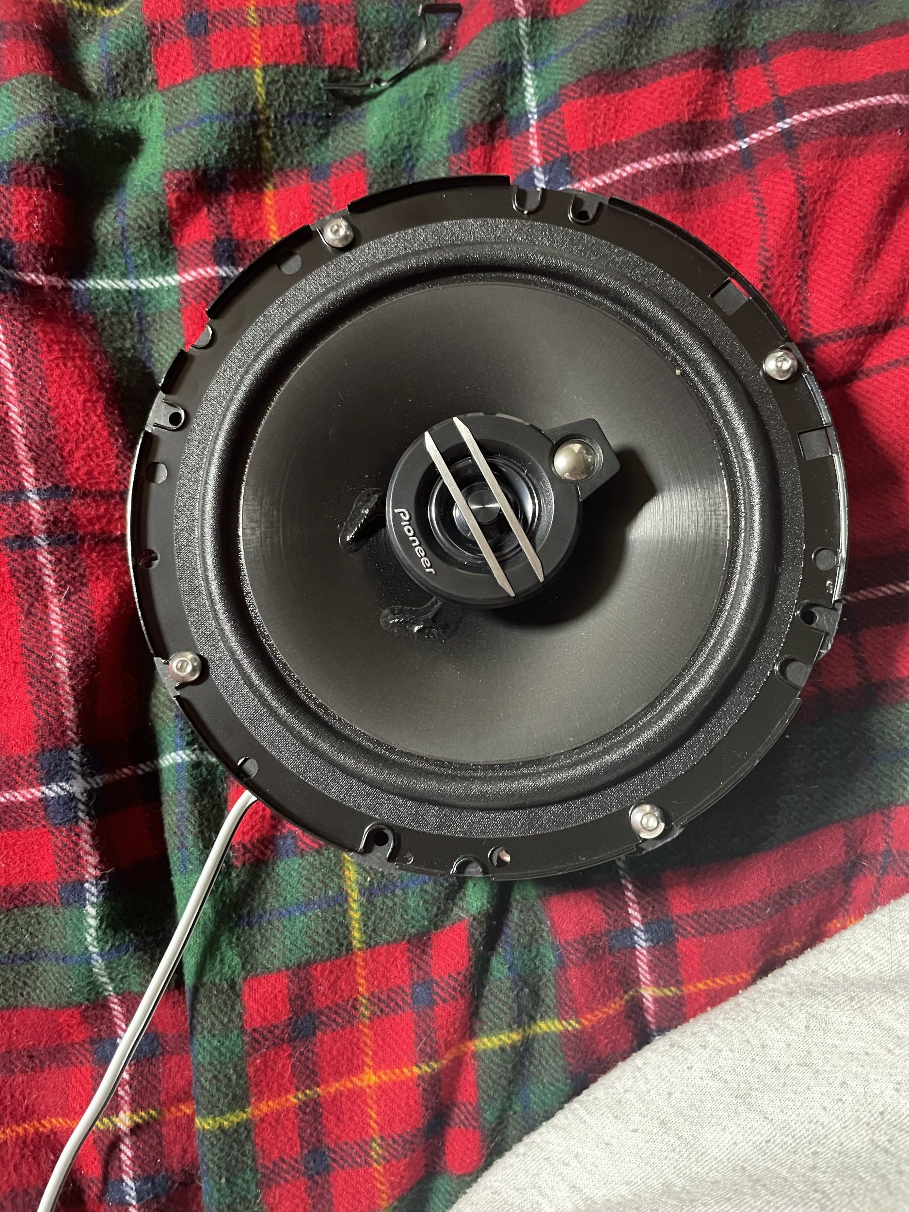

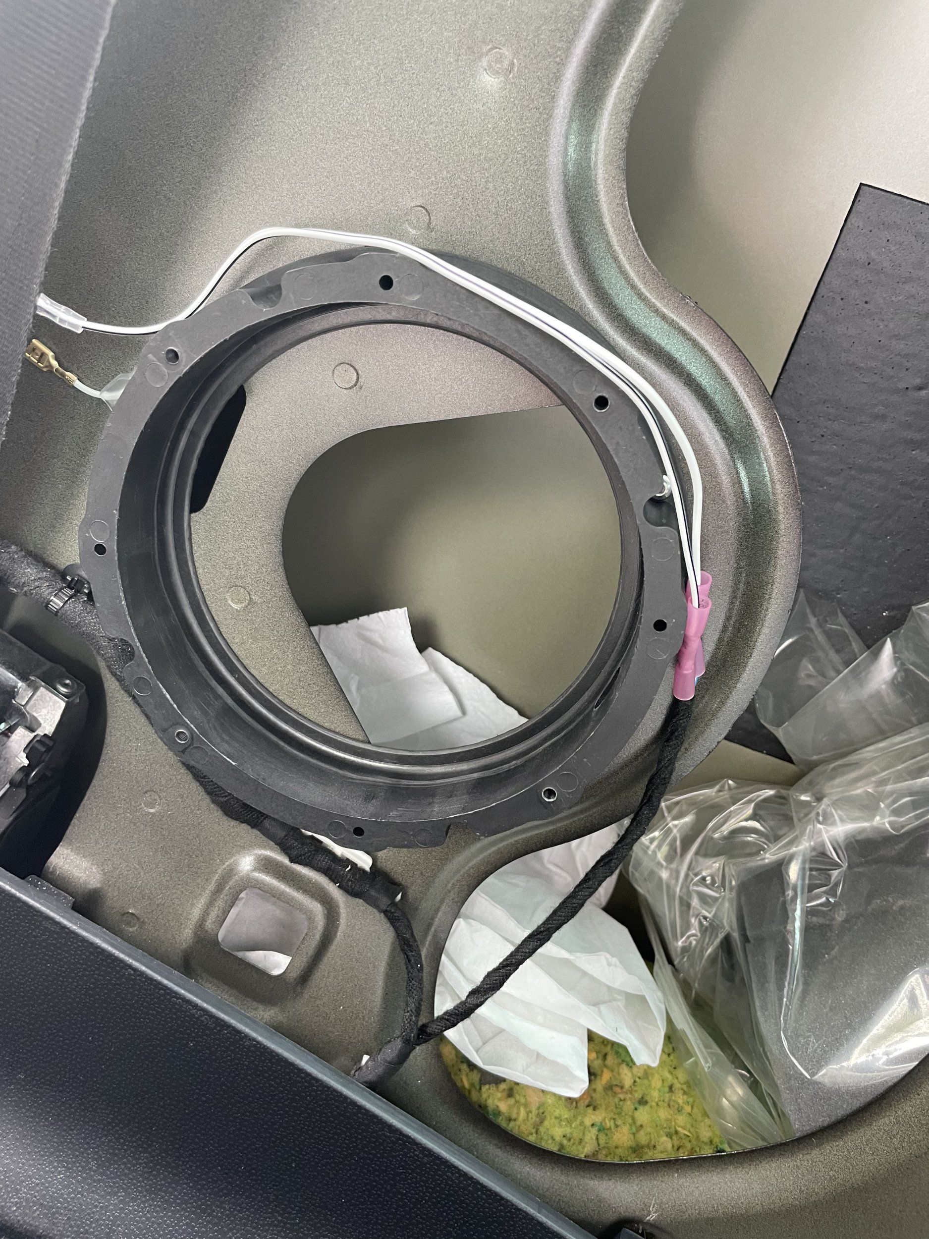

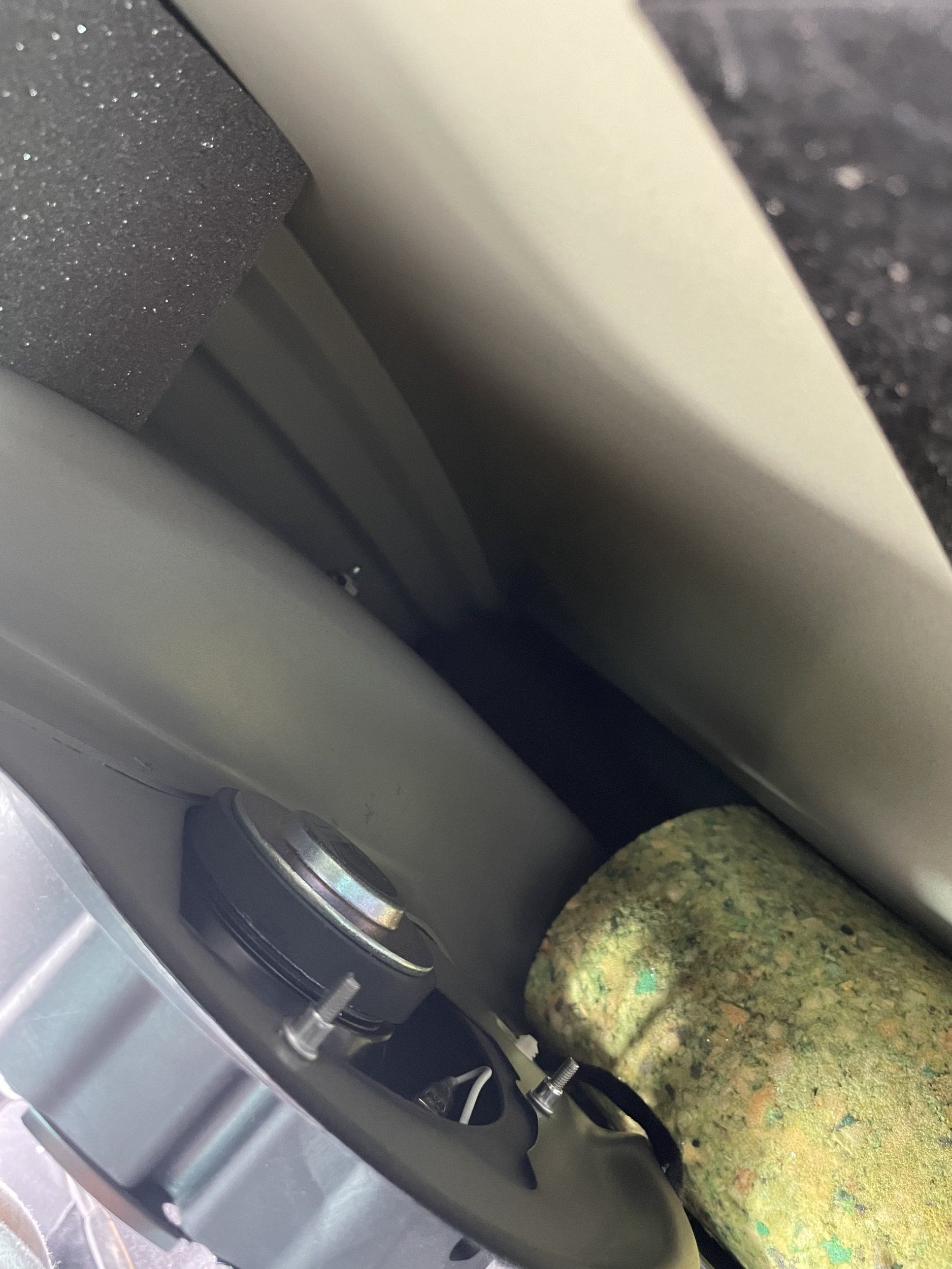

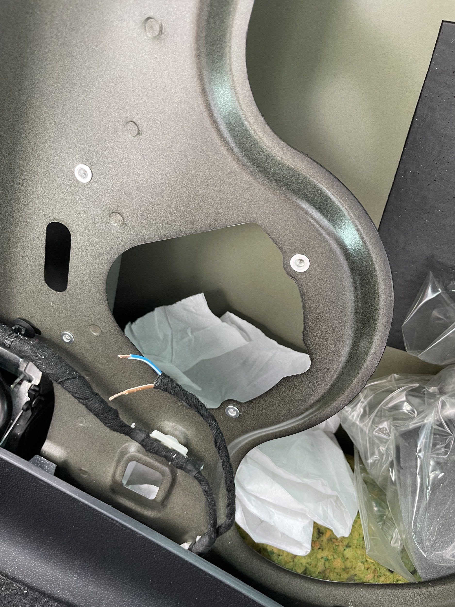

Part 2 of the Rear Speaker install:

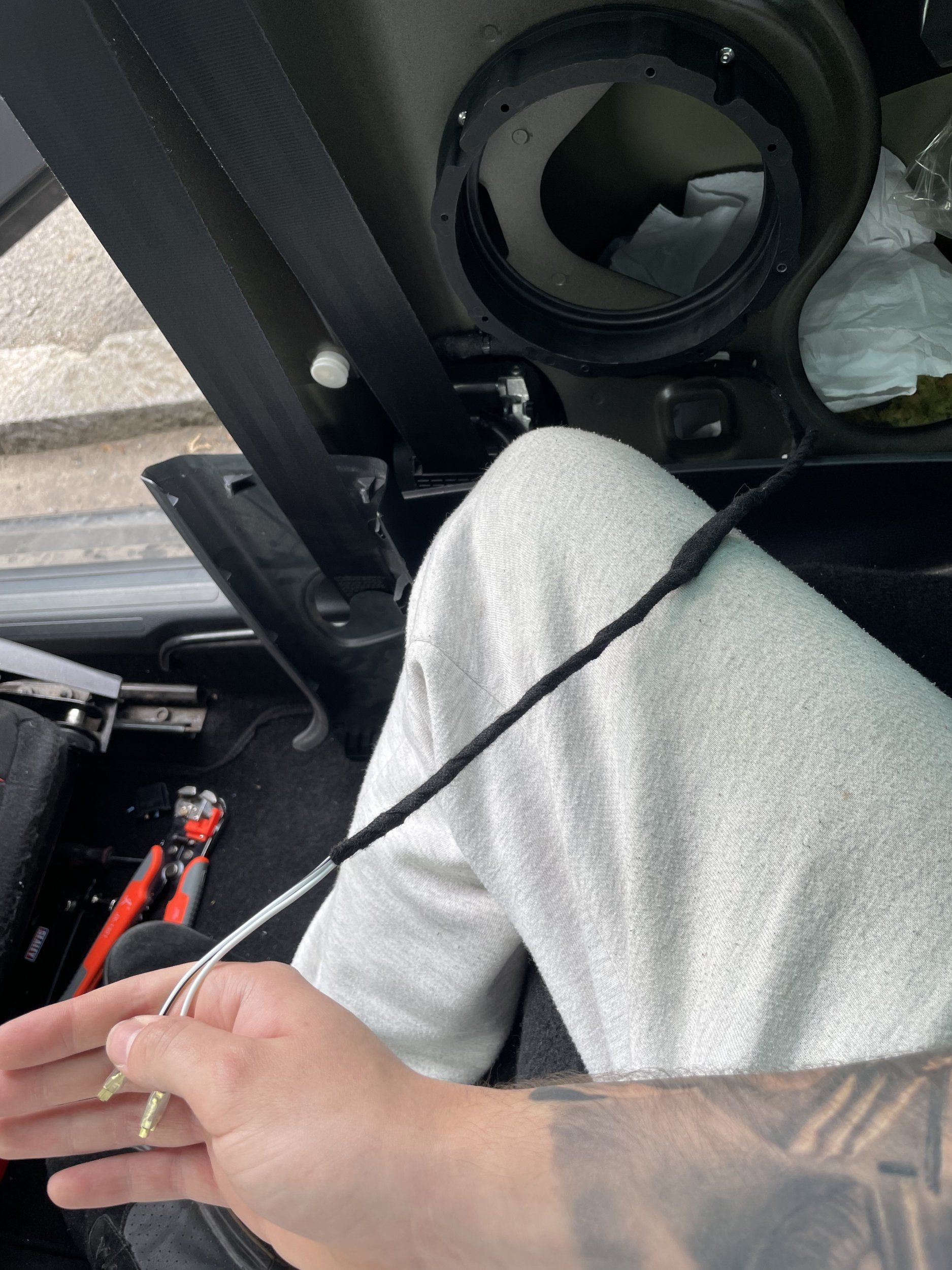

OEM speaker removed, drilled out rivets and open up to allow rivnuts in. Connector cut off.
Wires spliced, and adaptor bolted up.
Tesa tape for oem+ points.
View from behind showing rivnut installation.
Speaker attached and wiring rerouted.
All tested before putting panels back on,
and success😁

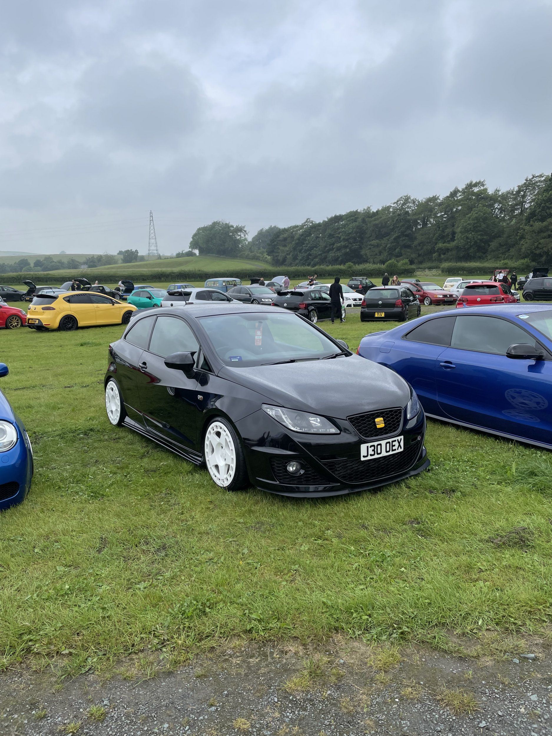

- Had a busy few weeks recently. Attended Cumbriavag/first proper show since the pandemic started. And had a lot of prep to do before then and
not leaving myself much time to do it.
- Finally got the whole front end painted along with the rear bumper, getting rid of the stone chips and lacquer peel.
- BC Racing coilovers finally went on, along with Powerflex -10mm top mounts.
- Day before leaving was 4 new Falken tyres and an alignment to make sure everything was good. Opted to go for a 195/40/17 tyre instead of the previous 205/40/17 and feel the new size really changes the way the wheels look.
- 2xcite headlights fitted, wanted to change it up a bit and quite liked the look of these especially installed on a black car.
- Cumbriavag ended up being a good night/day, didn’t stay as long as I had hoped though, but a few hours in the Show and Shine was nice after all the work that’s went in over the years.
