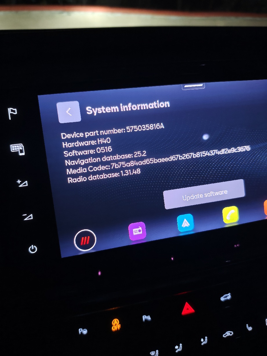

Anyway, I downloaded the latest published version, unzipped it onto an external drive that has an activity LED to show me if there's a reading going on, connected it to a USB port on the front center console and started waiting. The LED kept blinking for a couple of minutes and then stopped. I waited for an additional hour that passed with a couple of occasional blinks, then got bored, turned the ignition off & on, opened the system information screen, and voila! The latest update was there, as shown by the photo below.
An interesting note: The usual size of the Turkish map update files is around 1.7 Gb and 23.12 update was in line with that. This time, the downloaded file of 24.6 update was 20Gb but the update process seemed to take only five minutes. It probably copied only changed files, hence the quick update. But then again, why include all the map files for an update? Maybe they offer full package with the first update of the year, and only the changed files with the second. That's the only explanation I could think of.
