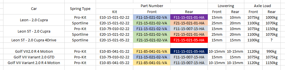

These are the kits when I was researching...

I’m getting my Eibach Sportlines fitted on Tuesday :)

Does anyone know is there much difference in stiffness between the ProKit and Sportlines? Or is it simply just a greater drop?
I wanted the Pro kit due to how much it lowers by (25mm). But having the 4drive I was confused by the lack of pro kit, and the fact the Sportline lowers by only 15mm.
So I asked that question to eibach US directly and didn’t get a reply. So messages eibach UK and this is what they said...
“Hi Damian. I think I can see the issue here. We don't list a kit for the Cupra 4Drive as it doesn't offer anything over and above the OE setup, The 4Drive is lower and firmer from the factory, than the 2WD hence why the quoted lowering is greater for the 2WD model. Your investigation has come to the only spring kit we offer for your car, kit E20-15-021-05-22. The Sportline kit is firmer than the Pro-Kit by around 15% so not a huge amount.
For your info the Golf R Estate Pro Kit is a similar rate (around 5% difference) to the Sportline kit for your car. Whilst the Pro Kit would fit your car physically, it would not sit or work correctly as the dampers are different to yours.
We hope this helps.”
