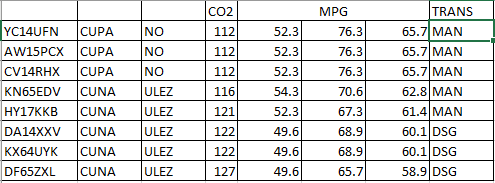

Further research on CUPA-CUNA from my 'small' sample of cars for sale on autotrader:
ALL DSG's have CUNA engine which is ULEZ compliant and has VVT
early 2015 MAN cars are CUPA which are NOT ULEZ compliant and do NOT have VVT
later 2015 MAN cars are CUNA which are ULEZ compliant and DO have VVT
CUPA = NO VVT
CUNA = VVT + additional EGR
Edit:
Just to add it looks like all Golf GTD's have the CUNA engine which = ULEZ + VVT
Octavia looks to follow the Leon regarding CUPA/CUNA, but I also found an early 2014 Octavia with DSG AND CUPA engine - so maybe there are early Leons with DSG and CUPA engine - just weren't any on autotrader!
