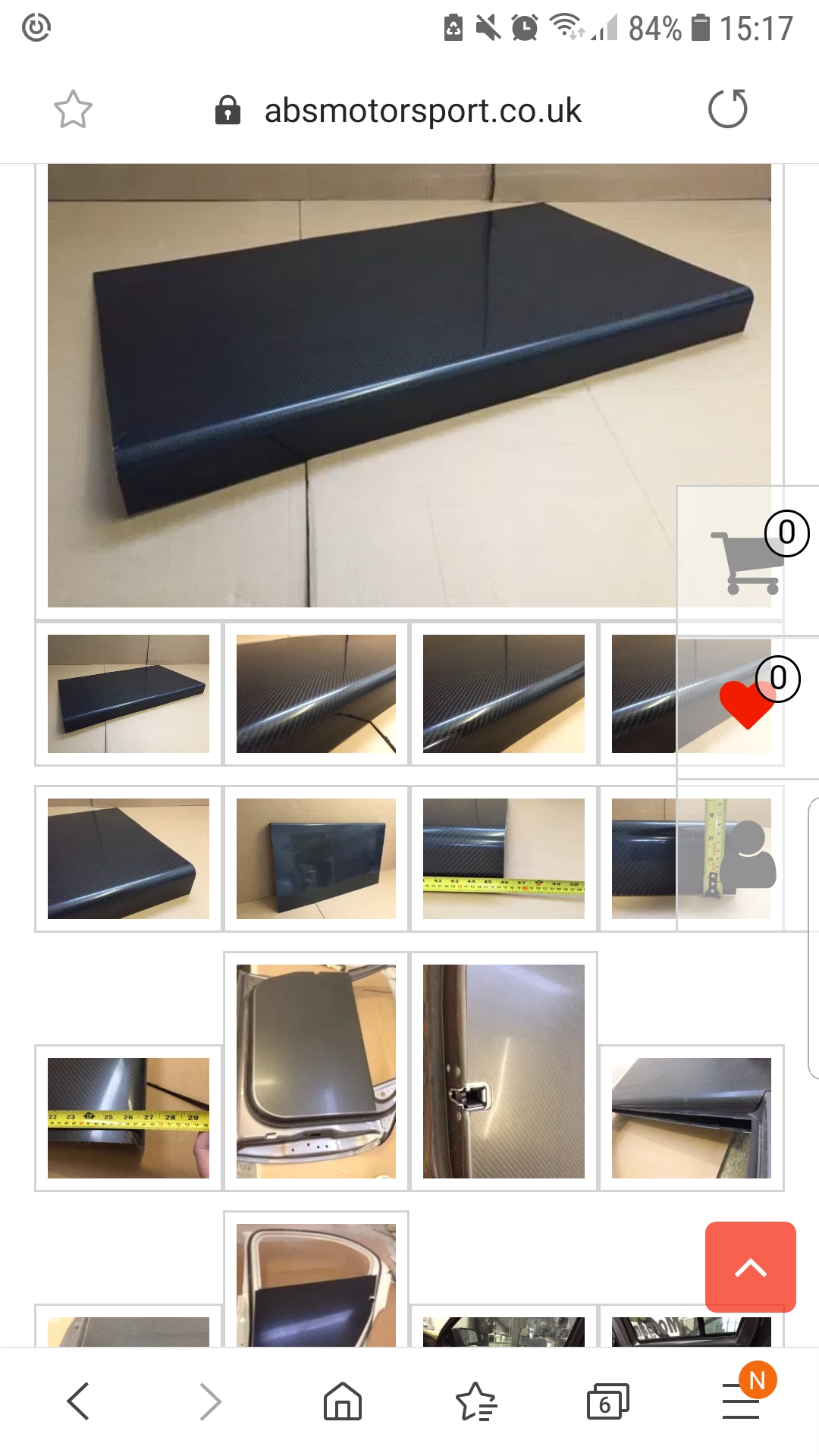

Leon20vt4
Oct 21, 2018
939
683
I like these. But they weigh something. Plus with my open door I’ve got space for all my snacks for the drive to the ring because there’s no other places ha ha
Hahahaha yes ******* snack pockets I love it!
Manic172
Dec 4, 2018
1,447
1,580
Hemel hempstead
www.seatcupra.net
Personally I would cover them or cover the sharp edges due to any accidents or even slides in to gravel etc your arms flap about and with doors open like that you are able to cut your arm.
I would fit them the weight they would add with ally pop rivits is about the same as taking a good ****.
Yes I have some rayrim edge protection I can apply which will grip the edges and stay on but I’ve been looking for some door covers actually
