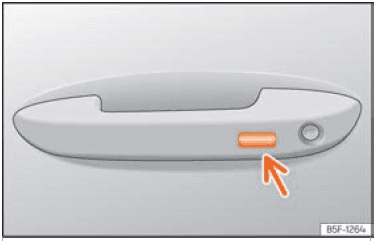

I think you may be using the incorrect sequence to temporarily disable keyless access. On my VW which works the same as it does on Seats, you need to press the ‘lock‘ button on the key fob first and then touch the locking sensor on the door handle. If the sensor it touched first, followed by pressing the ‘lock‘ button on the key fob, keyless access isn’t disabled and it’s possible on my VW to open the car by just making contact with the ‘unlock’ sensor on the door handle - assume this is also the case with Seat‘s keyless access system.
Below is the section from the mk4 Leon owner’s manual on temporarily disabling keyless access. It does state the locking button on the key fob is the first action, followed by touching the locking sensor (third point below);
‘Keyless Access temporary disconnection function
You can deactivate the vehicle's Keyless Access unlocking for one locking and unlocking cycle.
  • Move the gear lever to position P (if the vehicle has automatic gearbox), since otherwise the vehicle cannot be locked.
  • Close the door.
  • Push the central locking button on the remote control and touch the locking sensor surface of the driver door handle within the following 5 seconds. Do not grasp the door handle; otherwise the vehicle will not unlock. Deactivation is also possible if the vehicle is locked through the driver’s door lock.
  • To check that the function has been deactivated, wait at least 10 seconds, grip and pull on the door handle. The door should not open.’

Last days KESSY stopped working for me. Lock works, but not unlock.
Changed the battery in the key without any luck.

Same for me, below 0 centigrade unlocking doesn’t work. If the handle is little wet or have some snow makes it worse.
-10 and locking stops working too.

There have been Kessy issues reported on the board with the Leon 4 a while back. They didn't seem to be related to cold weather thou which we don't really get in the UK. I get the impression they were software issues which subsequently got fixed. The door left or right was going to sleep. As described at the time it sounded like the battery saving feature in Kessy that puts to sleep one side of the car, left door handle in a right hand drive car, to save the battery had been set up on the wrong side for RHD delivery. Drivers couldn't get in. Sleep mode shouldn't be activated on all doors if the battery is deemed to be getting low. You might be experiencing that one with the cold weather causing poor battery performance.... just a thought. I don't think this one has come up on UK cars recently but I might be proved wrong. Those people with the issue had it fixed.

The manual says that KESSY deactivates when it detects too much activity on the handle (e.g. a branch hitting the handle in the wind).
For example, at a car wash, water can open and close my car. So I suspect that the same happens during rain/snow, but due to the lack of a key near the car, the car does not open, but the activity on the handle is registered - this causes its deactivation.
