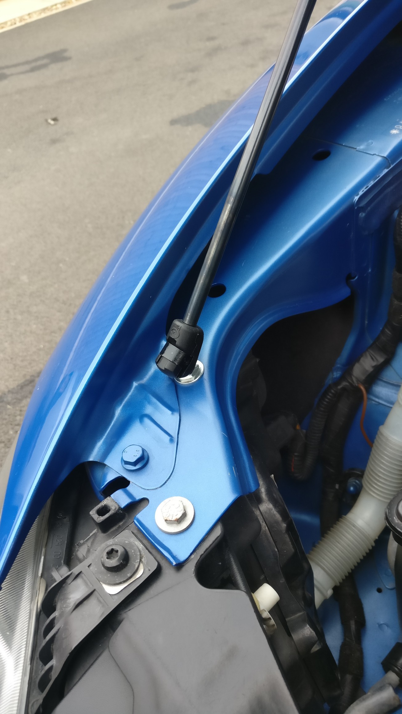

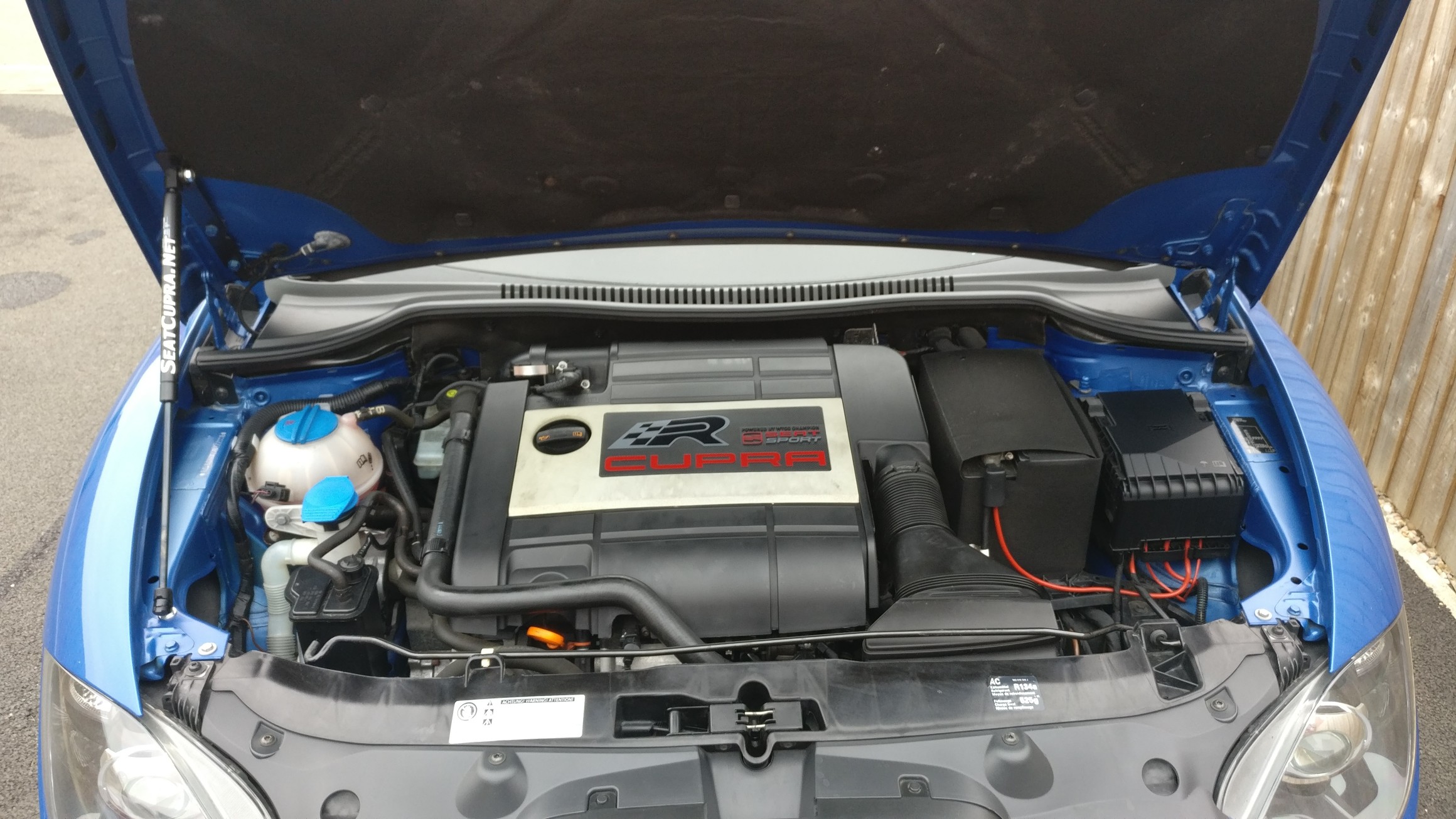

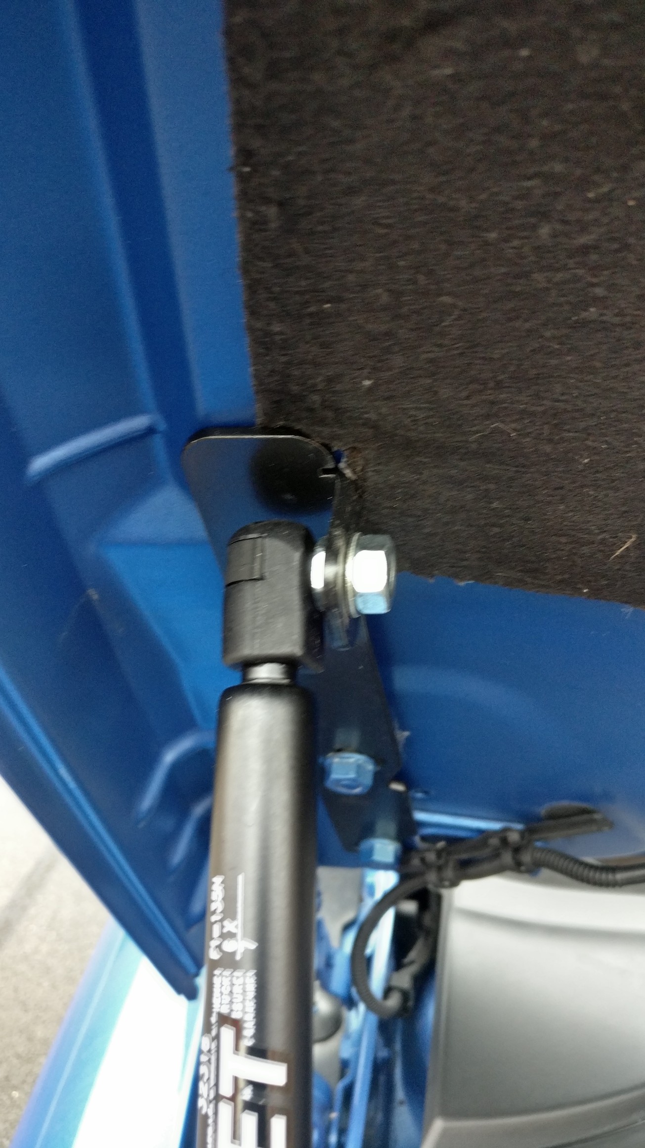

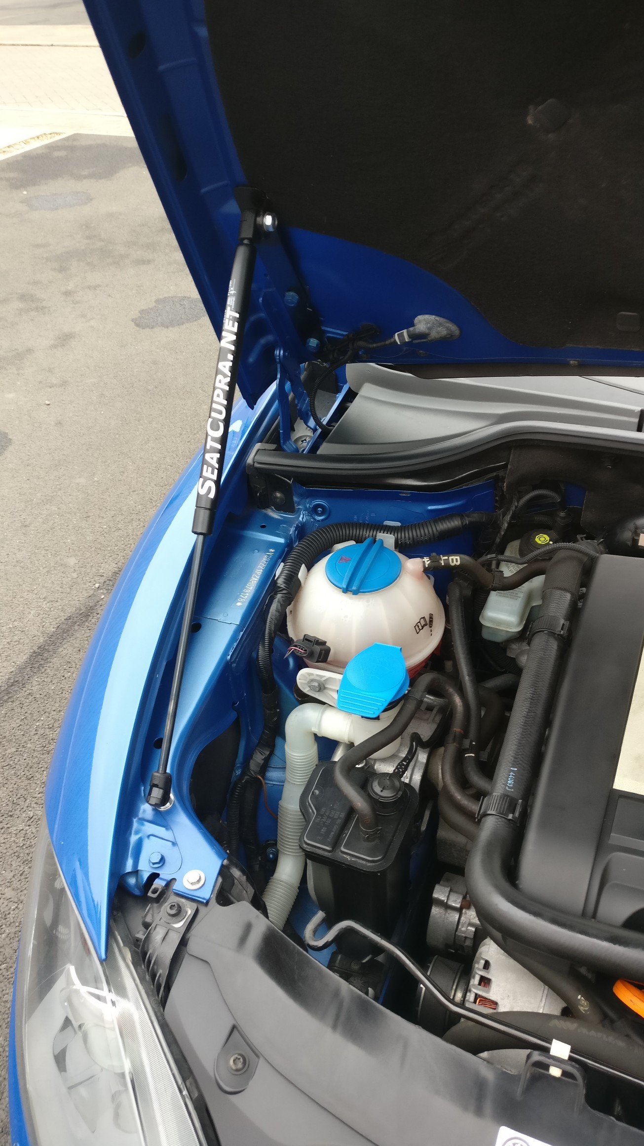

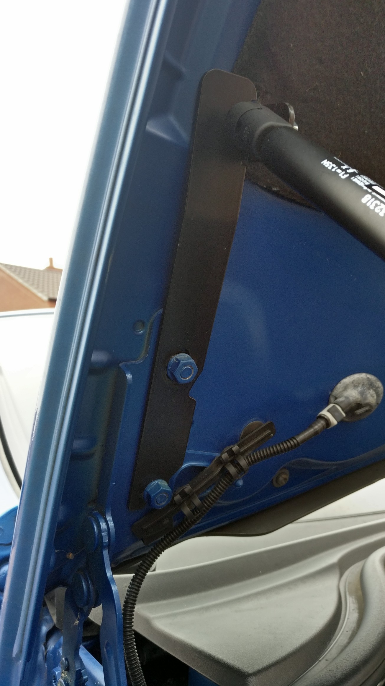

It seems the gas bonnet strut mod is very easy to do and works very well. I can do a very short guide later on but it's so simple I don't think it needs one...
Undo 2 bolts on the bonnet, place new bracket on (of you have bonnet insulation you need to take out the plastic punch as the bracket goes over it) , put bolts back on, place strut screw in hole and bolt on, bolt 2nd strut screw in empty hole on engine bay, place gas strut on mounts.
Quick video of shutting... I only put on 1 strut as the boot stays up but closes under its own pressure which is perfect, no wind today to test it though.

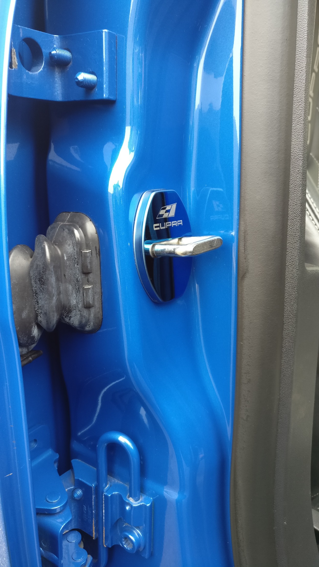

Door shut covers

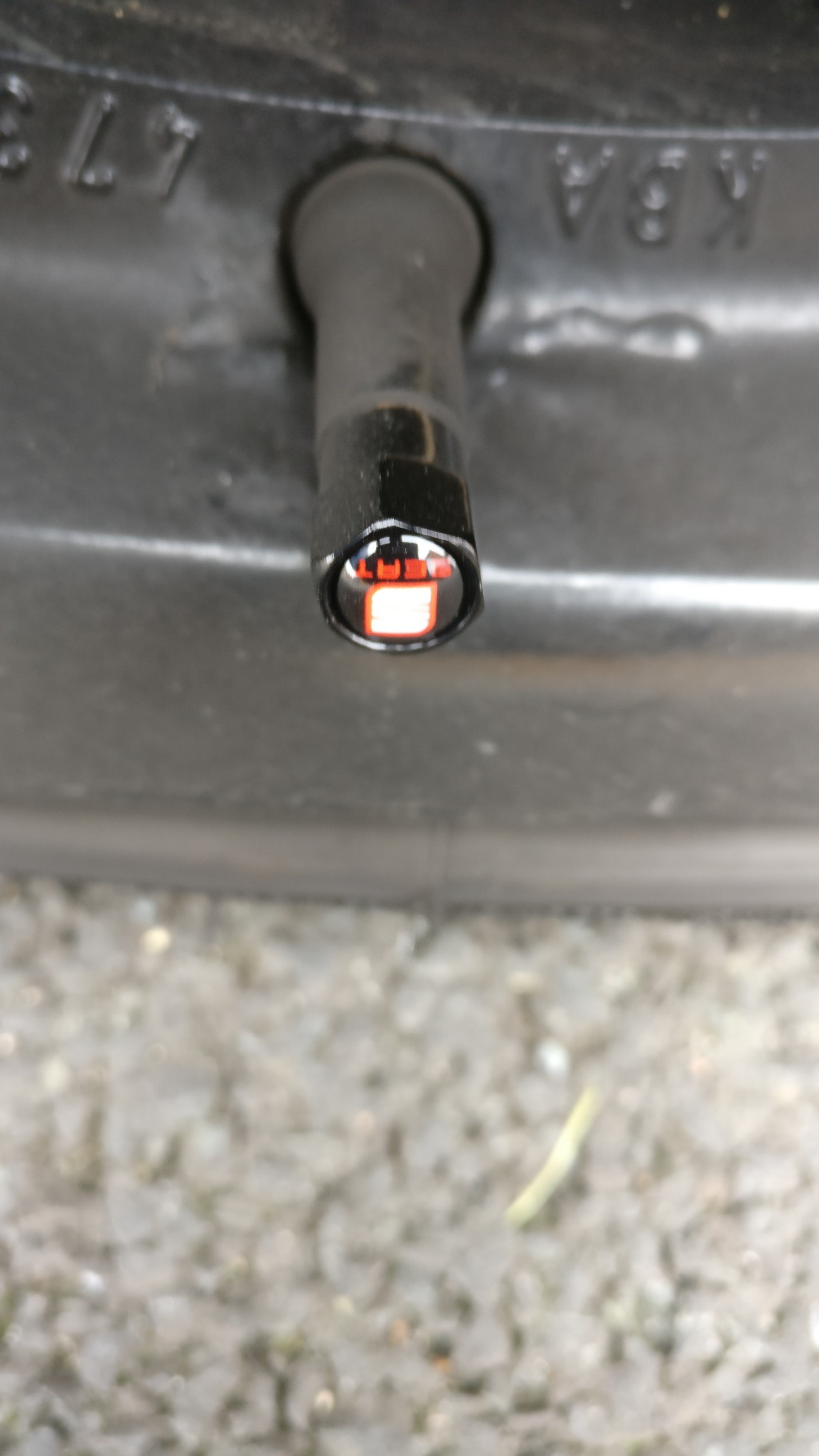

Tyre dust caps

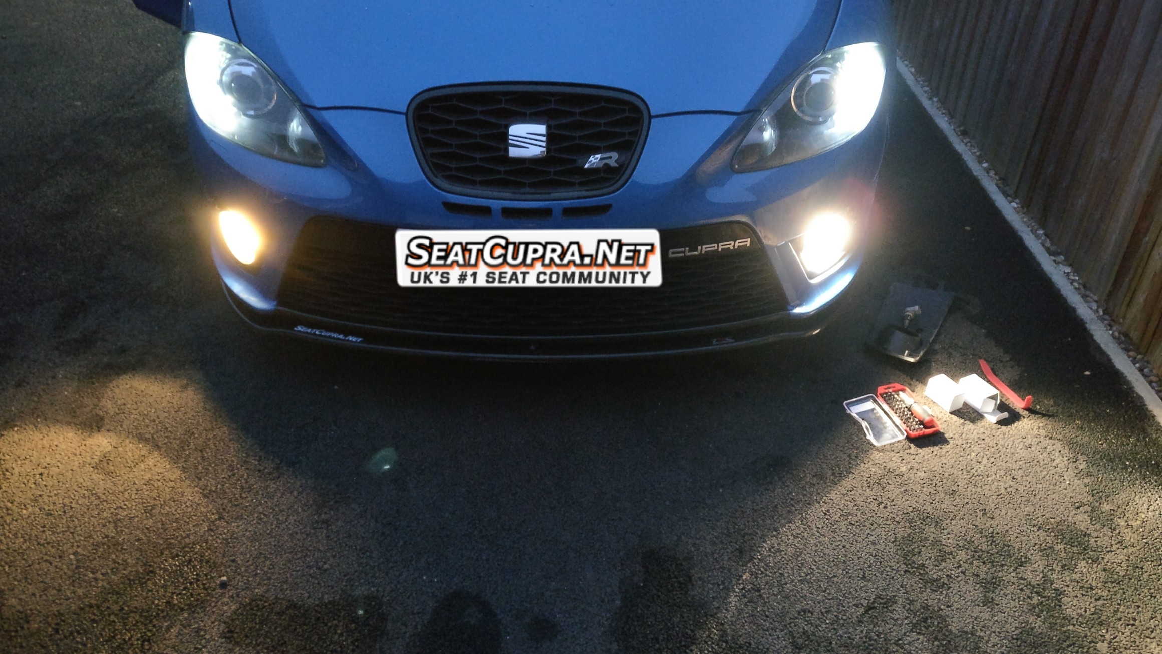

New fog lights that are a little whiter than the rubbish yellow ones

Looking good but is it me but should the gas strut be the other way round lol
I know I know that’s how it should be but does not look right
love the seat cupra sticker on it and like the door shut cupra caps
I thought that but the angle bit is on the thin end and the instructions also confirm this way round lol

The struts are quite stiff aint they , if you put both on itd be a workout closing the bonnet would be a workout lol
leon mk1 cupra
Yeah I think with 2 it wouldn't drop by itself so good call. Seems like a pretty good kit, I'll try it after a freezing cold night and see how it performs the next few days. I don't open the bonnet much so it's there to please me lol
Now all you need is a remote for it! That does look pretty cool! I would also worry with 2 on that in summer, you know when you can't shut the boot cause the gas struts are hot? Wonder if it'd blow the bonnet open LOL. So does it open by itself if it goes past a point?
Yeah summer does make things work a little too well haha
The way it's done means that it can only push up once it gets passed half way I think but I don't think it has enough strength to open it by itself but I will check in the morning and do a video of opening lol id does keep it up though although I no wind today so thats the next test.
Yeah, the back of my head wants you to be 100% sure on this. As I'm sick of having it cracked in. But I'm also willing to trade for this near new kit we use in the work shop for auto-opening bonnets! It's only ever let me down a handful of times. Maybe two handfuls.
