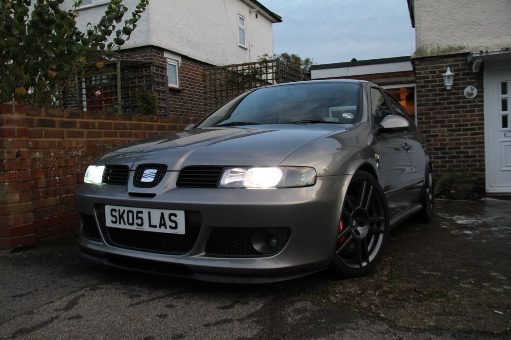

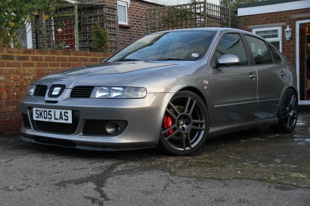

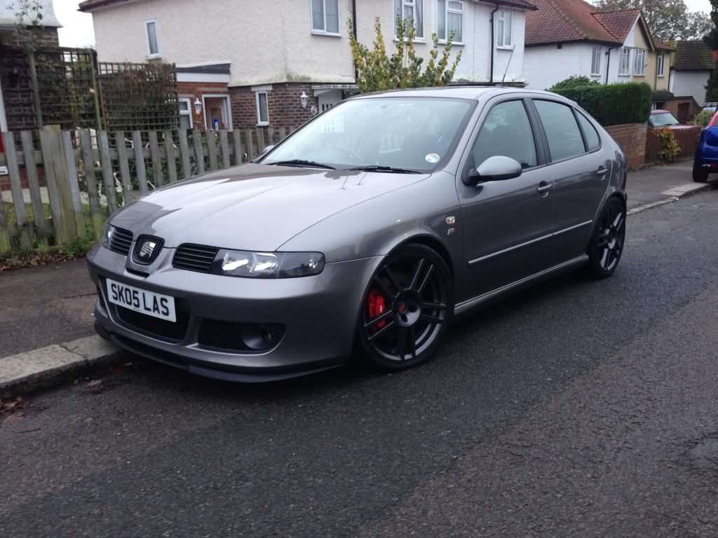

introducing my LCR. it had only 59000 miles on it and a stage 1 re map. ( the only picture i have of it in its original form)
this is the LCR in its current state.
My plans for my LCR were to keep it standard, but after the rods failed i've slowly started upgrading the parts that have failed.
Hope you enjoy my progress, pictures and updates. leave feedback good or bad.

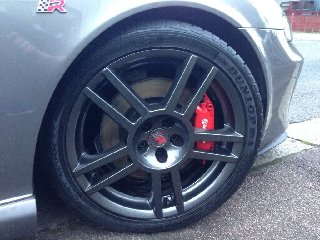

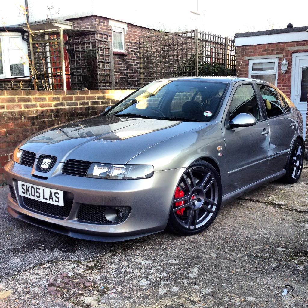

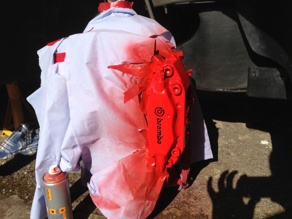

After i had sprayed the brembos cadbury purple i kind of missed the red that popped out of the wheels so eventually i went back and sprayed them red.

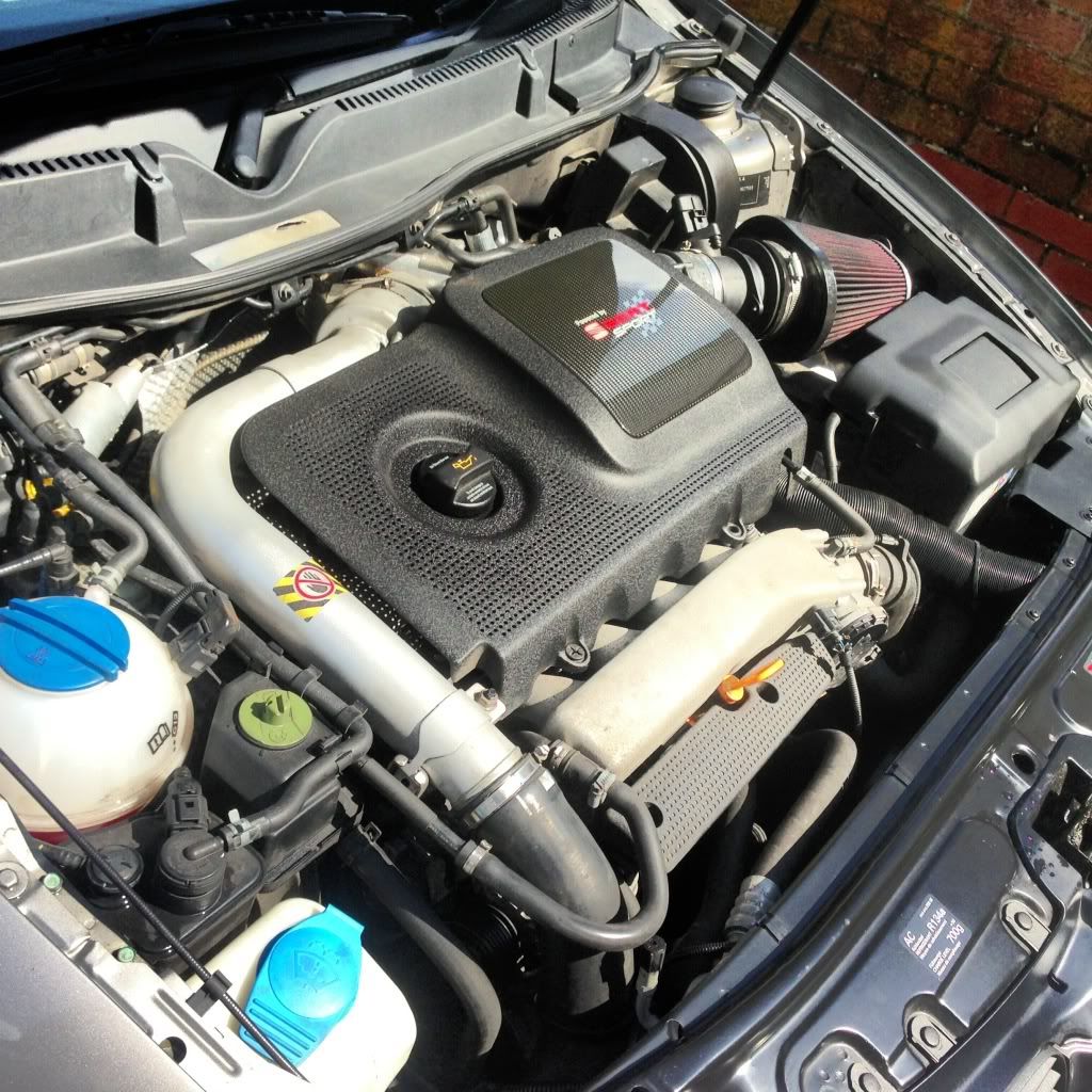

Gave the engine bay a valet and put on my forge 007p DV and K&N open cone. additionally taking off the sound proofing from the bonnet so i could her my DV better.

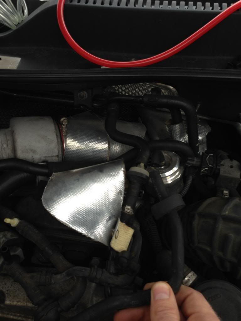

N249 bypass and boost gauge installation
This is the first time i'm attempting both jobs but with help from the guides i got it done. I know it's been covered a lot but thought i'd record my version.

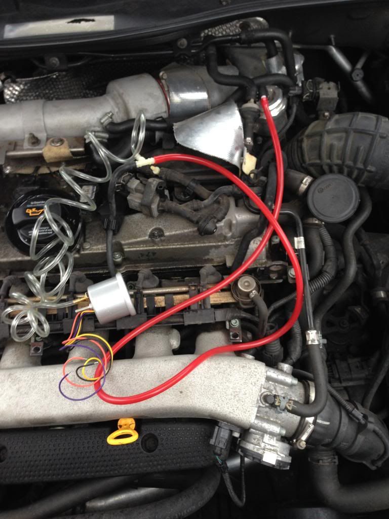

This is how my engine bay looked to begin. Very standard looking...
step 1. Cut pipe on top of DV.

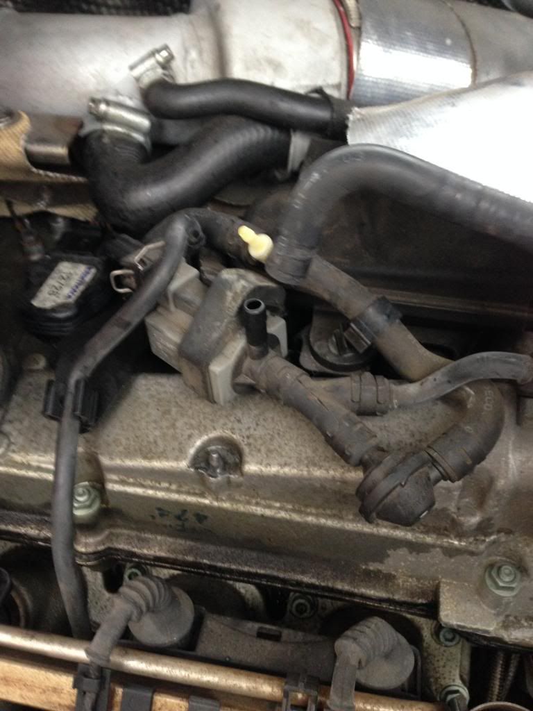

Step 2. Disconnet the two pipes from the N249 as shown on the pic below. i'll be joining the pipe that came off the white T piece directly to the DV.

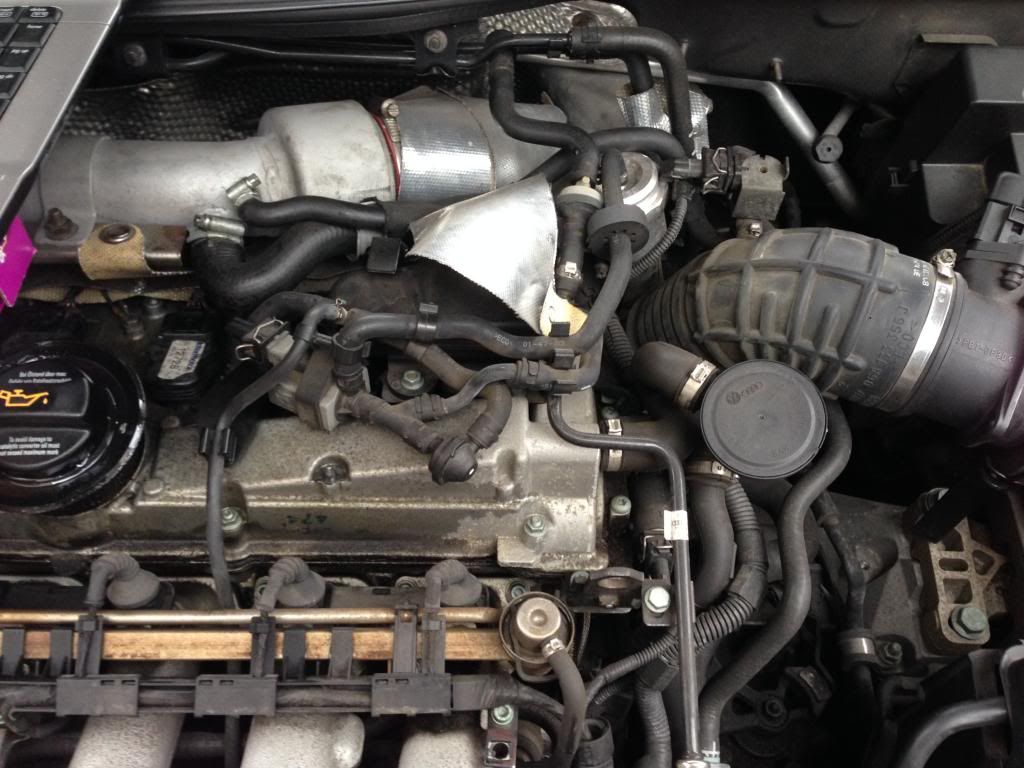

Step 3. Grab your 4mm silicone pipe and connect the smaller pipe you took from the N249 to the DV. Ignore the fact i had my boost gauge added in. i was testing it,
That is the N249 bypass done. I've read that you should not cap the hose connectors left open; apparently it'll have adverse effects.
I did cut the hose down a little and also moved the T piece for my boost gauge DV side...
I've not driven or it hard enough to discover any benefits as yet due to the wet conditions. People have said you can feel better response, a little louder DV noise and in some cases extra BHP.:)

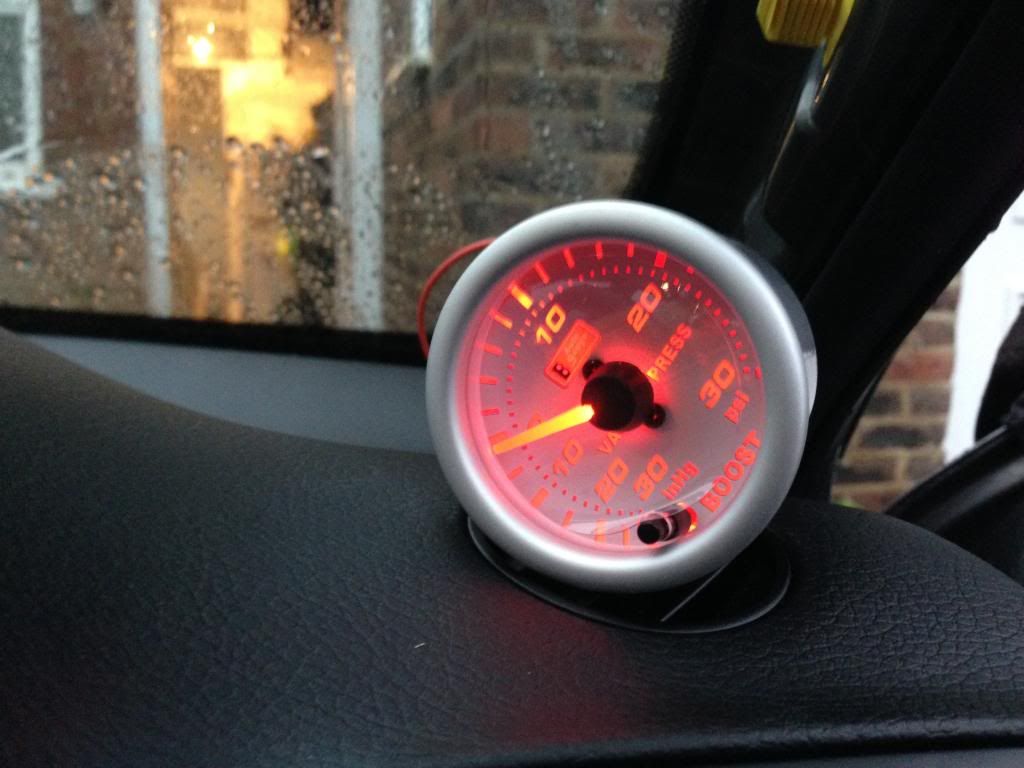

Boost gauge.
Still waiting on my Gauge pod to arrive so for now its just chillin on the dash.
Looks very untidy so i'll be cursing everyday the post man doesnt post my gauge pod...

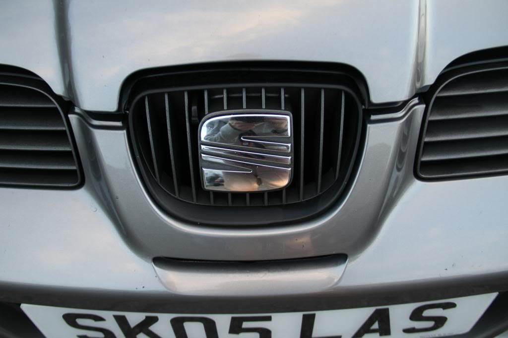

Managed to get the time to spray part of the grille that i didnt appreciate being silver..
Not sure whether to carbon wrap the S badge. either that or spray it matt black orrrr just keep it silver ? lol i think idle spray cans are the devil. makes you look for things to spray!

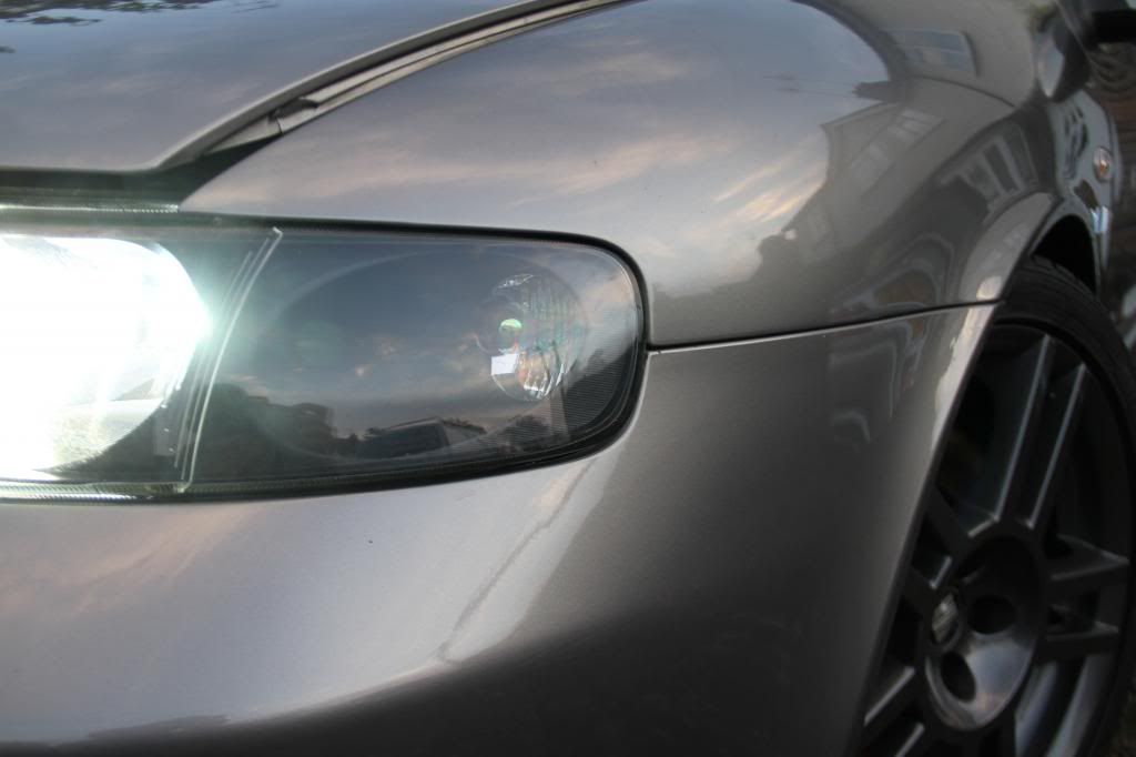

Also fitted the 6k HIDs. Which i'm fairly happy with.

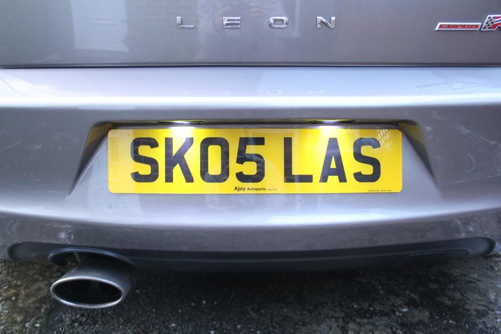

Got the white number plate bulbs too, which i've had a nightmare with. They keep blowing for some reason so the ebay seller sent me a pack of 10 for free :)

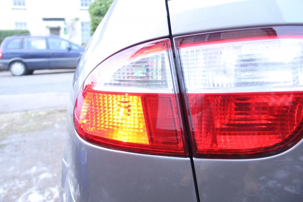

diadem indicator bulbs all round...
the car looking clean and sparkly. which is rare with this bad weather.

that number plate almost looks personalised not that it really reads anything though.
Thanks mate, appreciate your kind words. i actually dislike my Reg quite a lot. i think it's quite an ugly arrangement of letters and numbers , despite how weird that sounds ! i've asked for some 3/4 sized number plates for xmas. Hoping it will improve this issue . :think:

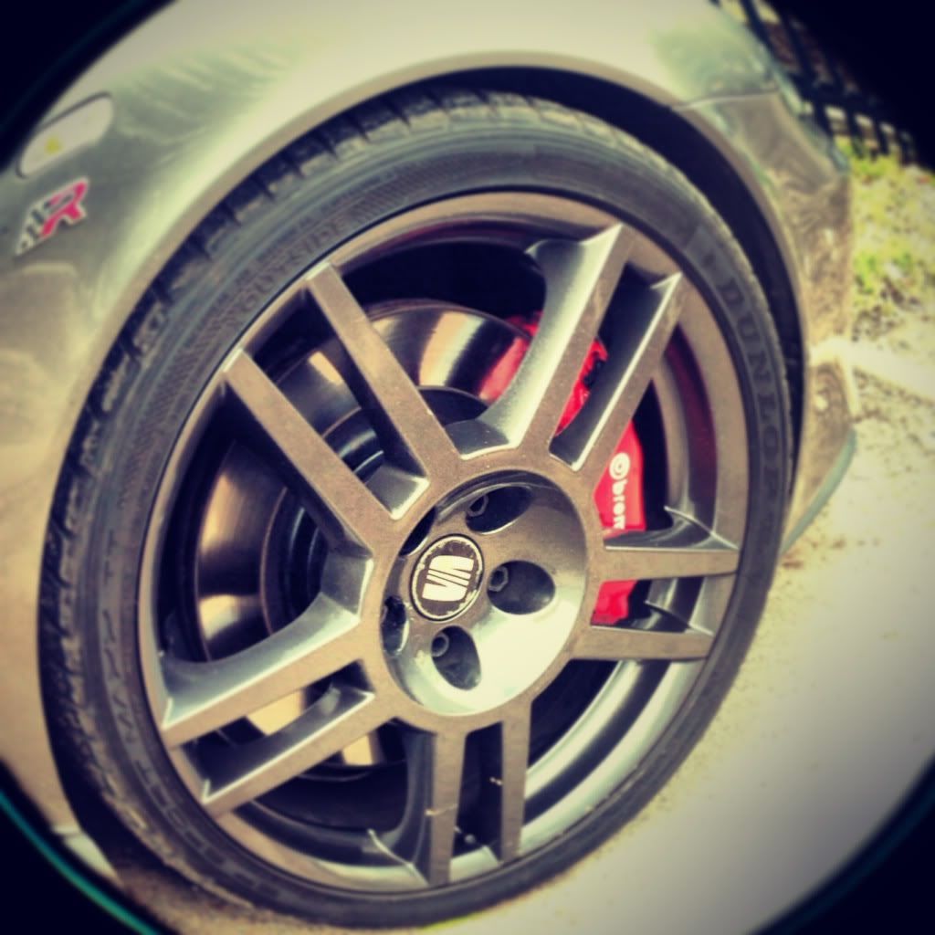

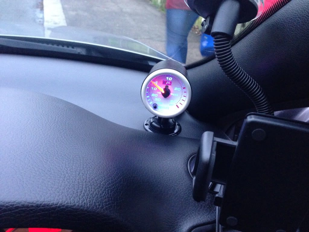

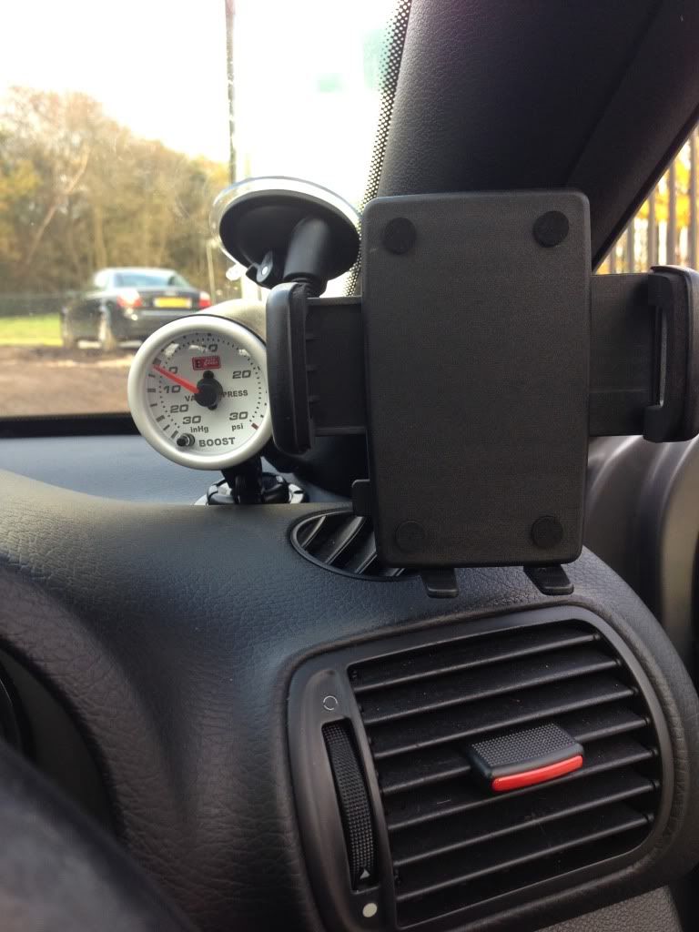

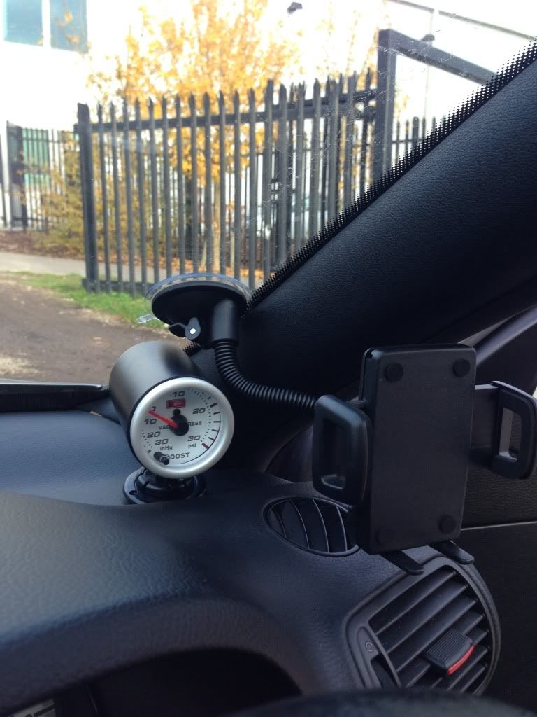

Quick update, just received my gauge pod. I've also ordered a obd wifi sender for a cool iphone app of which I'll review (thanks mjstokes85 for the inspiration ). Also ordered wheel centre caps .
I downloaded a fish eye app , thinks it's pretty cool . Check it out.

Spent the best part of today do little bits and bobs to the car. I fixed the boot light as it had snapped, replaced the bulb for an LED jobbie. Looks smart.

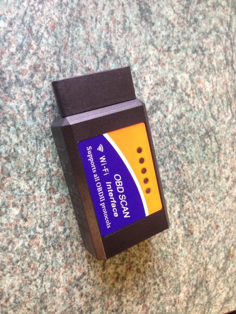

Also My shinny new wheel centre caps arrived today and the OBD port sender arrived too.
Got a few apps running that work with it. Need some time to fiddle around but so far very impressed with the information transferred to the phone. Only problem is that the boost doesn't seem to be updating when I'm driving along.
Wheel caps...
Fixed the gauge in to place..

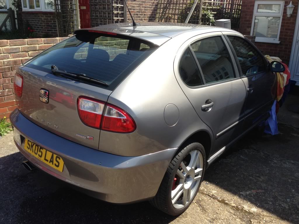

Also spent a few hours waxing the car as it happened to be decent weather.
Not sure this picture gives it justice. We are missing the sun!
