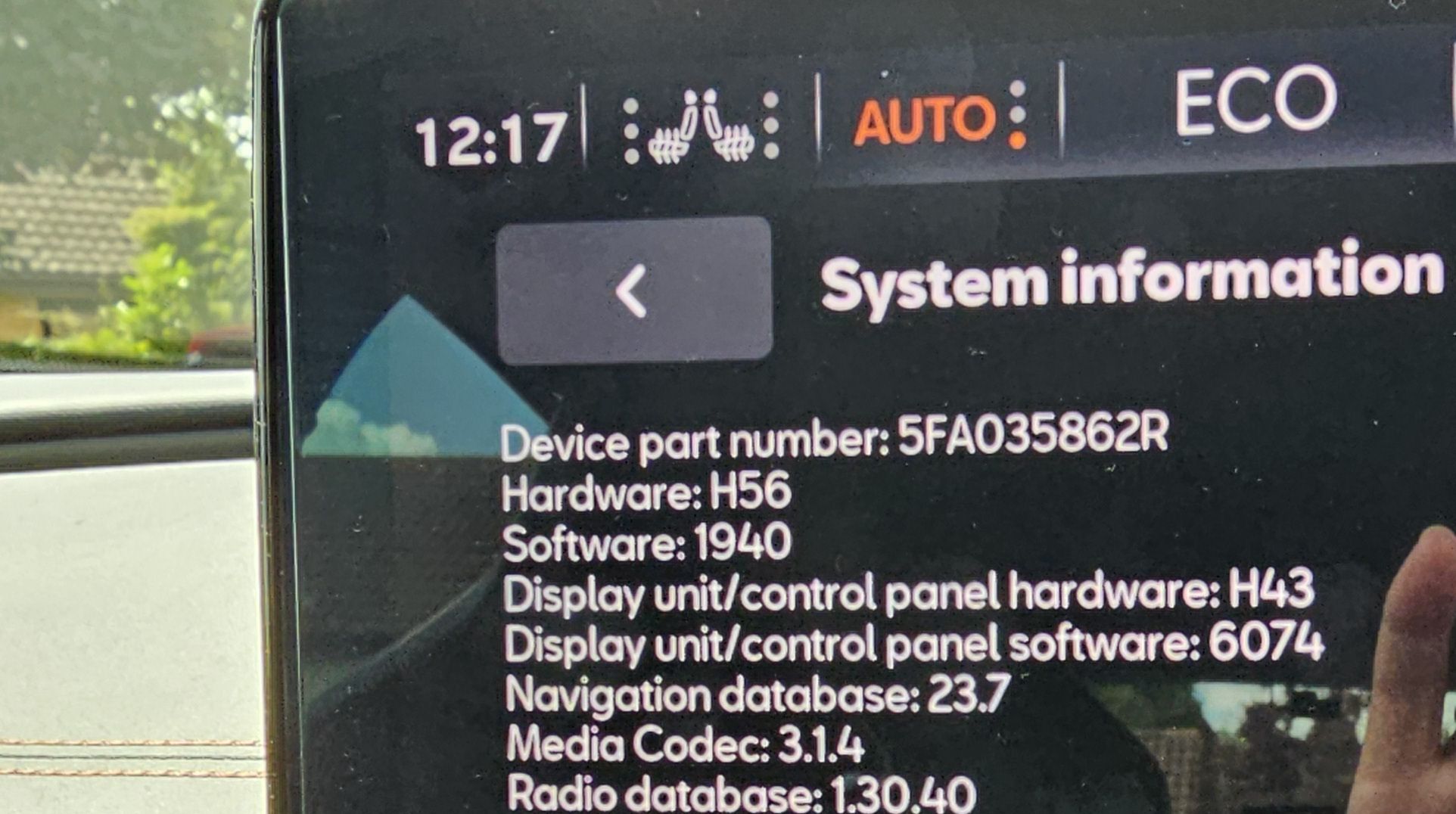

How do i check firmware version? Anyone had any luck with taking it to the dealer to get infotainment looked at?
Mines is constantly crashing every other car journey....usually within 30 seconds of setting off. Once it reboots then it usually stays fine for rest of journey.
Also how do you turn off voice recognition? if i have conversations in car, then the infotainment thinks i am requesting something. Every time.
If you open up your home screen so you see all the apps, scroll to settings (Looks like a cog) and you should see it listed there

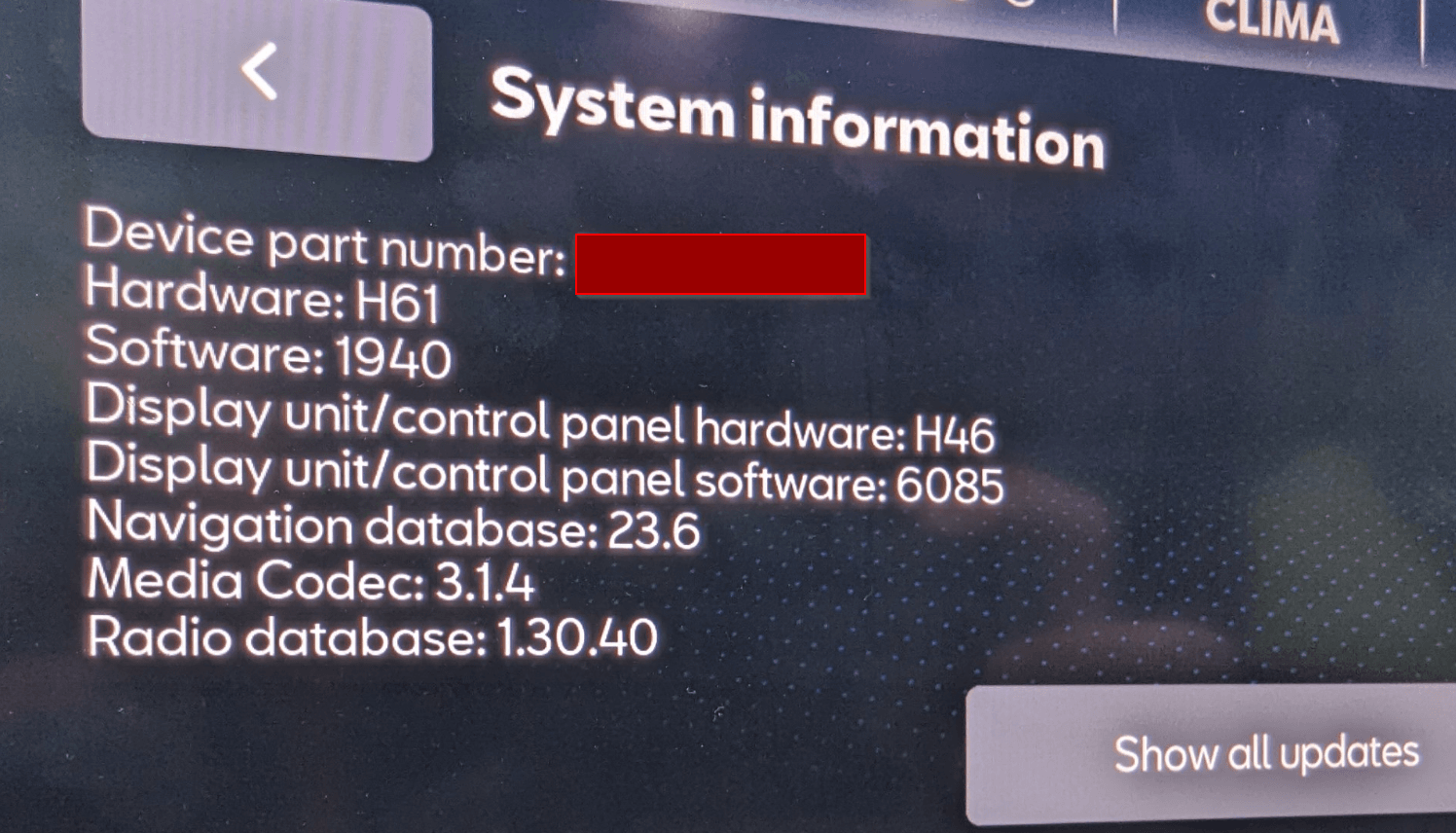

Good news. What software version have you been given?
Jun 25, 2023
Ended up on version 1940 i think.
Funny thing is, that the there is a new update available now, that i can download in the background - not sure if i want to do that.

Told my sales person the car was on 1899 and asked for it to be updated beforehand, only to be be told it's "already on the latest version", "1940 was for eHybrid", not the VZ2.
Patently untrue. I had my VZ2 updated to 1940 by Snows in Portsmouth just a few weeks back. Much happier.
