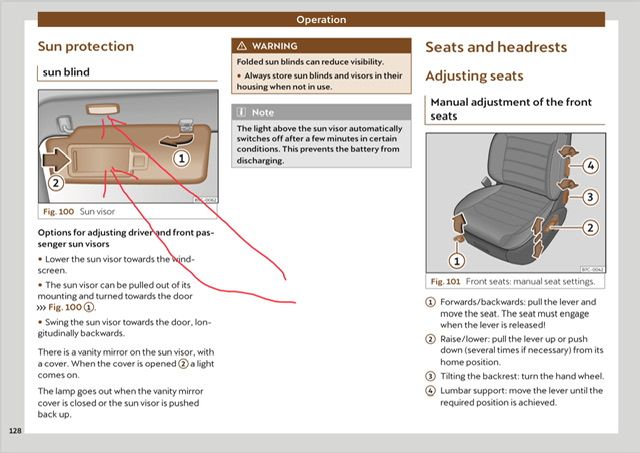

As for the cause of your rattle noise; I suspect it’s the hard plastic cover over the vanity mirror making contact with vanity mirror light and one vibrating against the other when the sun visor isn’t being used and it’s folded away against the roof lining. There have been quite a few instances of this specific unwanted interior noise source with the VW Golf reported on forums.
Screenshot below is from the Formentor owner’s manual that shows the position of the vanity light relative to the vanity mirror cover;
