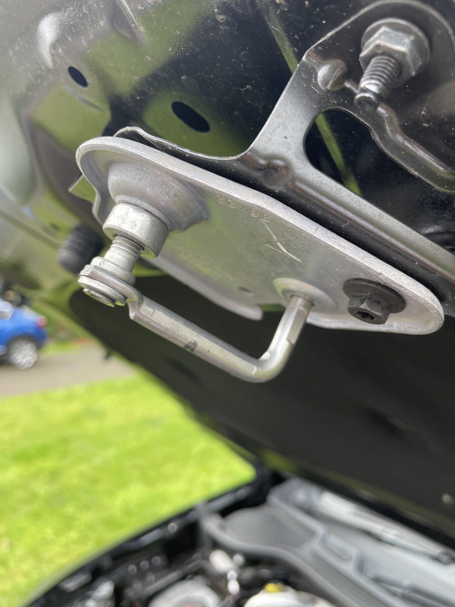

Yup i have this exact issue, it definitely originates from the bonnet hinge on the passenger side for me and you can test it by hitting the bonnet with your palm near the front corner with the bonnet closed which generates the noise. I also found that the silver loops that secure the bonnet into the catches were loose on the passenger side and the rear of them is floating metal on metal which seemed bizarre. A combination of tightening them, adding some duct tape around the metal on metal end plus greasing the offending hinge appears to have stopped the issue on the driveway. I am yet to take it for a drive yet though. I couldn't find any loose bolts on the hinge itself..My theory if this works on the road is that the bonnet wasn't being pulled down tight enough at the front and therefore not exerting enough upward force against the hinge at the rear. 🤷‍♂️

Update, seems to have resolved the issue. Glad I didn't have to take the door card off 👍🏼

Hi , im facing the same issue , our delearship did not find the issue , could you please give me more info ??

check the piece of metal in the photo above and see if it rattle when flicked / hit. Its responsible for how much the bonnet is pulled down when closed. I put some duct tape round it but i also tightened it so the bonnet was pulled down harder.
is any photo of the duct tape on bonnet hidge to do the same ?? Please !
