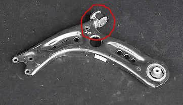

Just to note:
Any bush that's horizontal needs to be torqued up when the vehicle's at normal ride height - If torqued up when the wishbone is fully extended in droop will wind the bush up. Not sure this will contribute much to your hard ride?
