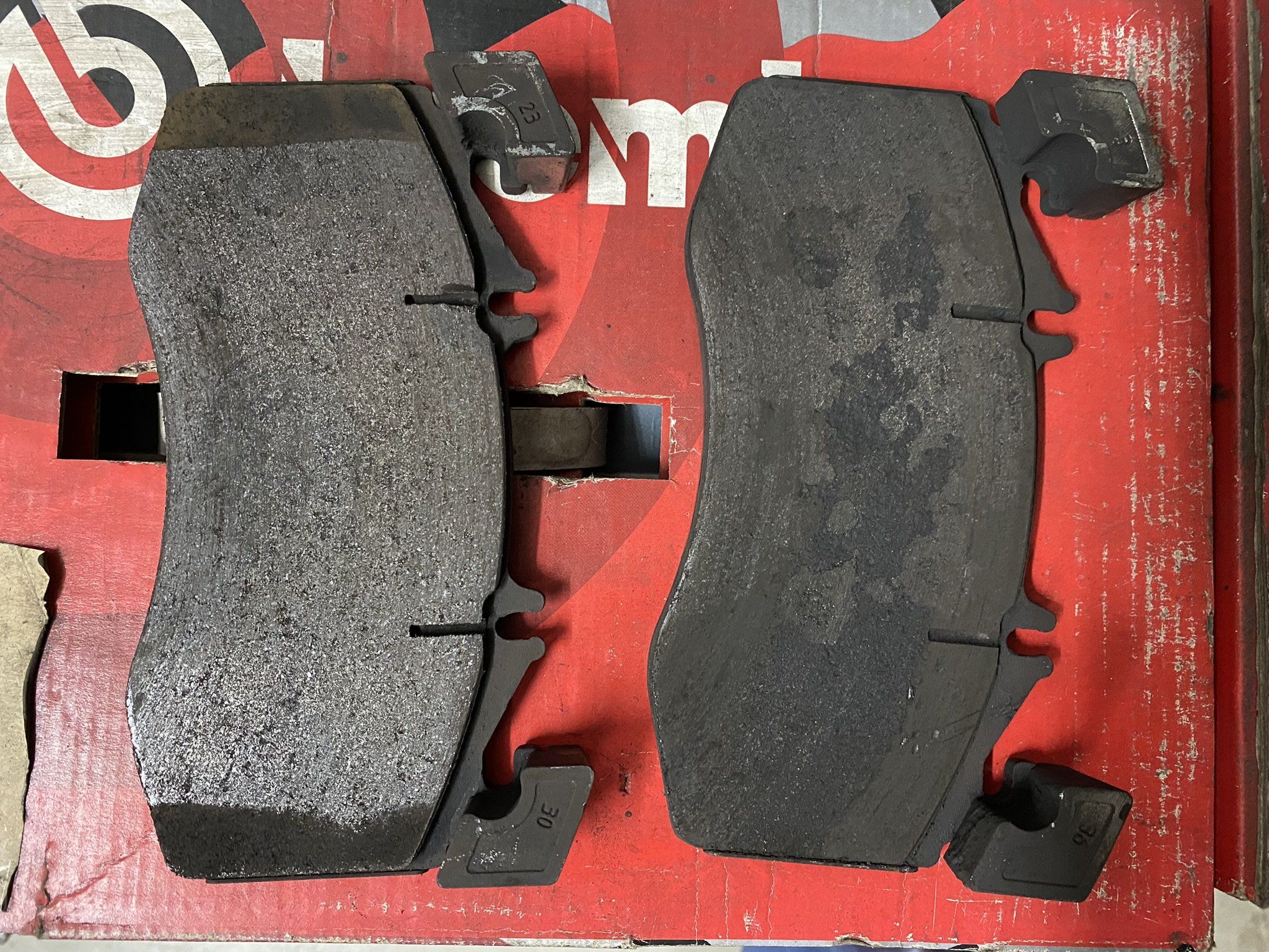

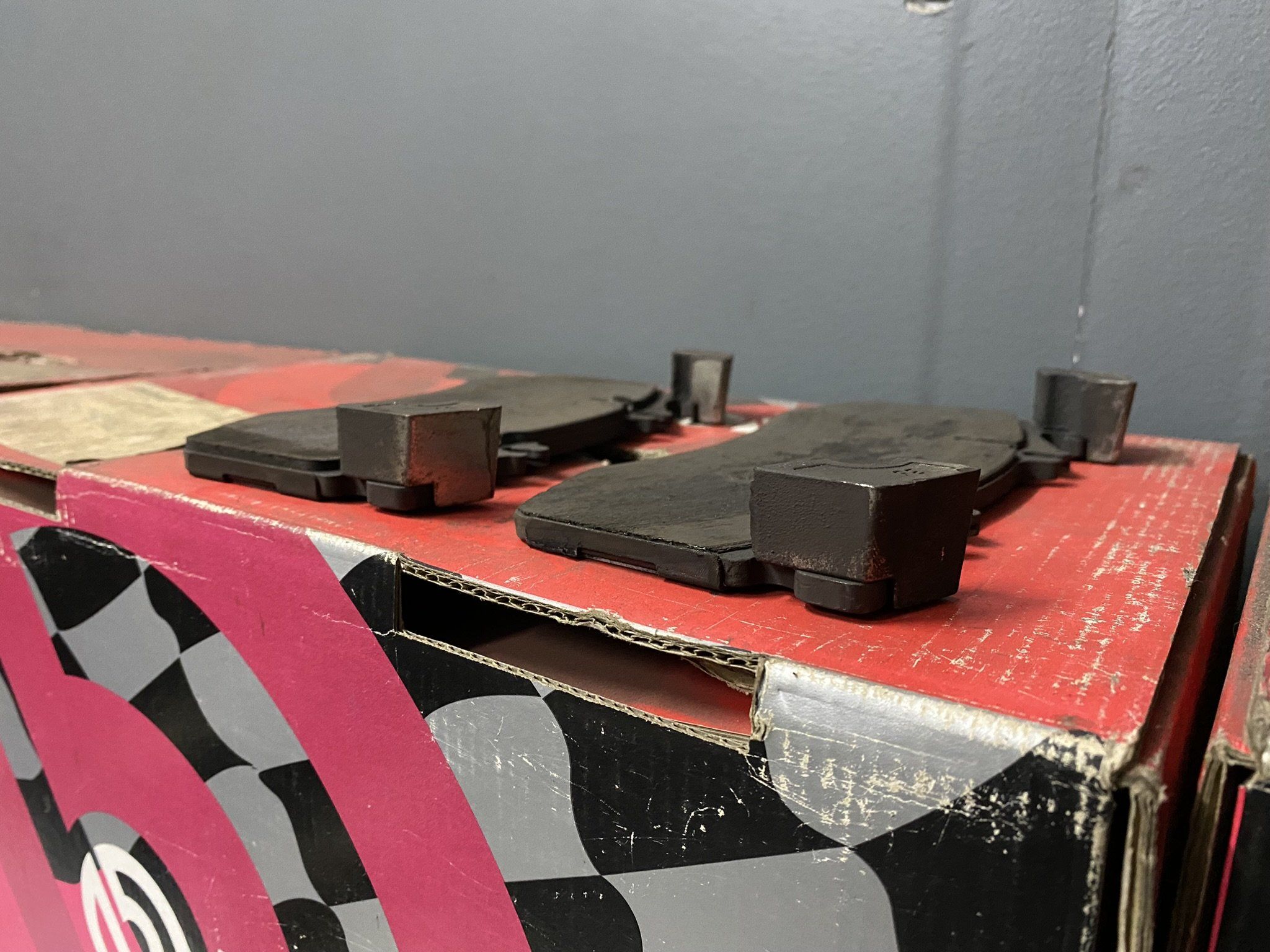

Please don't wait for the brake pad wear warning. As the sensor is usually on one pad you have no way of knowing if any other pad has enough material left, especially on the inner side that you can't easily check.
This if from my A45s, outer-inner front right-hand side, no warning light yet:
