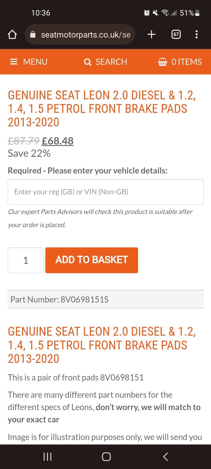

Thank you so much for mate for a fantastic reply it has really helped me. Am I better really just trying to get some genuine ones ? Are these the correct ones ? Thanks again mate
The pad OEM 8V0698151S is actually linked to PR code 1ZE and the 288 disc brake and is a Jurid friction vs Galfa of the 2x OEM's I shared for the 312 disc.
Dimensionally they are interchangeable, and I doubt on the road you would tell a difference in friction materials, maybe only at vmax on the autobahn!

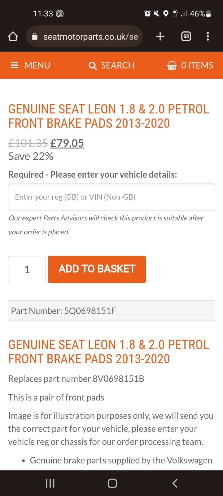

Thanks again mate when I put the part number you said in it brings up this for the 1.8 and 2.0 petrol doesn't mention diesel?

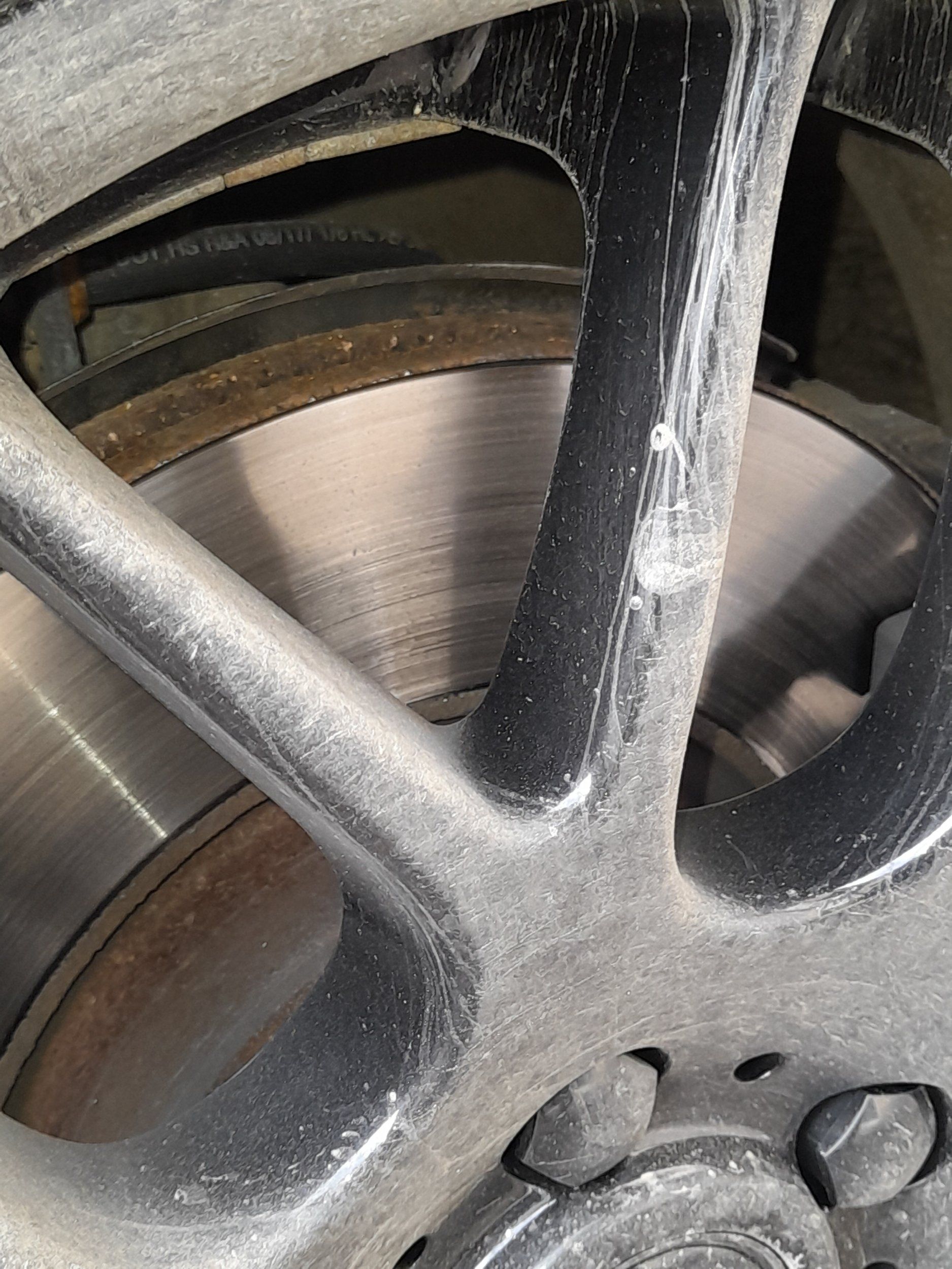

Here is a picture of my front discs what we thinking? Had mot last month and no problems report with them at all cheers ps excuse my wheels lol

As long as there isn’t a big lip on the edge they look ok, seem to be getting used evenly across the surface.
Thanks mate on the passenger side I did seem to feel a lip though I am thinking I should probably change the lot as it will be a waste of money otherwise I do alot of miles you see so in a matter of two months I will have covered 4k so will have to pay for all this again
So you have 3mm total disc wear allowance - 1.5mm each side - if the wear lip is around or over 1mm I would change the discs also. If you change your discs their mounting surface needs to be spotless - I find a rotary wire brush in a drill (with eye protection) the best and a small needle file for stubborn bits of rust.
If you go for discs I would just find the cheapest R90 approved disc you can that are silver coated and high carbon HC.
312 disc OEM part number = 5Q0615301F
The 1.8TSI and 2.0tdi 184 have the same brake systems.
If you buy from that website the you can give the your reg/vin to check rather than trust some random guy of a forum :ROFLMAO:

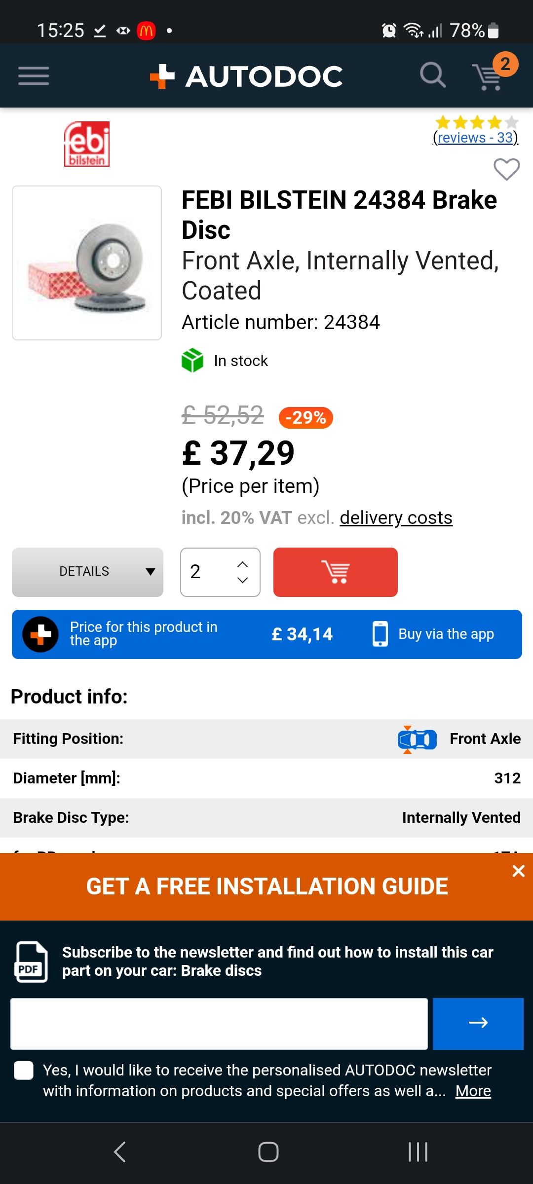

Thanks again so much mate for all your help. Are pagid discs and pads good ? I can't really afford fancy groved ones from mtec and the genuine ones are a little out of reach at over 200 pounds are the pagid discs the spec you have mentioned thanks again
Pads are ok - though not sure about the shim, as the shim wraps around the pad, its thickness is important and many aftermarket pads just have a cheap/thin shim which means they can rattle in the carrier. If a big saving to the OEM pad then fine - but I can see the OEM pads on ebay for £57.
Those discs are not high carbon (HC)

Yes pagid discs and pads are fine. You usually get good deals for discs and pads on autodoc. I had brembo discs and bosch pads fod the front for £100 pounds.

Febi ones for example
