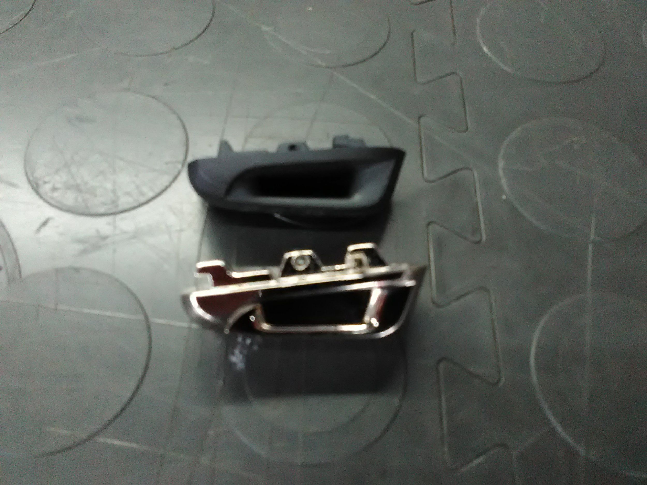

My chrome piece arrived today - same problem as i had with the T-Cross - it doesn't fit without modifying.
When you try to slot it in place it wont slide far enough so a bit needs cutting off (i used a dremmel) - you'll see which part but i've attached a pic showing the part - hope this helps :)
New Vs old

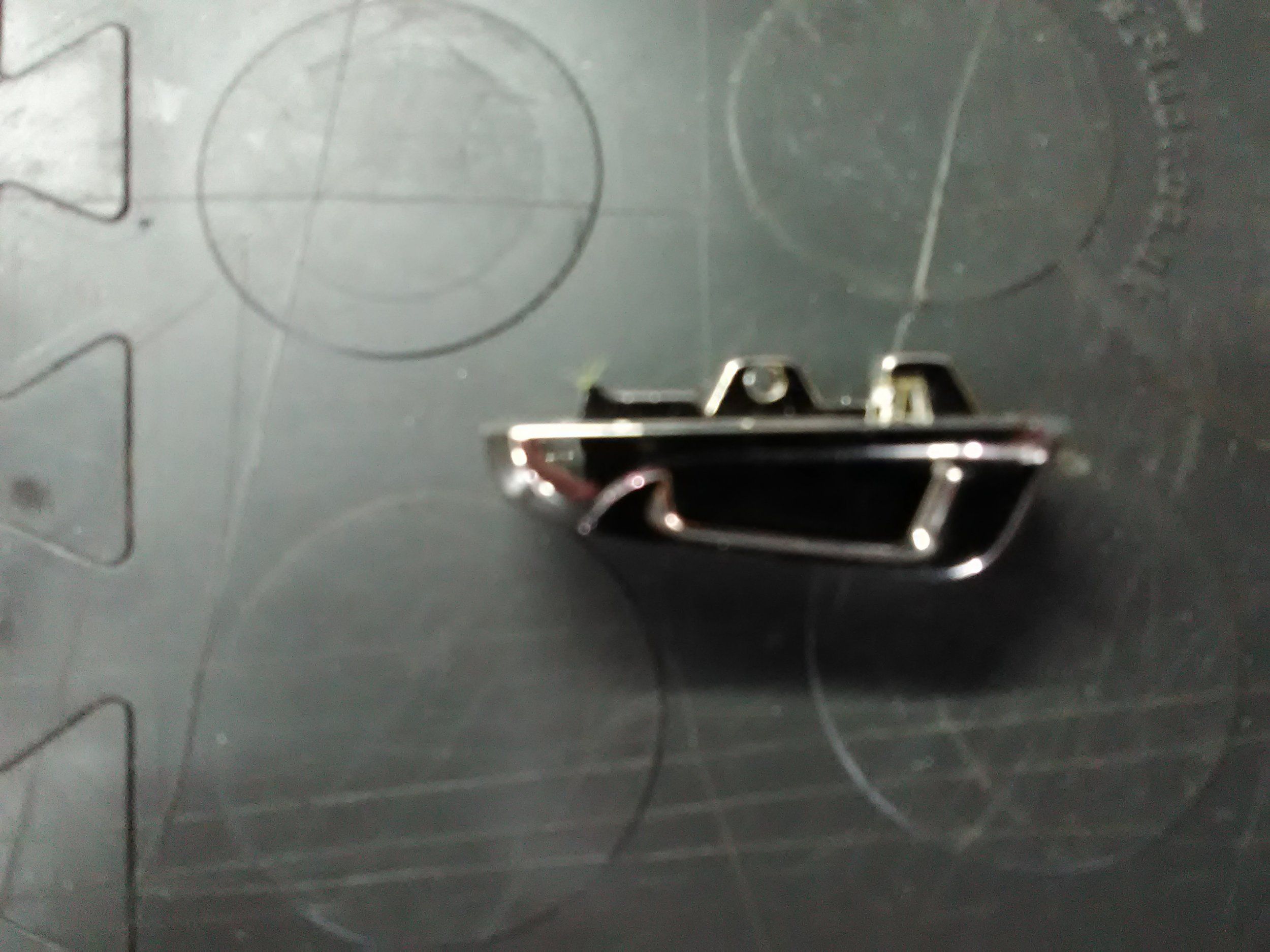

Yellow section needs removing
You're left with this

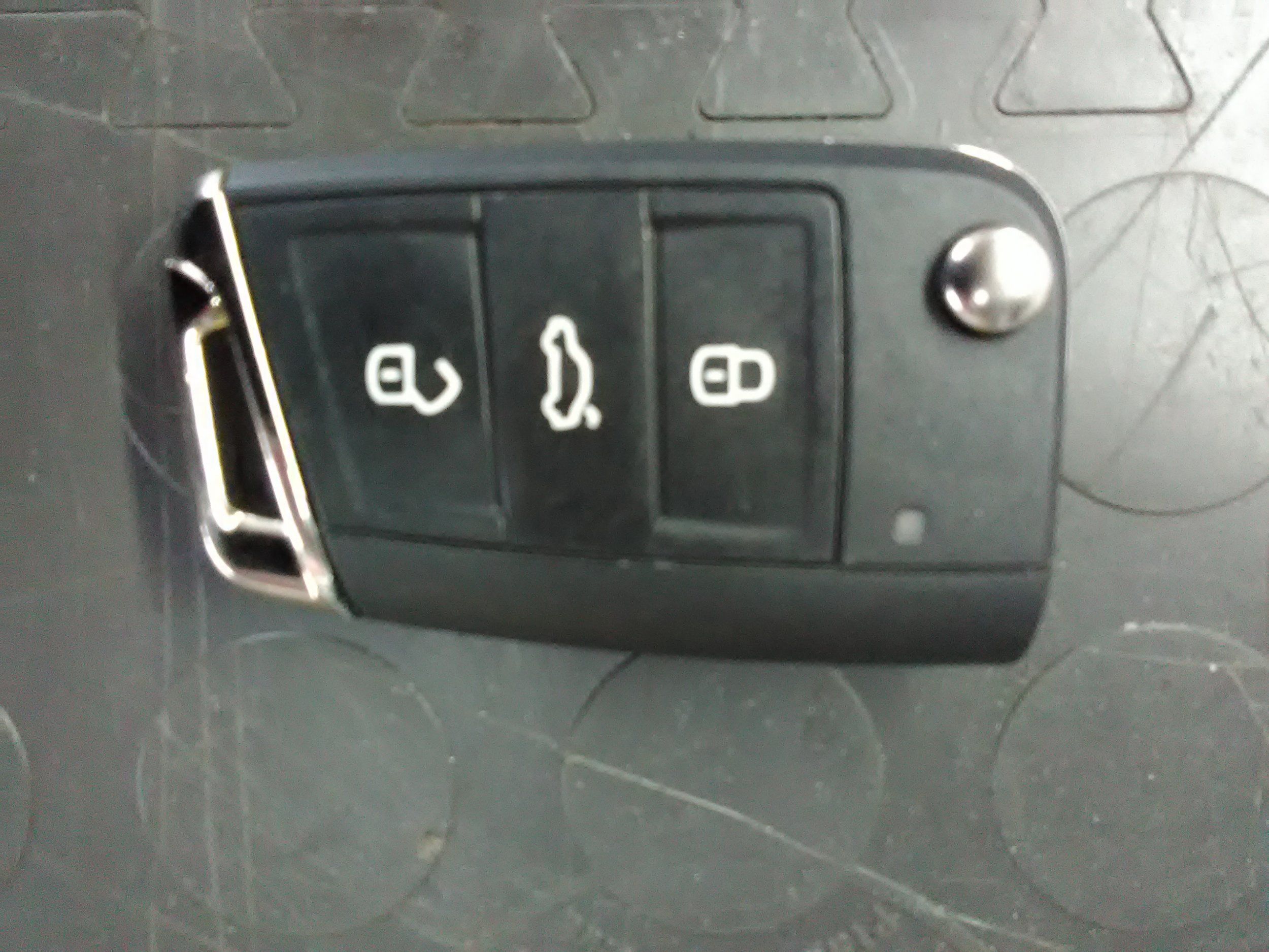

It now fits :)
tight fit after it was installed?
VW part so probably made to not fit the seat key maybe.
need to buy a dremmel now
Yep nice and snug fit. Be careful with the old screw as a new 1 wasn't provided with my new chrome (always had a new 1 with previous ones?) - easy to round off so i used trusty dremmel to cut a slot so i could tighten it all the way down with a screwdriver :)
