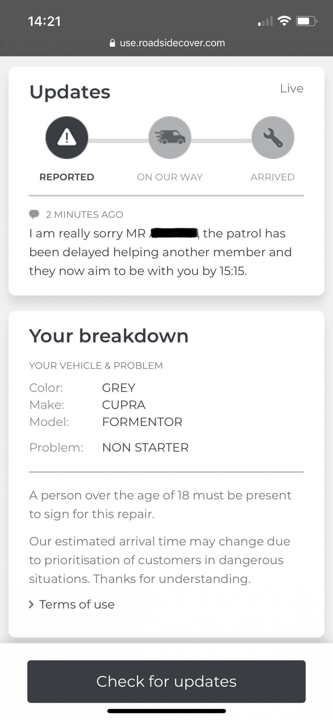

Can I top everyone’s faults today? Car will not start at all. Doesn’t even attempt to turn-over. It’s flagging all these faults in sequence:
Lane assist, front assist, rear traffic assist, dynamic road sign display, and finally drive system: please visit workshop!
To their credit Seat were very quick to respond to the breakdown call and a nice lady took down the details and offered either an AA technician within an hour or Cupra technician within two hours. As it’s parked on the drive and I’m in no rush to go anywhere, I’m waiting for the Cupra tech to arrive... could be interesting.
