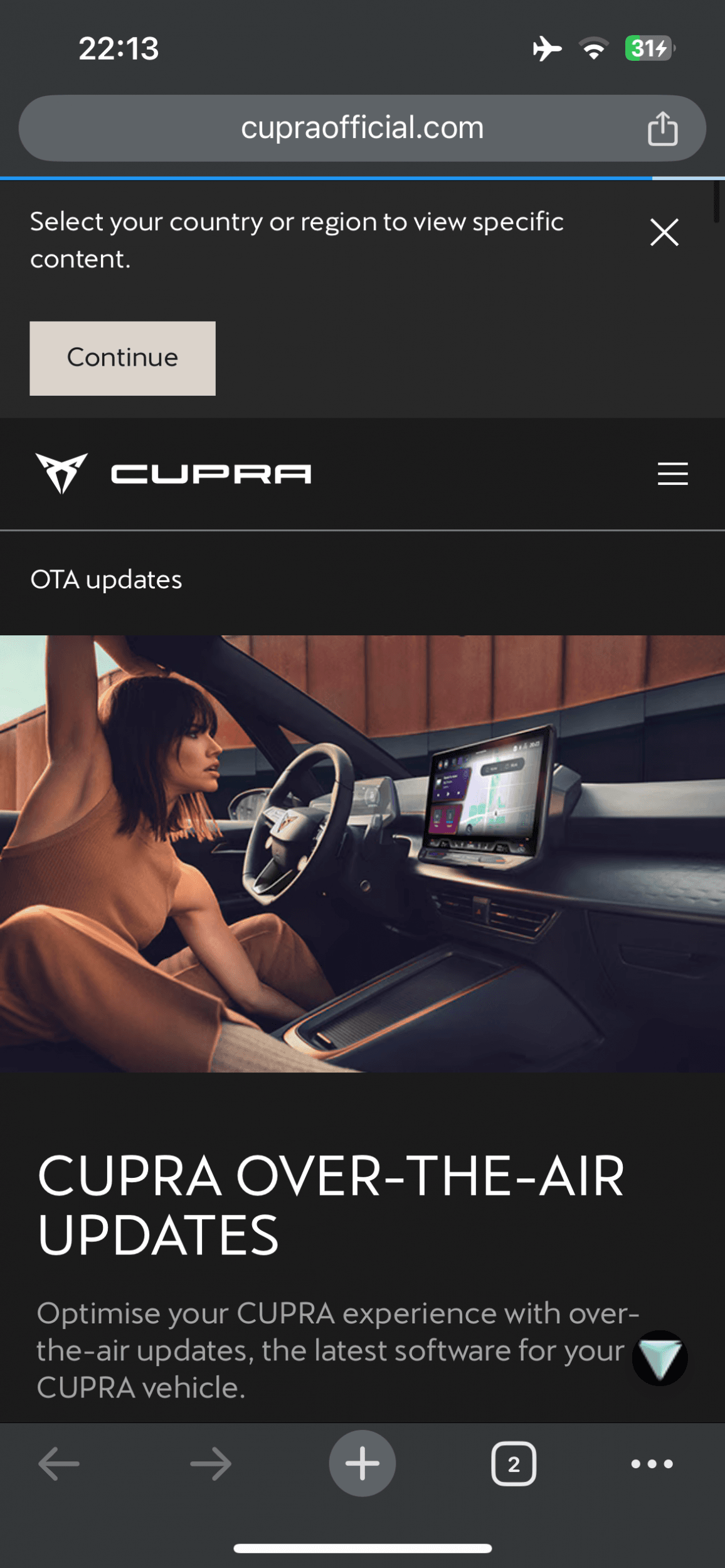

Reactions: tommyfulf
@East Yorkshire Retrofits i saw you commented on a software thread a while back, do you have any info how I would get my software updates from 1788 to the latest version?
I'll reluctantly pay the subscription to my cupra if it will allow me to update my software but if there is another way I'd love to know mate
It's likely you've got lots of updates outstanding, it's probably worth you visiting a dealer/specialist
