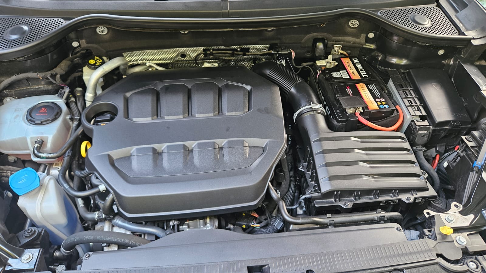

My new egine cover! :cool::cool::cool:
but somehow i fees really stupid for being happy to receive it after almost 2 years, when it should be installed from new.
