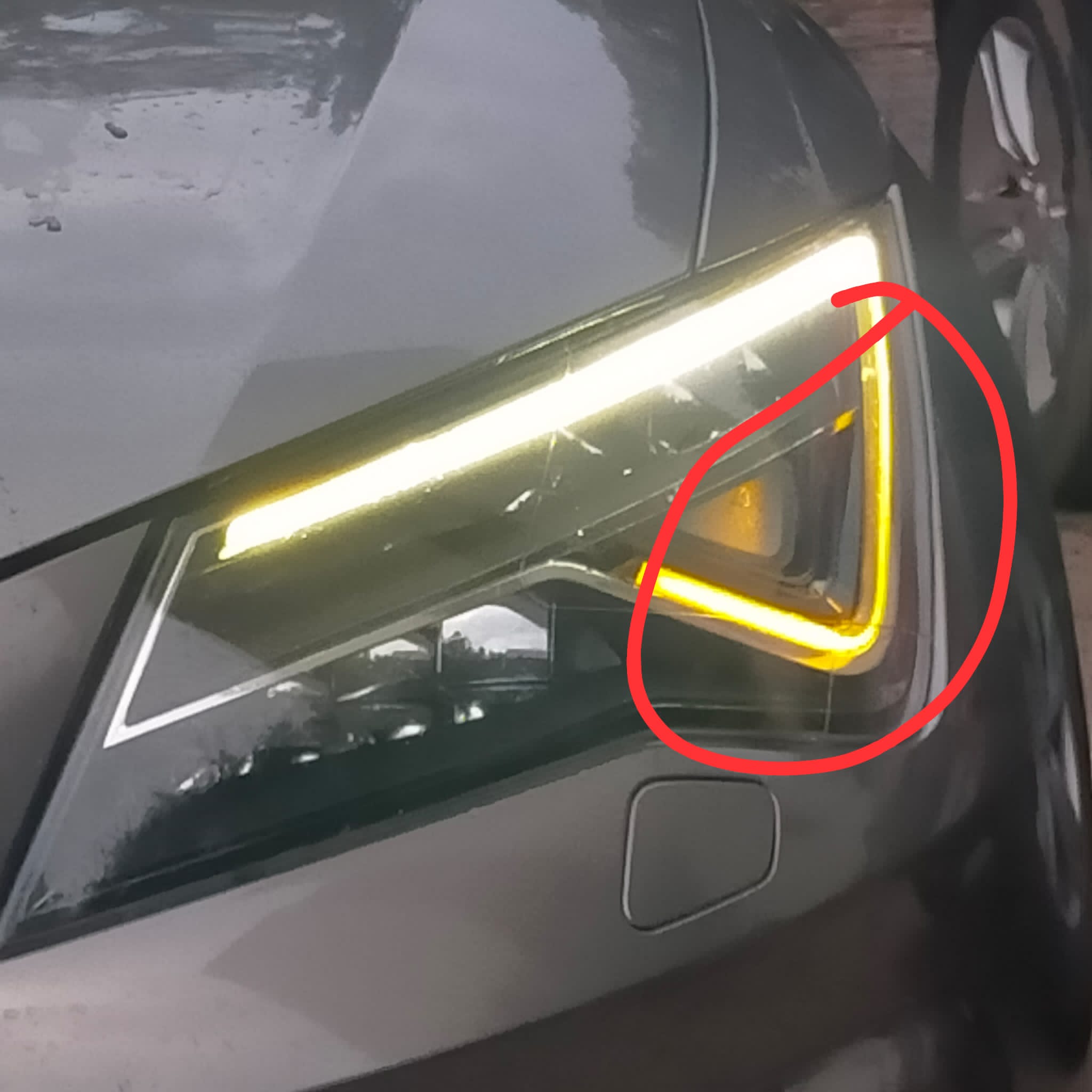

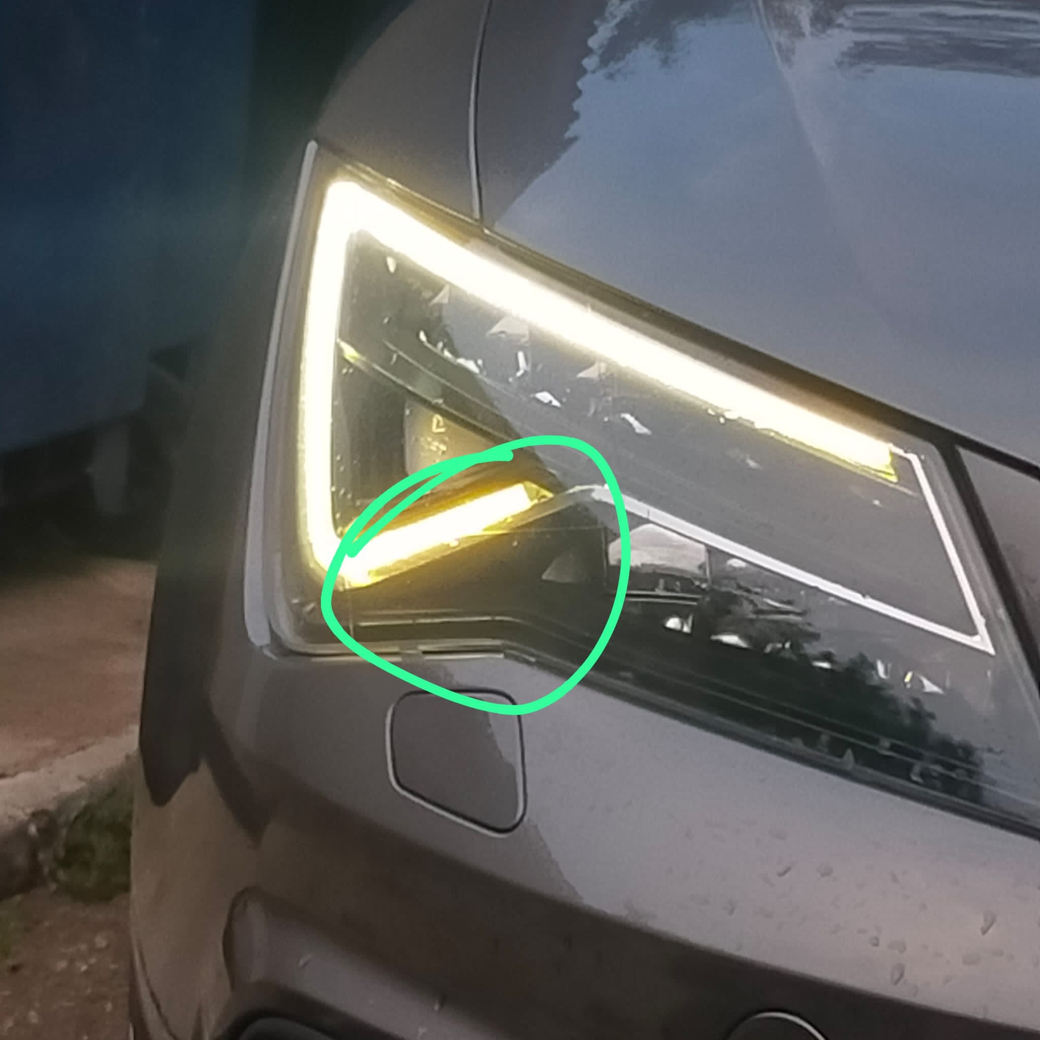

Hello guys, i have almost the same problem.
But to me it seems it is not fully DRL yellow just only some part of it, as you can see in photos.
My Leon is 110k km Face-lift model, so it's going to yellow also when I use the blinker.
Maybe some short circuit ? I'm thinking to do this lights reset from Settings, maybe it will do something.
Some advices ? does it worth to buy new DRL module, or maybe the problem is from inside headlight led tube?

Completely out of the blue, but maybe the LED driver module for the TFL is defective
sorry, thought from German. TFL = Daytime Running Light... every headlight has the module for it.
5F0941476
5F0941476
I was thinking about this, but i don't know how exactly works.
Like, is it possible only half of the DRL to be dimmed and the source of problem to be DRL module ??? My logic says no, but i repeat, i didnt check the drawings...

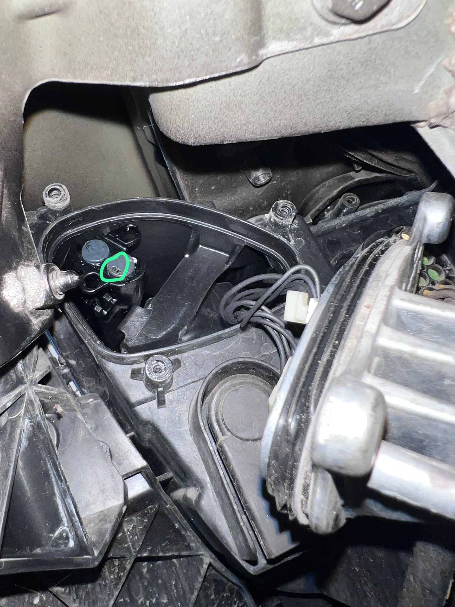

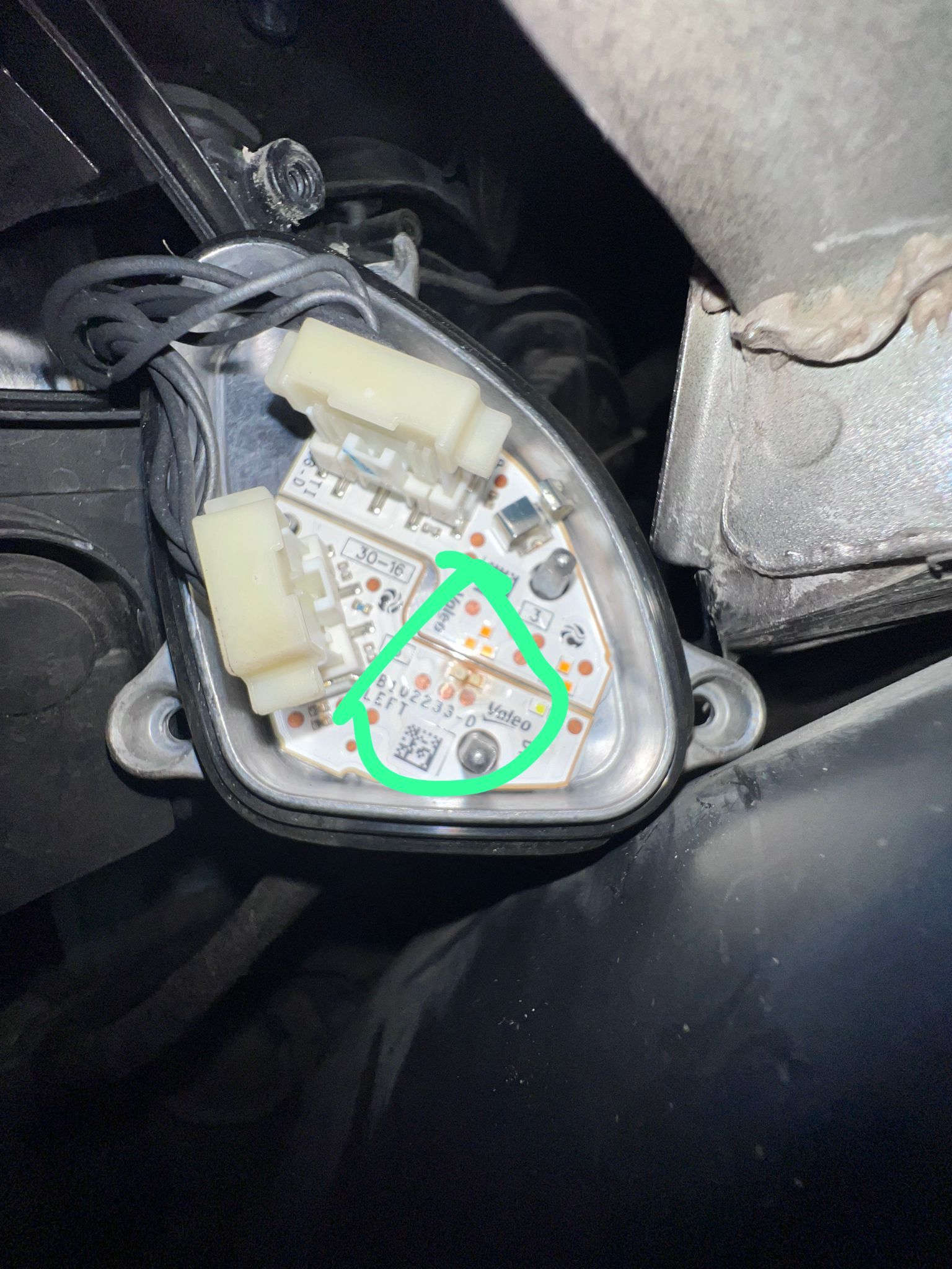

So i disassembled both and found out there was burned spot on LED module, changed it and not much improvement because also the tube inside has a small burn area, i saw on some videos the guys cleaned it somehow... but the electrician which I went to was afraid to try cleaning it.
Now the burned area is not refracting the light so that's why still dim...
@Noumenon this is applicable also for face-lift modules ? i mean the headlight shell and tube inside?
@callliope DRL boards and tubes 100% won't fit.
Not sure about headlight shell.

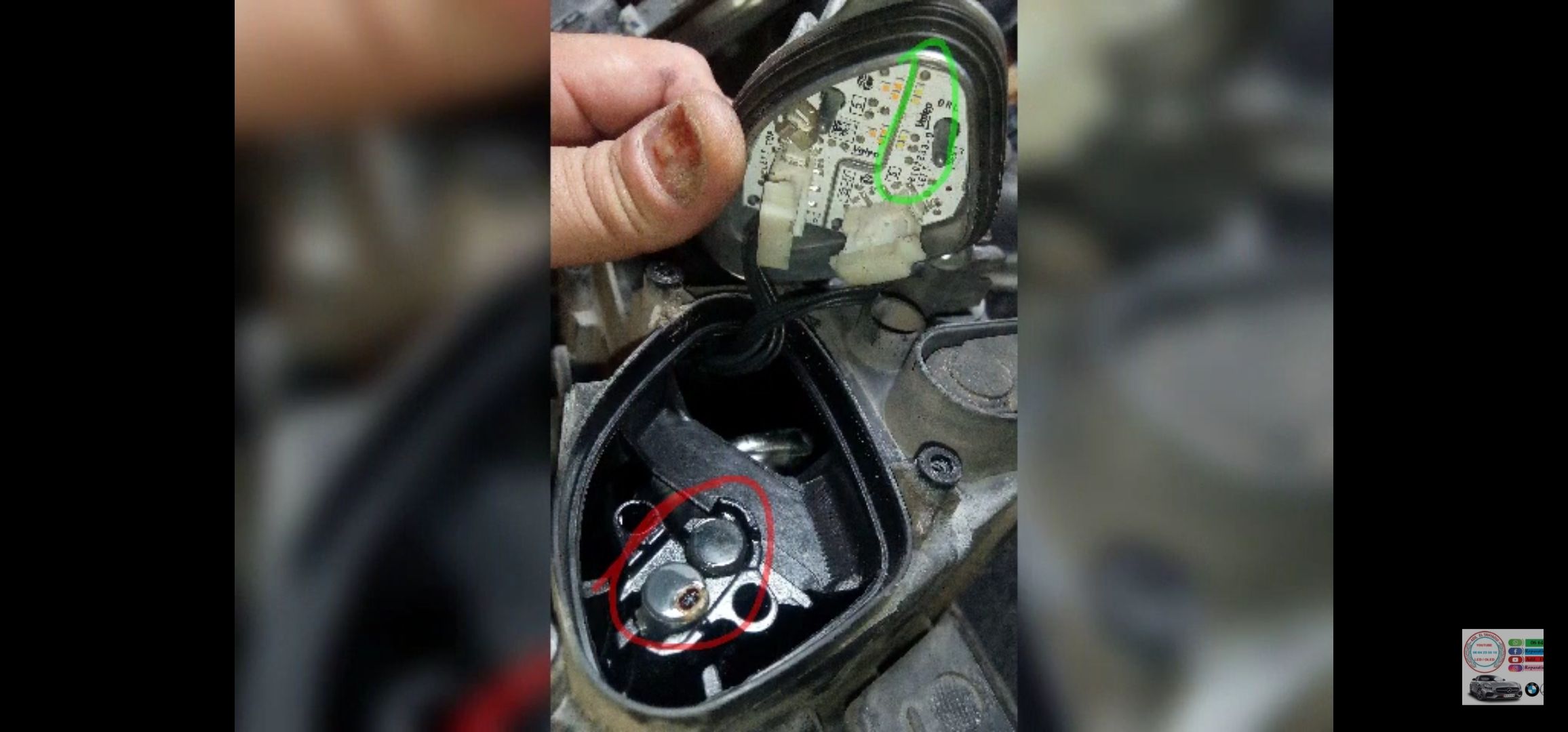

You can scrape the burned end of the tube with razor and then polish it.
Or you can try to clean it with a bit of acetone on a cotton ball, it dissolves plastics.

So actually this is how it's looking on my car:
So I changed the module but still not so much improved, maybe placebo effect.

I had the same problem with the left DRL, so I removed the wheel and fender cover, unscrewed the LED module, cleaned the LED, covered everything except the burned optics with masking tape, sanded off the dark spots with a mini drill and then polished it and the DRL is like new, I can't visually tell the difference between the right and left.
