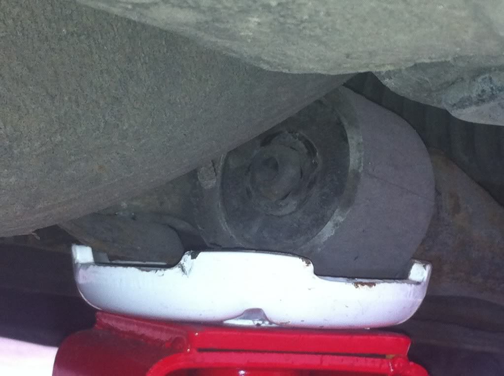

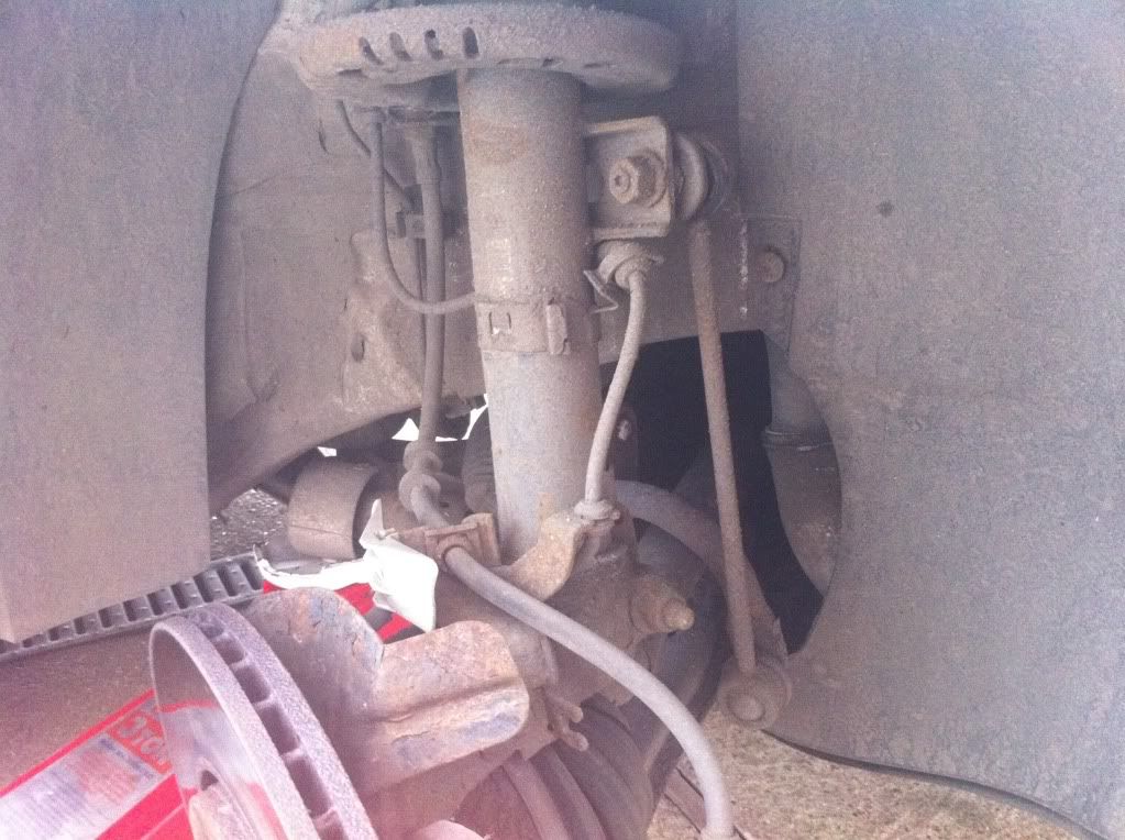

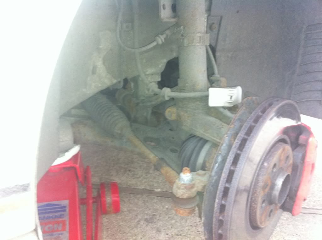

i removed the wheel to have a closer look don't know if these pics are of any help :
Nothing was loose that i could see, disc & driveshaft were turning fine. Grabbed the whole disc to try and move vertically/horizontally but was all solid.
any suggestions ?
thanks

In the first picture, the droplink is the vertical rod with "ball ends" at each end, if you look at the thickish curved "rod" that connects to the droplink's lower end, this is the ARB with the car on the ground, try reaching in to see if you can move it from side to side. Unfortunately, in these pictures, the "ARB end stop" areas are hidden.
I see that you have Cupra TCA rear bushes fitted - the TCA hexagonal peg is trying to turn within its location in the bush, with the suspension in its normal position, does this peg and bush look any better - if you look at the picture, you can see the hexagonal shape of the TCA peg and the hexagonal shape of the Cupra console bush - and the "space" where the peg is trying to rotate in the bush.
