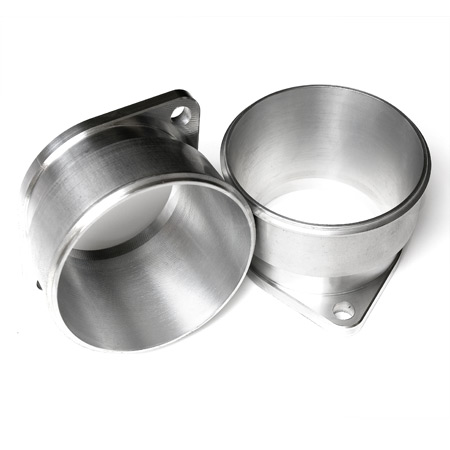

Great to see yours efforts worth while. Is this with the larger collar fitted on the turbo inlet.
The tip is 80 mm all the way now Carl, except for the collar. I've still got it sleeved, as originally with about 30mm of 70-80 mm reducer.

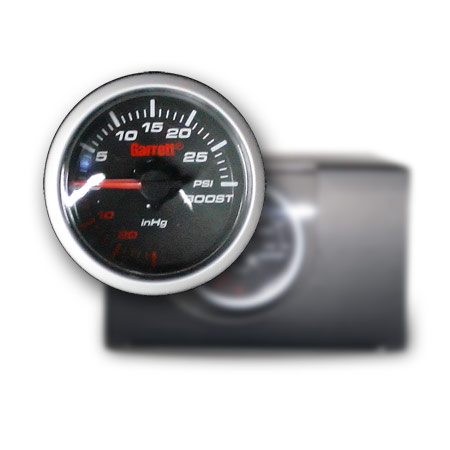

I ordered the big collar from ATP late last week. (Along with a boost guage that probably doesn't match any instruments, but has a nice Garrett logo)
