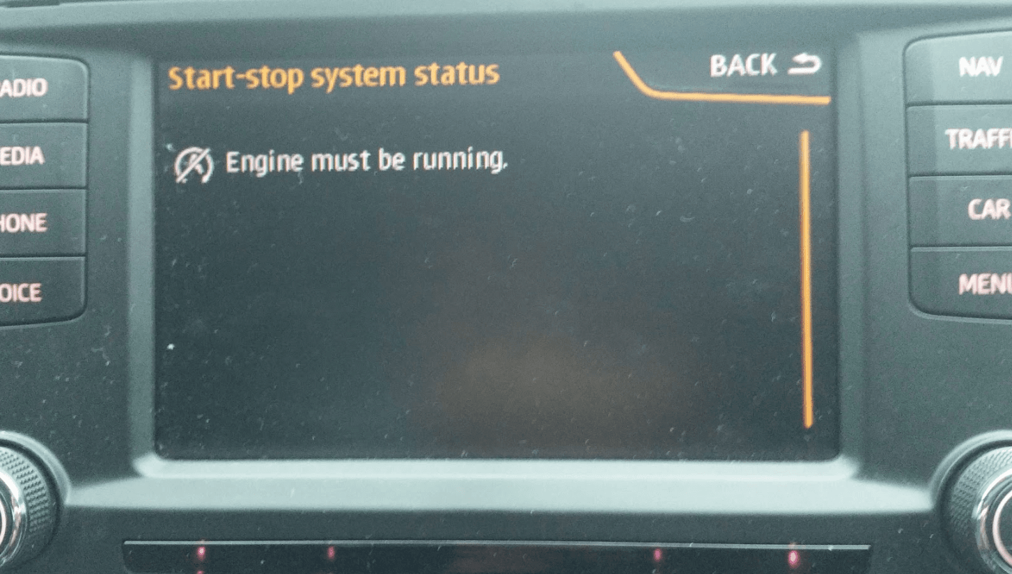

I noticed yesterday an in vehicle status comment regarding start stop and being active or not.
I wonder if we could use this to determine if its undergoing a regen? Not the best to have this screen on all the time but maybe a work arround?
I use this if I notice it's doing a regen mid-journey. That way I'll at least know when it's finished.
I saw that too when I was searching the forum for dpf info. Unfortunately, in my car, the vehicle status screen does not change anything during regen. The only way I can tell is the car is idling at 1k rpm and, in the good days when regen starts at the beginning of a journey, the oil temp goes up really quick. MPG, takes quite a drop and the start stop icon in the dash is crossed out (mine's always off anyways as I don't like it).
This is what mine displayed when I clicked 'start stop status' within the CAR menu and VIEW.
Seems in this instance SS was disabled - however my oil temps were only at 60 so wasn't hot enough I don't think to be actively regening - maybe is was 'planning' to regen? as it did start regen later in the journey - idle revs at 1000.
