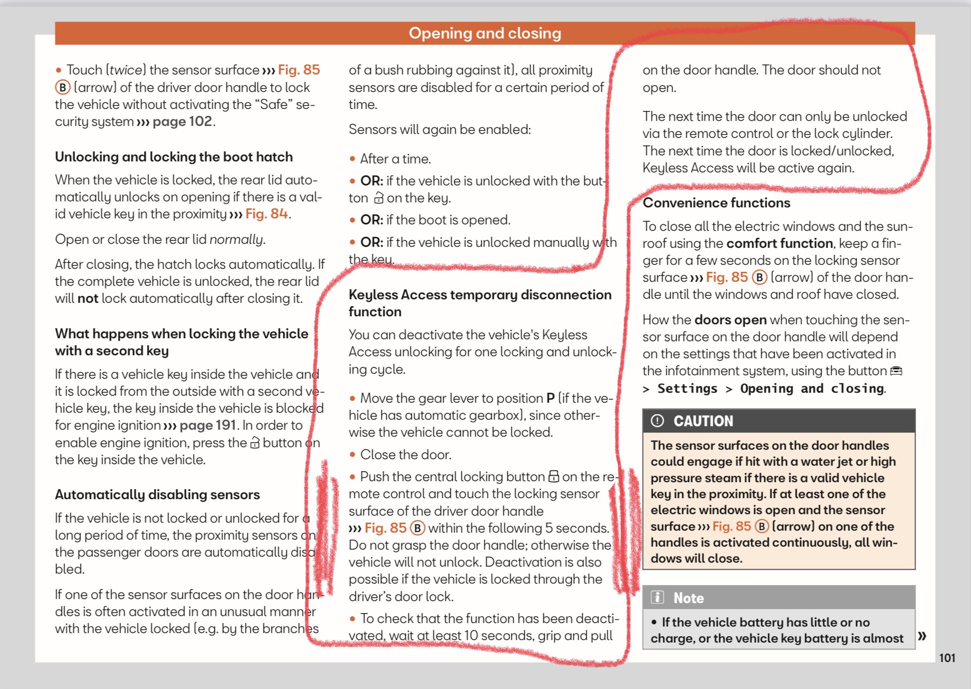

I've read elsewhere that you can temporarily disable Kessy by locking using the key and then pressing the dimple on the handle within 5 seconds.
However when I do this and press the dimple, it immediately unlocks the car again.
What am I doing wrong?

The procedure for temporarily disabling keyless entry is outlined in the owner’s manual - page 101 in the Nov 2021 edition - page 101 (If your manual is an earlier version, the procedure to do this might be on a different page).
I think what you may be doing when you’re touching the sensor on the driver’s external door handle, you might gripping the handle. If you do this, then the car will Immediately unlock again. You must only touch the sensor on the outside of the handle without gripping the handle.

Yes that must have been it, thanks. I got it working fine now.
