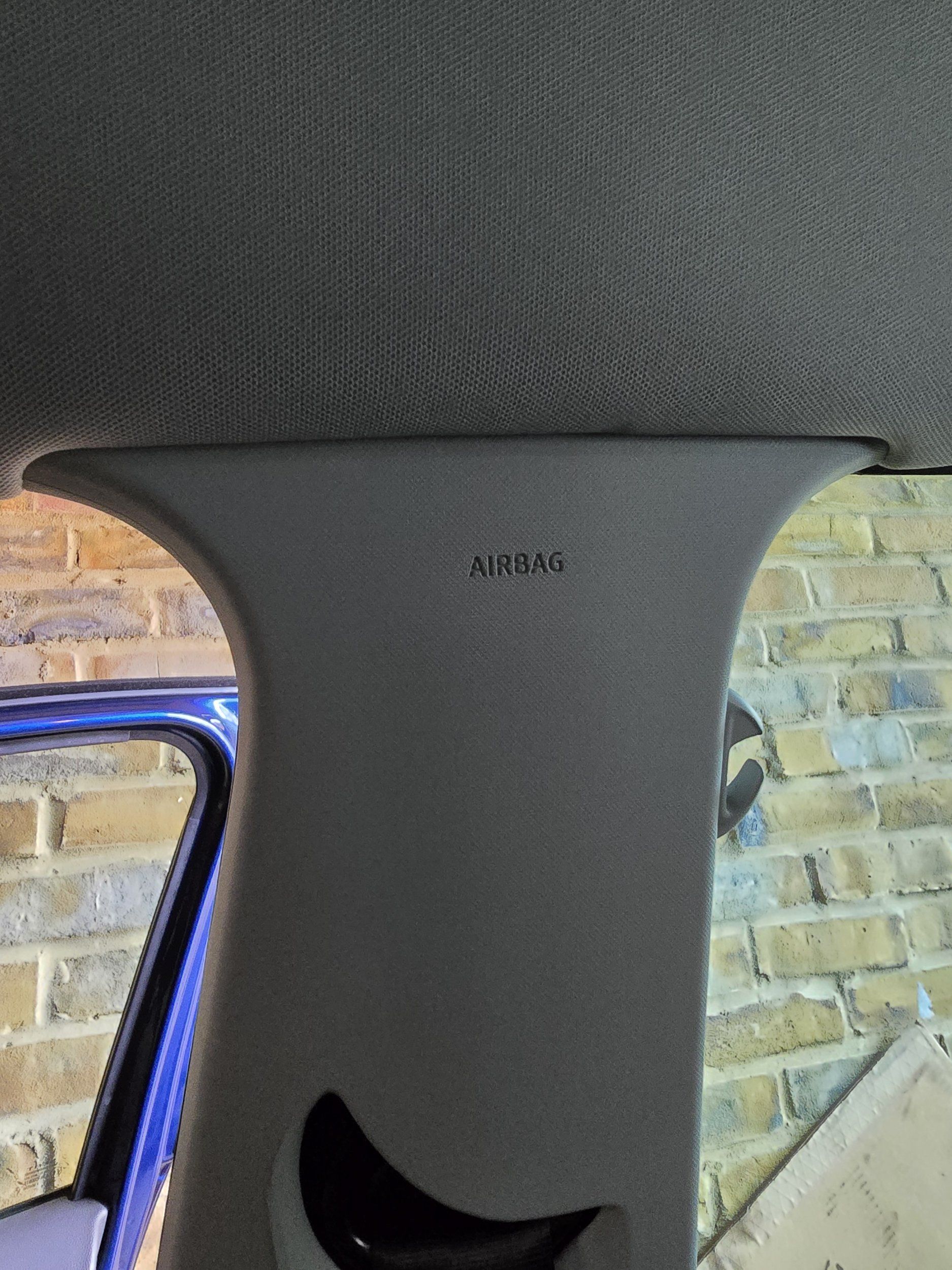

Hi @Lozzy15 just a question on routing the cable from rear dashcam to front of car, I have an ST which has an Airbag in the 'B' pillar area, I'm not sure if it's behind the headlining or the 'B' pillar trim, I'm assuming it's behind the word 'Airbag' is this correct? :)
AFAIK they run from A to C pillar as Curtain Airbags above the windows. Then you have them down the A pillar too. Every Leon will be the same, no difference for an estate.
Seven airbags on the MK3 Leon, 1 passenger, 1 driver (steering wheel), 1 driver knee bag, 2 side bags (1 in each front seat) and 2 curtain bags (1 each side), I think.
