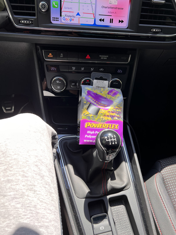

Hello guys. I'm interested in to buy Powerflex mount insert for my manual 1.8 stage1 mk3.5 Leon.
Yellow PFF85-832,
Purple PFF85-832P,
or Hybrid PFF85-833?
What do you recommend?

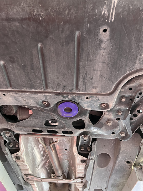

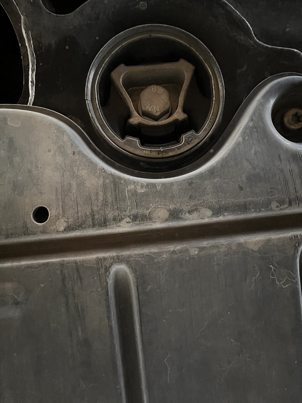

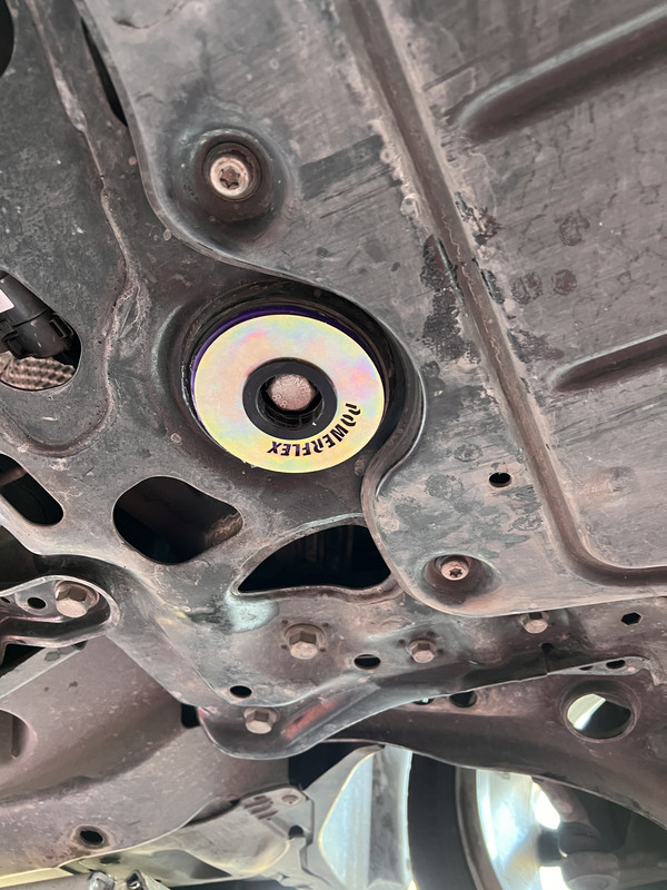

Finally installed a powerflex mount insert. The proper code for my car (version2) was the Purple PFF85-832P.
I chose purple and the car has a fantastic racing feel. The gear changings, especially the downshifting, is awesome.
Better braking, turning also. The negatives are well known. The vibrations under some conditions, for me is so addictive!
Couldn't believe how a product of 50 euros can change a car!
