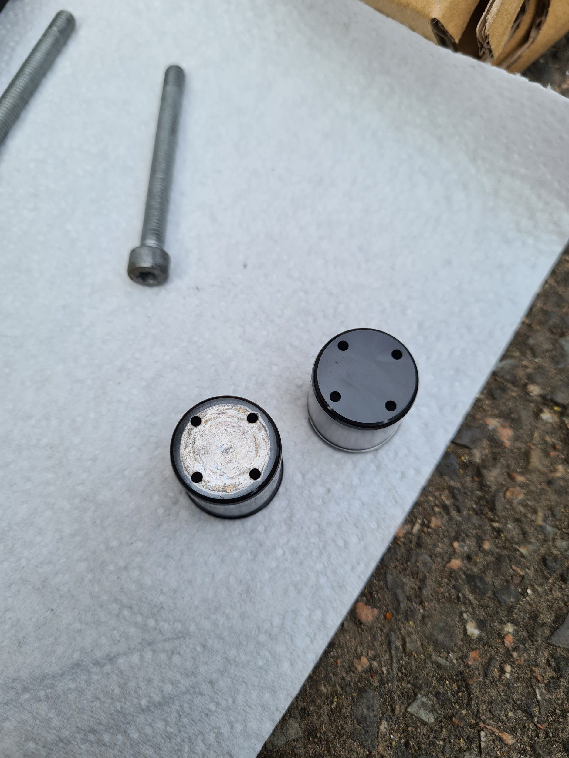

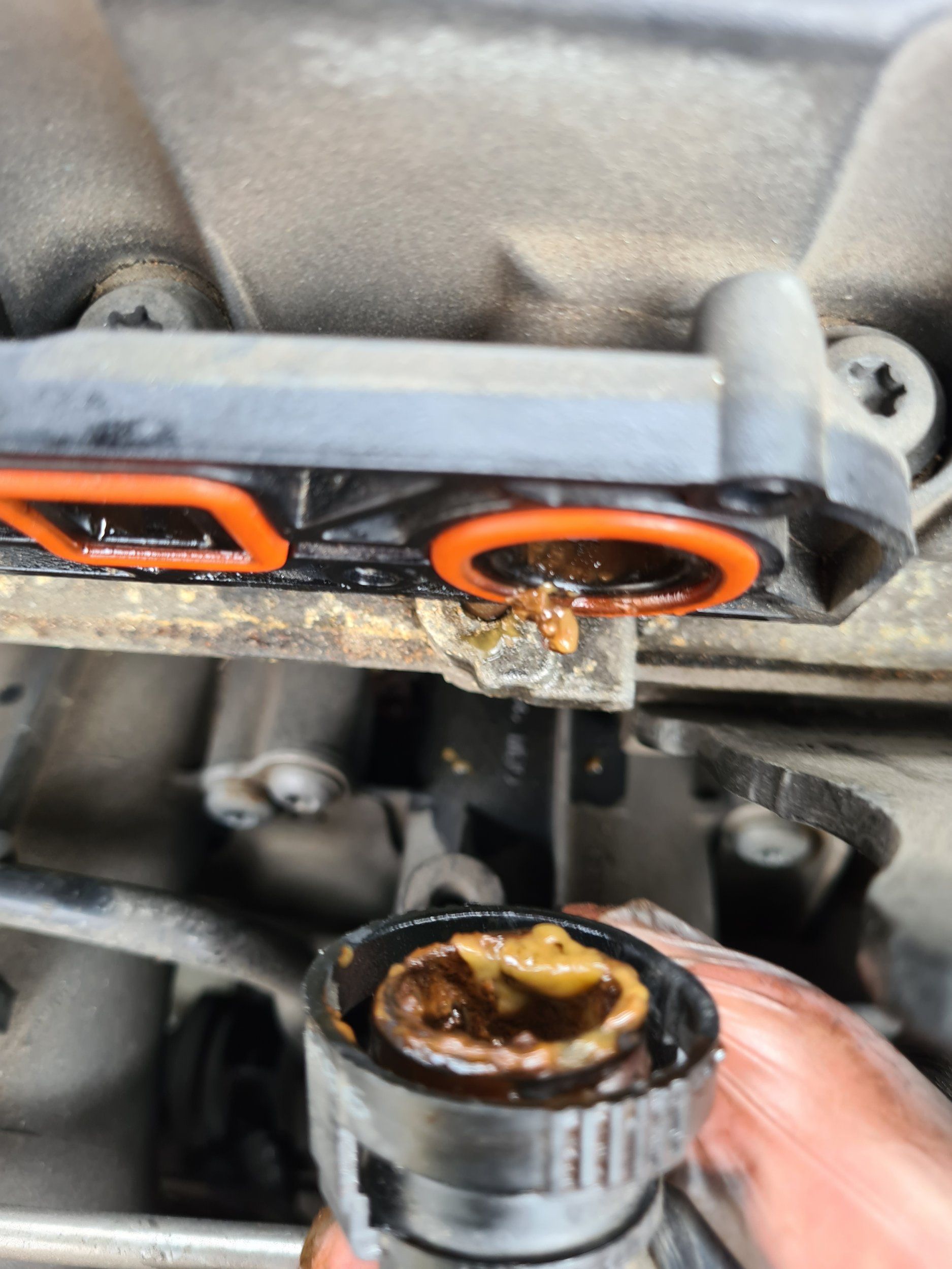

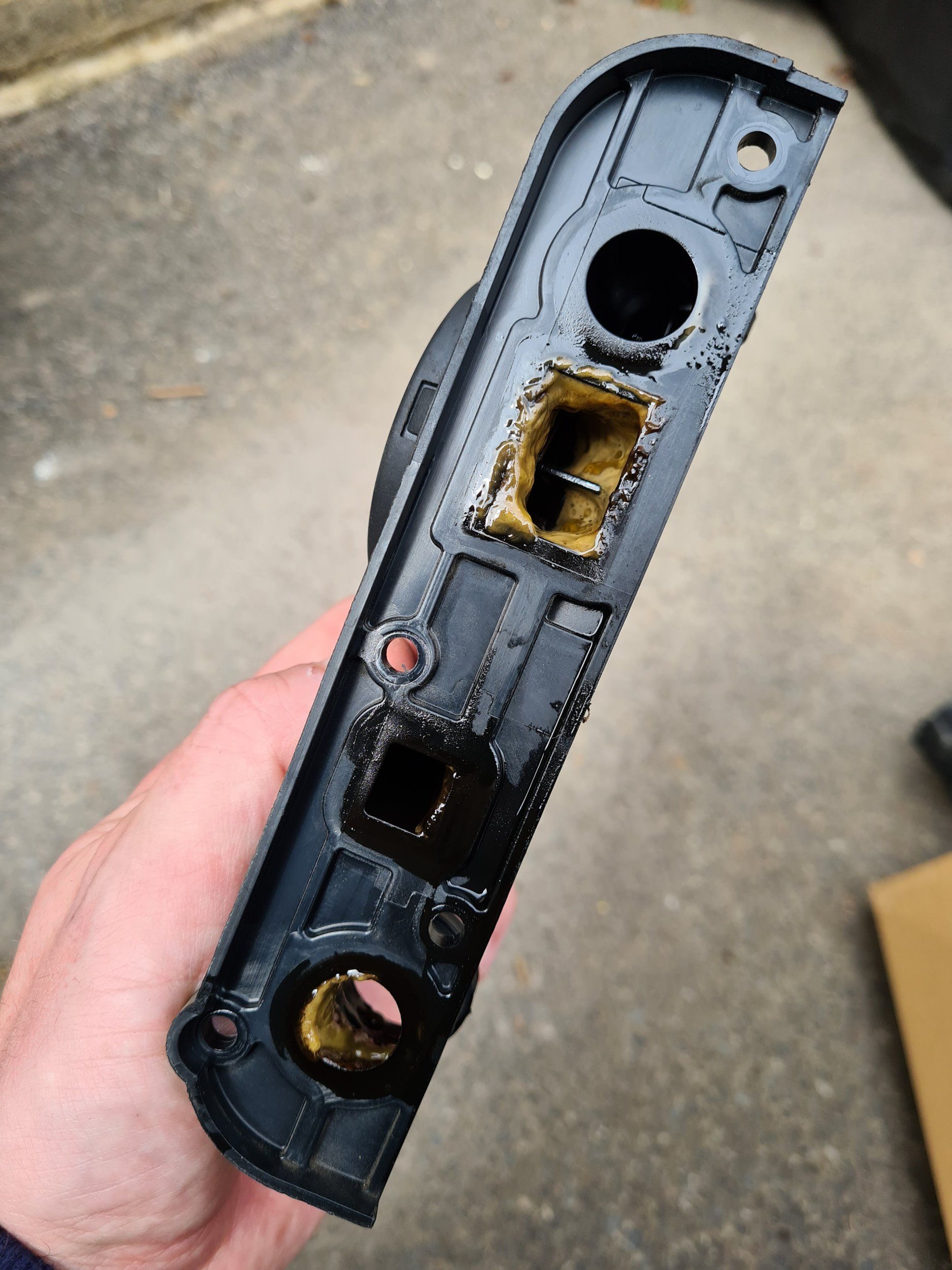

My cam follower was fairly worn, but the concerning part was the amount of yellow gunk inside the PCV and around the orange gasket. I fished loads out (photo only shows a sample) with an Allen key, before replacing both. I had a minor service done a few weeks ago, plus cambelt & waterpump, so I'm hoping this gunk doesn't reform indicating more serious issues?
