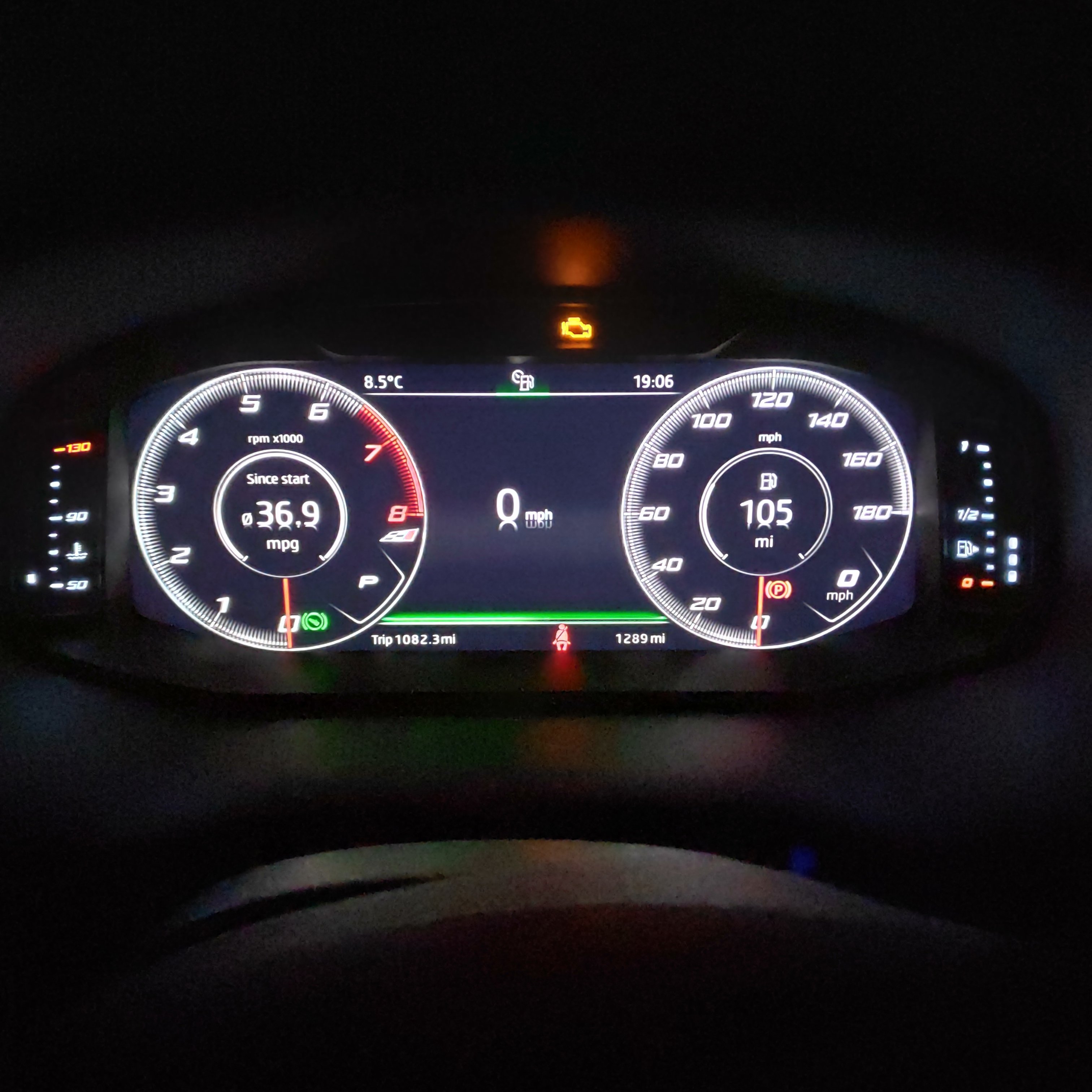

I have 2 errors that keep coming back. Any ideas how to fix?
Central electronics
Fault codes:
263442 Manufacturer-specific code
Infotainment system
Fault codes:
02571 Input for interior light dimmer

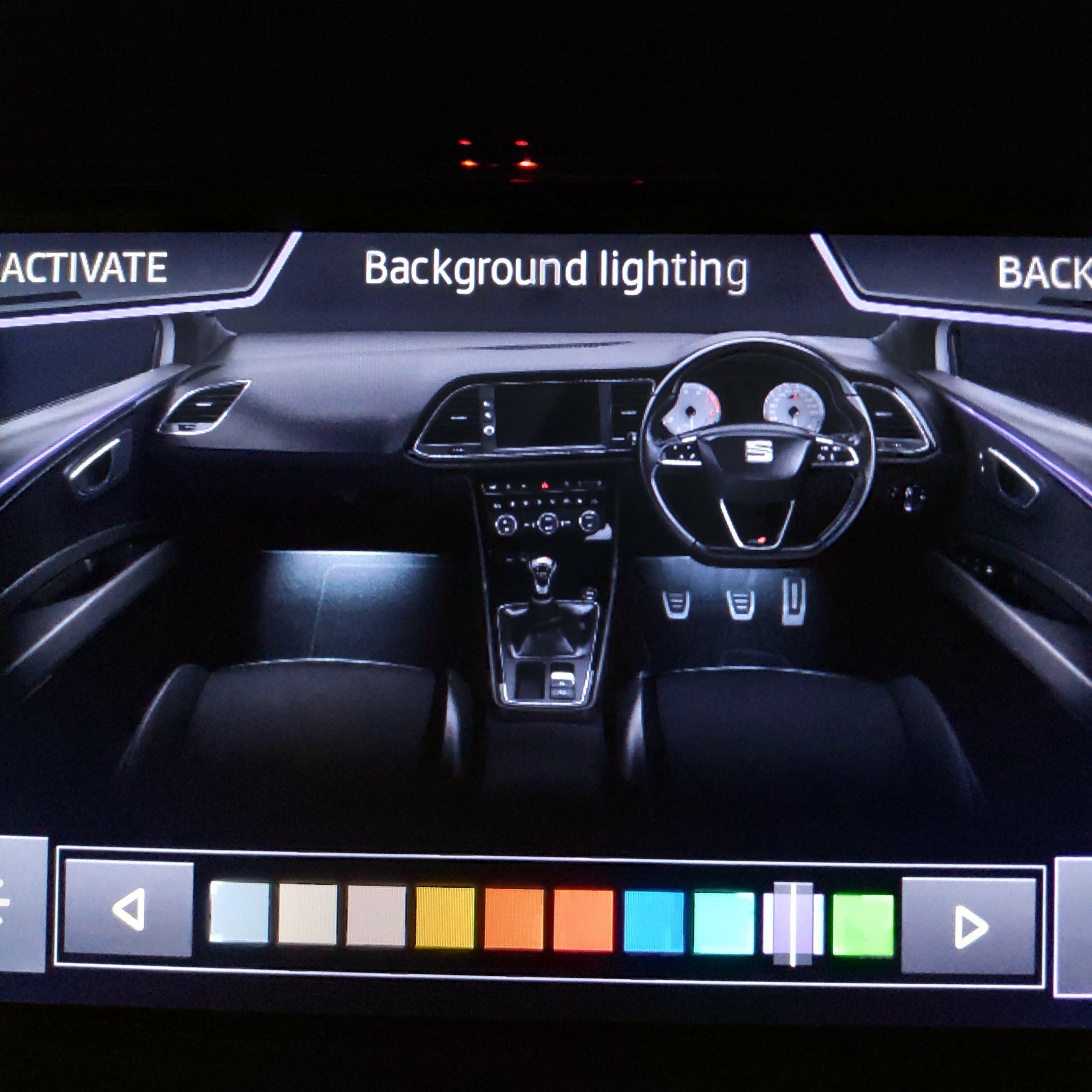

If you copy the settings on post 305 then select the additional colours. Once saved turn off the ignition, lock, unlock, turn the ignition back on and they should be there.
I now get the colours as an option on the screen but it doesn't change the door lights only the lights around the screen and digital dash.
Is this the same as yours?
I don't have the digital dash, so it only affects the doors. Did you have the menu for the colours before? If they weren't there by default you might not have RGB leds in your doors. I may be wrong!
Yes I had the menu and approx 8 different colours that changed both the door led and lights on the digital dash so definitely RGB LEDs in the door. I can now choose two additional colours but it doesn't change the door LEDs just the lights on the dash.
