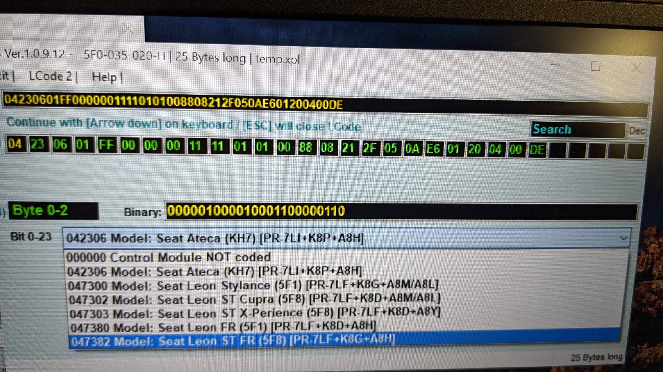

Your pictures show that you were using the newer connection protocol UDS/ODX/ASAM.
Try to connect with the old protocol and you will see that the Byte data is like mine and contains more data.
It actually appears to contain less info on this screenshot but all the others have zero difference.

(reckon it's because your Cupra Ateca has the standard head and the UK ones have the high. They haven't got the image in the standard units.... I got the image in my high unit with fairly recent firmware and not a Cupra Ateca if is set as above.... whilst we are at it you might want to check those navigation FECs on the high to see whether in the UK you have been blessed with unlimited life ones as those in Europe... I think not but worth checking... the check is here with the conversation.
It's the ready reckoner link, rolled out to Cupras in Europe so it appears in 2019... but you never know... saying that I think I know the answer

Well it's what they have left out of the standard infotainment units firmware that's the issue. Perhaps putting it in the Ateca Cupra was an after thought. It would be a firmware update to fix it unless the image is stashed in a differemt address place to the high.

The solution is going to be the firmware release of the infotainment unit. What's your release Yanivkoval. 515 seems to be the most recent release on the standard unit. If yours is a lower release you could ask one of the people on the software update thread with 515 and VCDS / Obdeleven to turn their car into an Ateca and byte 18, decimal 10 code into the field to turn it into the Cupra version and search for the images.... just in case it was a known spec fault and fixed or anybody reading this thread with 515. Or could insist that if lower number your dealer upgrades you. The images if they are to appear will be in the 5F firmware, its whether they have left them out by accident or design. The 10 code toggles them all not just the boot up screen. How the high works so the standard will be the same. It's the only way it will be fixed is for Seat to have the images in the firmware.
Post 31 on the thread where I used Boyracer's long string to identify the code and turned my standard Ateca into a Cupra Ateca. If yours isn't 515 firmware you need to get some one to try out whether the images are indeed in 515. Your dealer could do that if they had that most recent firmware.
