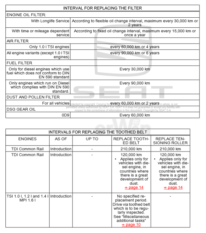

According to ERWIN, for Group A countries (i.e. GB/EU): No specified replacement period (but to be regularly inspected), 240,000 km (150,000 miles), then every 30,000 km (18,750 miles).

Thanks for info. I'll stick with 5 years, as I have the extended Seat warranty, that's what the dealer has advised.

Long thread regarding this a short time ago. Email reply I sent enquiring about this I got back from Seat customer service UK confirmed it is 5 years with no mileage stipulation.
