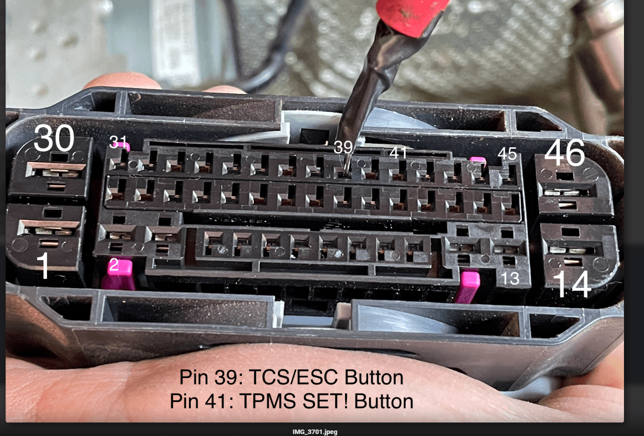

A follow-up for @Paris
I have news that might give some hope to you.
I searched for information on Golf 7/7.5 wiring diagrams as it is basically the same car as Leon/Ateca, using the same electronics etc.
It seems that they were still using the TPMS button on Golfs equipped with 46-pin ABS units.
The connection shown by the related wiring diagram is from the button to pin 34 at ABS unit (button also needs a 12V connection).
But also somebody in a forum who retrofitted the TPMS button in their Golf says it's pin 41, as it's shown in the second photo below.
You can check out that forum posts at
If you really need to do this retrofit, this new information is worth looking into, I believe.
But take it with some pinch of salt, do your own research on whether it's pin 34 or pin 41 and proceed with your own responsibility.
Cheers,
Serdar
