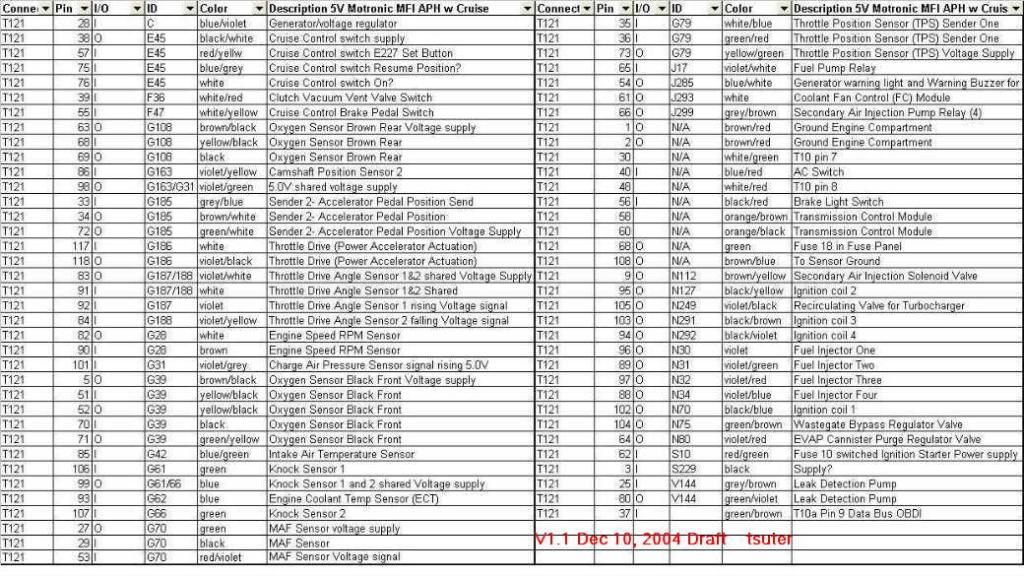

I am needing some confirmation that the list i have found is correct please.
cuprabaz Racing 2020VT Jun 22, 2004 2,357 1 Aberdeenshire Dec 19, 2014 #1 I am needing some confirmation that the list i have found is correct please.
rae1001 Sep 15, 2012 894 0 Aberdeen Dec 20, 2014 #3 I reckon bill could confirm... Maybe send him a pm
cuprabaz Racing 2020VT Jun 22, 2004 2,357 1 Aberdeenshire Dec 20, 2014 #4 He's already seen the thread.... I could confirm myself if i was at home and could get to the car but i'm stuck offshore :-(
cuprabaz Racing 2020VT Jun 22, 2004 2,357 1 Aberdeenshire Dec 20, 2014 #6 rae1001 said: Ah, im out of suggestions then haha Click to expand... Take that list, a multi meter and get yourself under your bonnet
ibizacupra Jack-RIP my little Friend Jul 25, 2001 31,333 19 glos.uk Dec 21, 2014 #9 just uploaded this for you.. http://badger-5.com/bin/wiring/Ibiza Mk3 ECU wiring diagram.pdf
cuprabaz Racing 2020VT Jun 22, 2004 2,357 1 Aberdeenshire Dec 21, 2014 #10 Thanks for that Bill. As soon as I opened it I realised that I've already got this on a usb...
