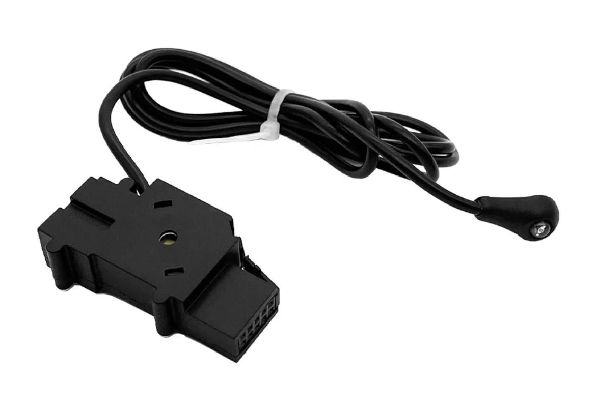

I’m not sure if i understand correctly. The sensor is one of those chinese passthrough connectors with the sensor sticking out. I attached an image. It worked with no coding. Switch is a used OEM 5G0941431AF

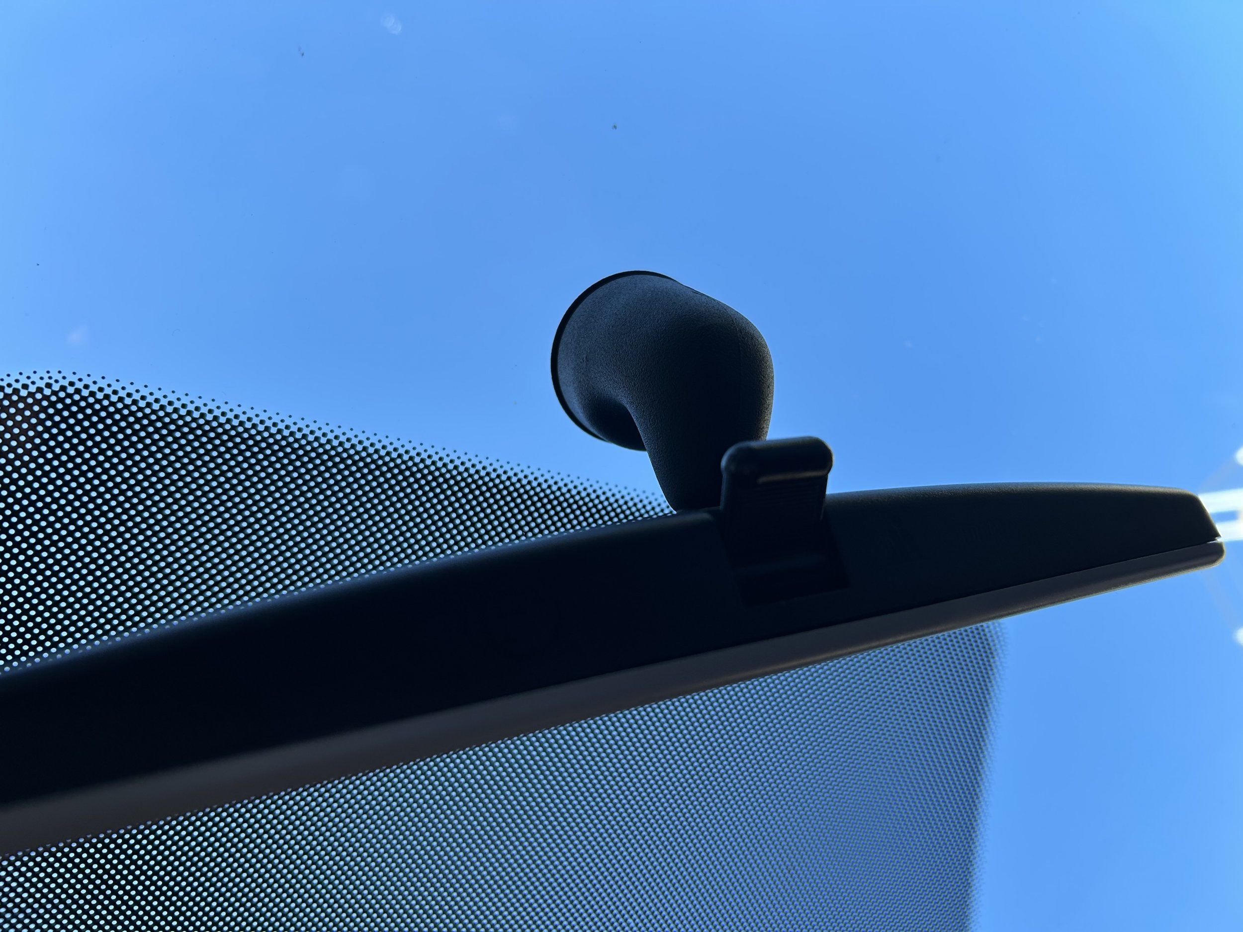

this is the mirror that i have. From my understanding i would need to have a different assembly for it since it houses the rhls sensor. People talk about changing windshield with one that has it already. If i can’t unglue and retrofit the other assembly i might just give up and stay with the sensor i have right now. Do you know if that’s possible?

It is a random Chinese part... It's just telling the car the light switch is set to on whenever it's dark, so of course you're going to get a warning whenever you exit the car in the dark as the sensor is telling the car you've left the lights switched on
But if i set the switch to manually on, no warning happens. That’s the thing. Only parking lights and auto when it’s dark give a warning. I don’t know, maybe i’ll try and retrofit the oem sensor, but changing the mirror assembly seems very challenging without changing windshield

You're talking to the wrong people, you need to speak to the seller/manufacturer as they are the only ones that know how it works and how to correct errors, if it's even possible.
If it had been retrofitted properly then we could help but we don't know how that POS part is configured. You'll either need to live with the errors or do it properly.
