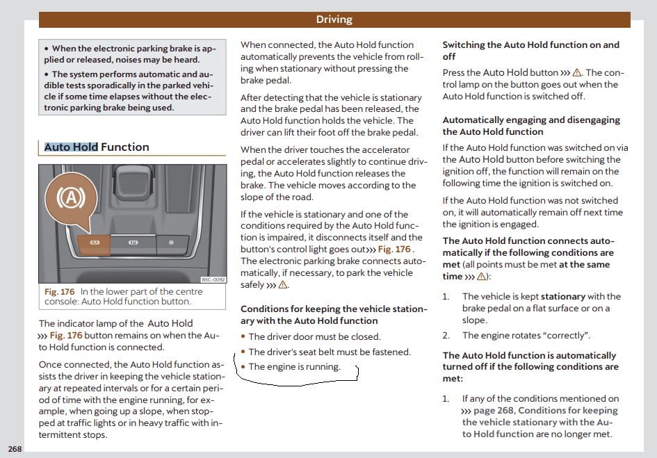

According to the manual the engine have to be running for auto hold to work. So I'm not exactly sure because I have DSG and also I always disable start-stop system so the auto hold is working as intended. Perhaps "other instances" you mentioned occured when the engine didn't shut down coz of start-stop?

The engine is, as I understand, technically still classed as ‘running’ for stop/start. I’ve just driven around to try and it definitely auto-holds with the stop/start on. I sat in traffic with the engine off and auto hold engaged.
I’ve tried hammering the clutch and accelerator while in neutral to see if anything happens but the engine stays off until I engage a gear and lift the clutch at which point auto hold turns off.
I also lightly applied the brake and went into neutral on a hill and it held with the auto hold.
