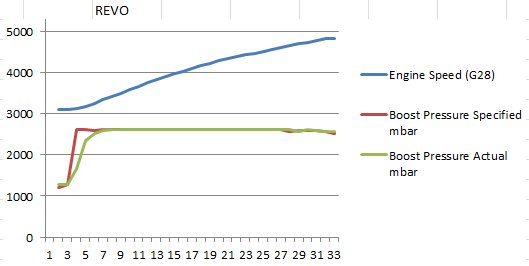

I went out earlier this afternoon to do some temperature logging in my Revo stage 1 CR170
Highest pre-turbo exhaust temperature reading I got was 876.
That wasn’t working it hard for a long time though. Just a gentle warm up followed by a couple of acceleration runs. If you were working the engine hard for longer then 930 might not be excessive.
Highest temperature I got on the back side of the turbo going in to the DPF was 504.
