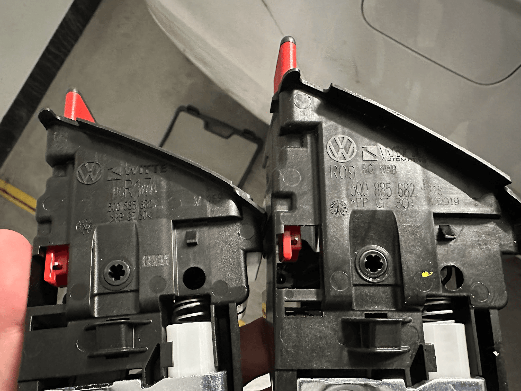

I've found the source of the clicking sound. I noticed it was only making the noise when a rear right backrest was in the top position. Finally I replaced a backrest release mechanism from 5Q0885682J to 5Q0885682M and now I'm enjoying the silence :)
