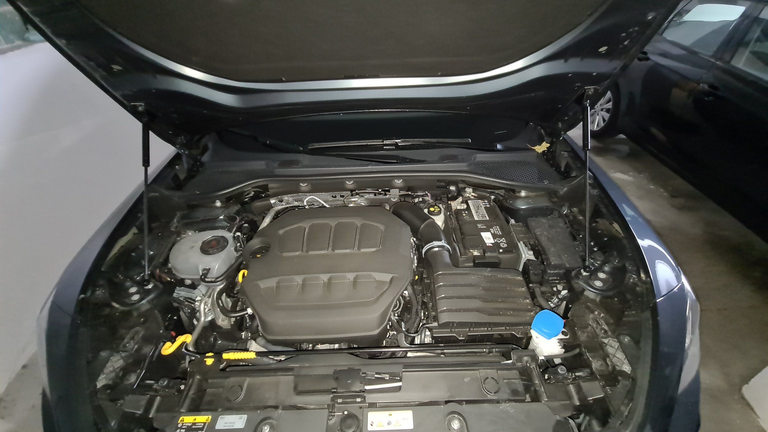

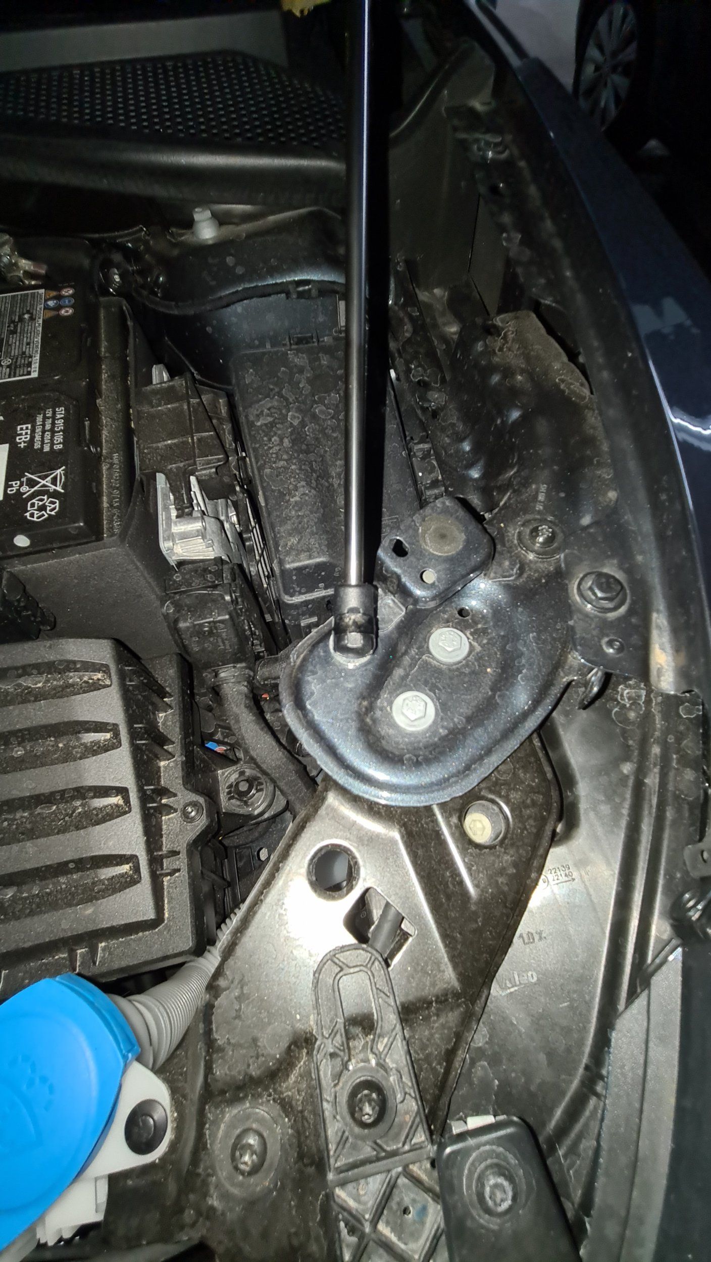

As promised, a few pictures. Sorry, lighting wasn't brilliant as it was in the underground car park.

Knowing my luck I would forget to take them off at the end if the lease and get charged for it
I spoke to VW financial services and they said no problems, as it's a reversible addition, not a change or modification to the vehicle or anything that increases wear on components etc.
